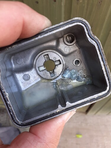

I know, I know. I’ve been told plenty of times but, as my old headmaster used to say, some people just need to learn the hard way.
I tried to start the bike yesterday but it didn’t want to play. I suspected the fuel was tired as I hadn’t ridden the bike for months, so I decided to replace the old stuff with some shiny new petrol. When I removed the float bowls I thought I might see some water, but I was not expecting the horrible grey sludge that greeted me. One pair of floats had also sprung a leak and now has petrol inside. ( if float doesn’t float anymore does that make it a “sink” ? ).
Great photo and glad it’s sorted.
Good job you caught it. Have seen some horrible and very hard to remove residue from more modern fuels.

I’ve had MUCH worse than that! I ended up draining the carbs every time after using the bike if it was going to sit for up to a week or more. A doddle on the R80, float “bowls” are held on with quick-release spring clips and are hanging out in the open air (flat twin) so quick and easy. Guzzi needs the main jet caps unscrewing but on the left side the starter motor is in the way. A right PITA!
EDIT: what Guzzibrat said, horrible hard green or brown deposits, that carb cleaner won’t look at.
