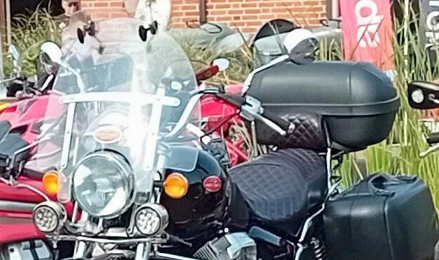

I have added a small extra LED light under the headlight on my Spada which was a cheapy thing off ebay. You can just see it under the fairing. Something like this LED DAYTIME RUNNING LIGHT DRL FORD KA FIESTA FOCUS | eBay UK

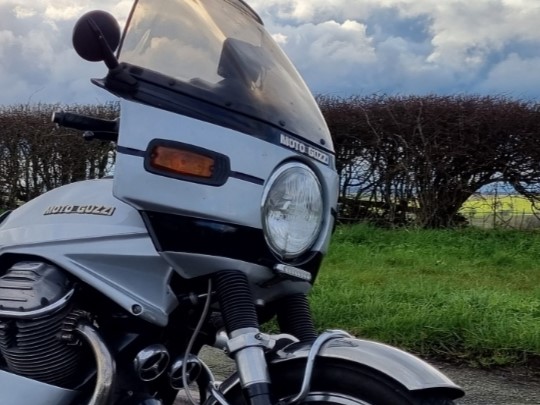

This looks like a better alternative than simply adding a pair of led driving lights. I’m looking to improve the spread of light at night, particularly when travelling abroad as part of my (UK) headlight lens will be taped over. Do you find that the led below your headlight provides a good spread of light, Don?
It doesn’t illuminate the road at all, it’s just there to make the bike more visible to car drivers, I have it linked into the pilot light so comes on when I put the lights on, I suppose I could link it to an ignition live so it comes on with the ignition. I don’t always ride with the lights on.
Ah. I am definitely looking for increased illumination.
