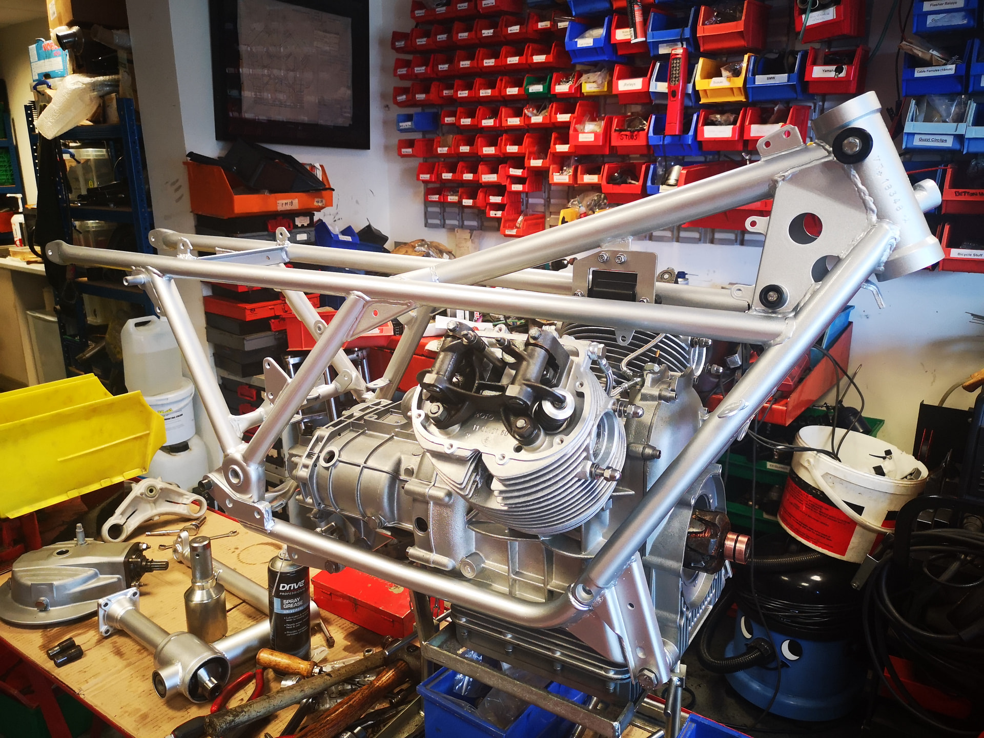

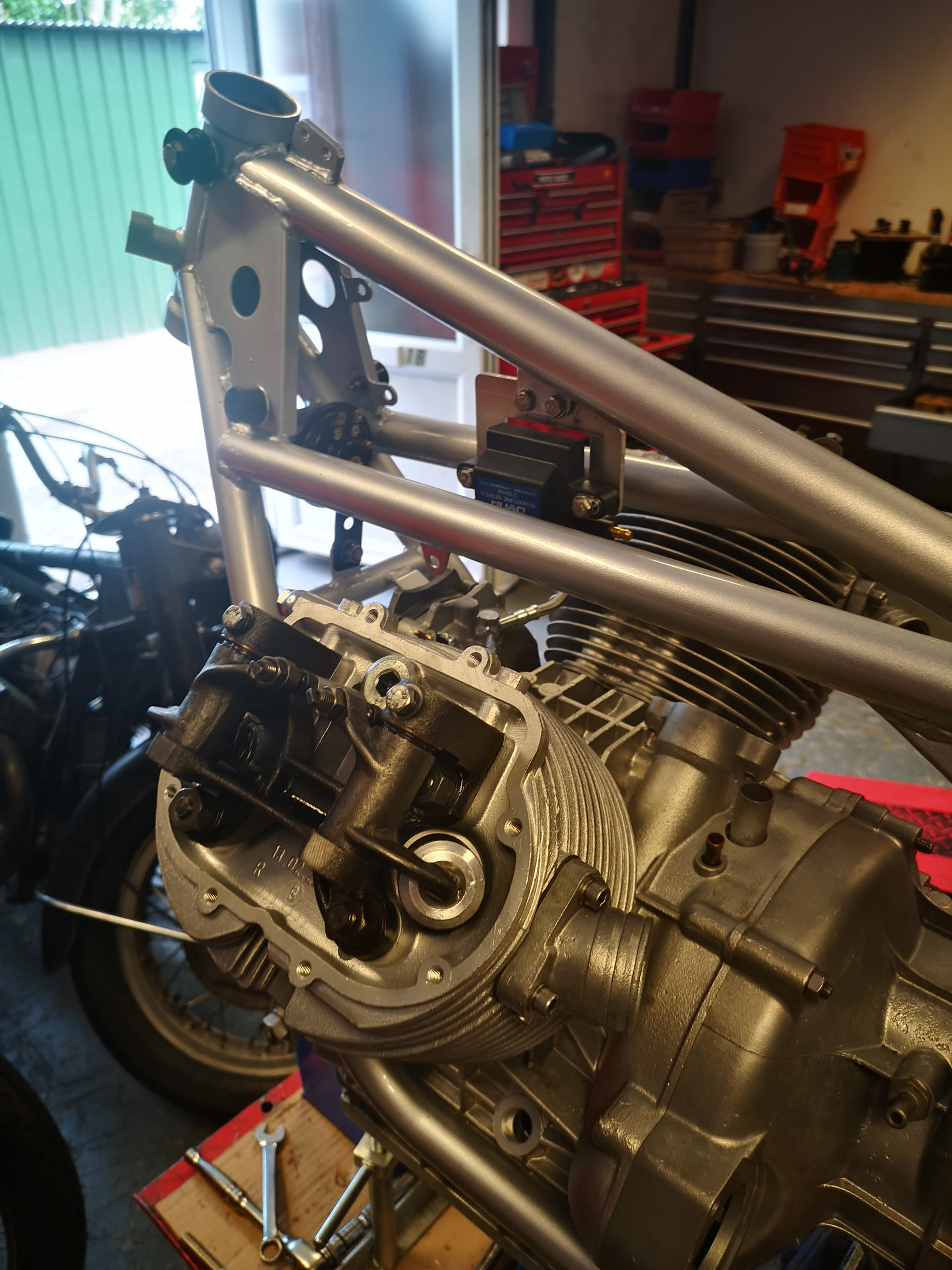

Not sure which Dyna coils you are using but this where i fitted a twin action Dyna Micro Coil with Electronik Sachse electronic Ignition system mounted over the alternator.
