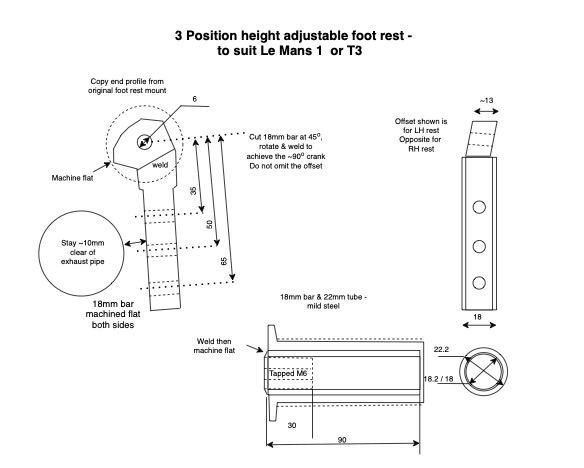

Indeed, but I simply never remembered them being so high. I have designed a lowered peg and have ordered the materials to make these. A rough drawing is attached.

Here is the final result - 3 position adjustable.
I compared the rest height with that of my Suzuki Bandit which was ~ 50 mm lower, so made this with 3 height positions to choose from.
I will keep the original rests so effectively there is the fourth original position available too.

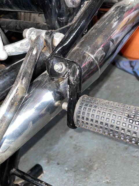

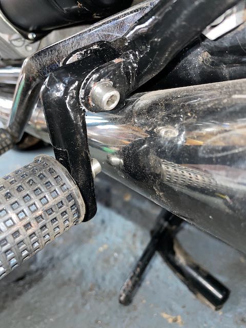

I finished the new adjustable feet mounts today. Here is the left side mounted in the centre 50mm lower position. The flip up pivot still works and I don’t think i will be leaning over far enough to cause any issues with ground fouling !
That looks like a neat job.
You may end up with a step up to the rear brake pedal, as you can’t drop it down very far or it will touch on the exhaust.
Don
Spot on - The rear brake is almost unusable so looks like I will need to make a new lever that sets the pedal end further out and down.
