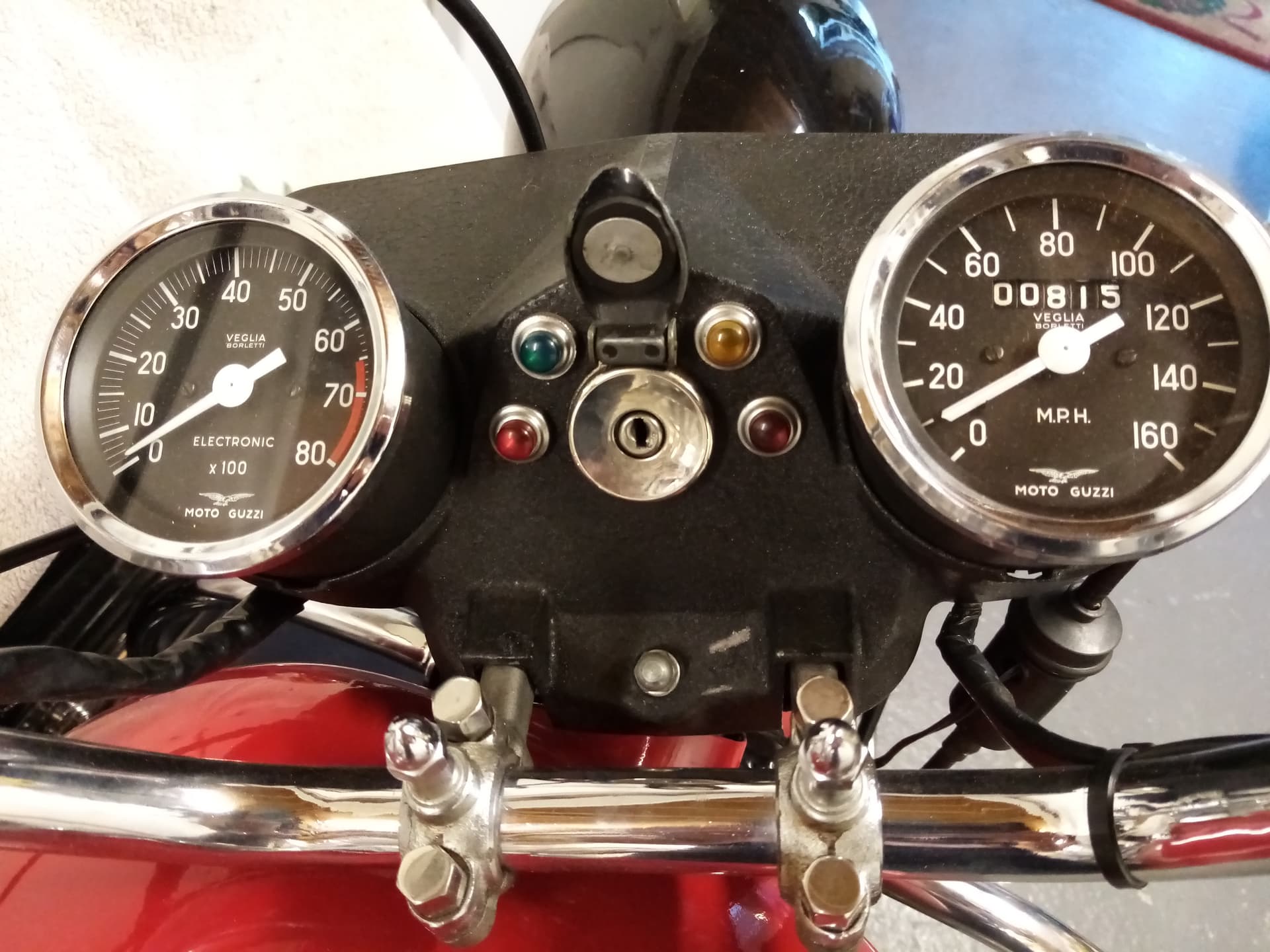

My 72 V7 is fitted with a black face electronic rev counter, with two wires that connect either side of the coil,
The system worked fine for first couple of weeks but know the needle swings around to 80 as soon as you turn on the ignition without the engine running.
There is another wire that earth’s out the case, this is fitted and tested, any ideas?

Hello Don, the tacho is pukka Veglia fitted between 72-74 it’s identical to the one fitted to my 74 850GT

I have checked the wiring you can’t get that wrong Pos or Neg, that’s why I’m confused it worked for 500 miles then had a woble, is there a resistor-diode-coil that can fail inside, how do they work?
