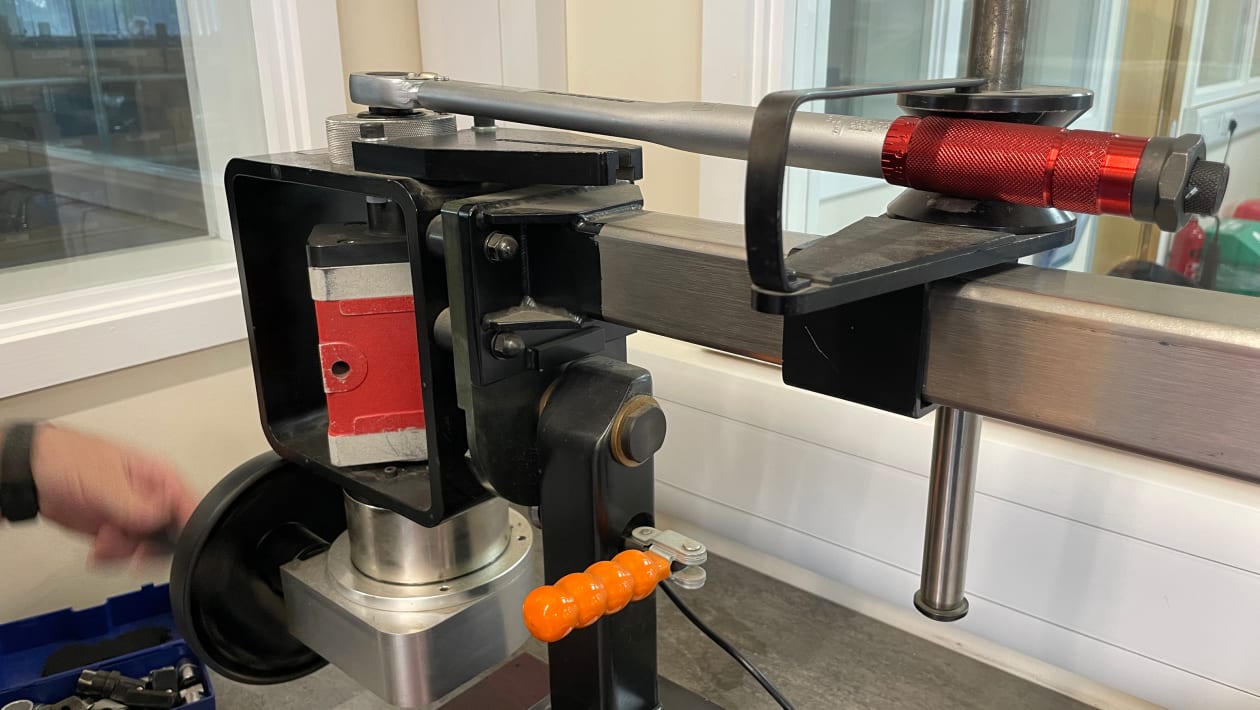

To be honest I have 2 tourque wrenches
One is from Halfords and the dial type
the other is the one with the protractor type thing and is I find easier and as accurate to use and cheaper to buy
Worth looking at this test , Halfords came up best buy !!
worth looking an e-bay and Amazon
