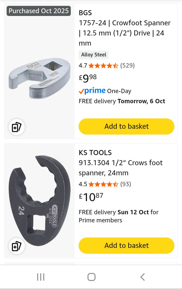

The open ended spanner certainly worked with the gear oil draining. So no need to remove the exhaust. However today I discovered the “crowfoot” spanner after looking at a video of a Japanese lad doing the bizz on his V9 gear oil so I’ve ordered one from Amazon. This will facilitate no burning hands on a hot exhaust when draining hot gear oil. Every day you learn something new….
Made me smile Larry catching your reply re the crow’s foot spanner! I am a lifelong tool junkie and the other day rifling through my tool boxes made me realise how I love those ‘one off’ specials you accumulate over time and discard at your peril?
