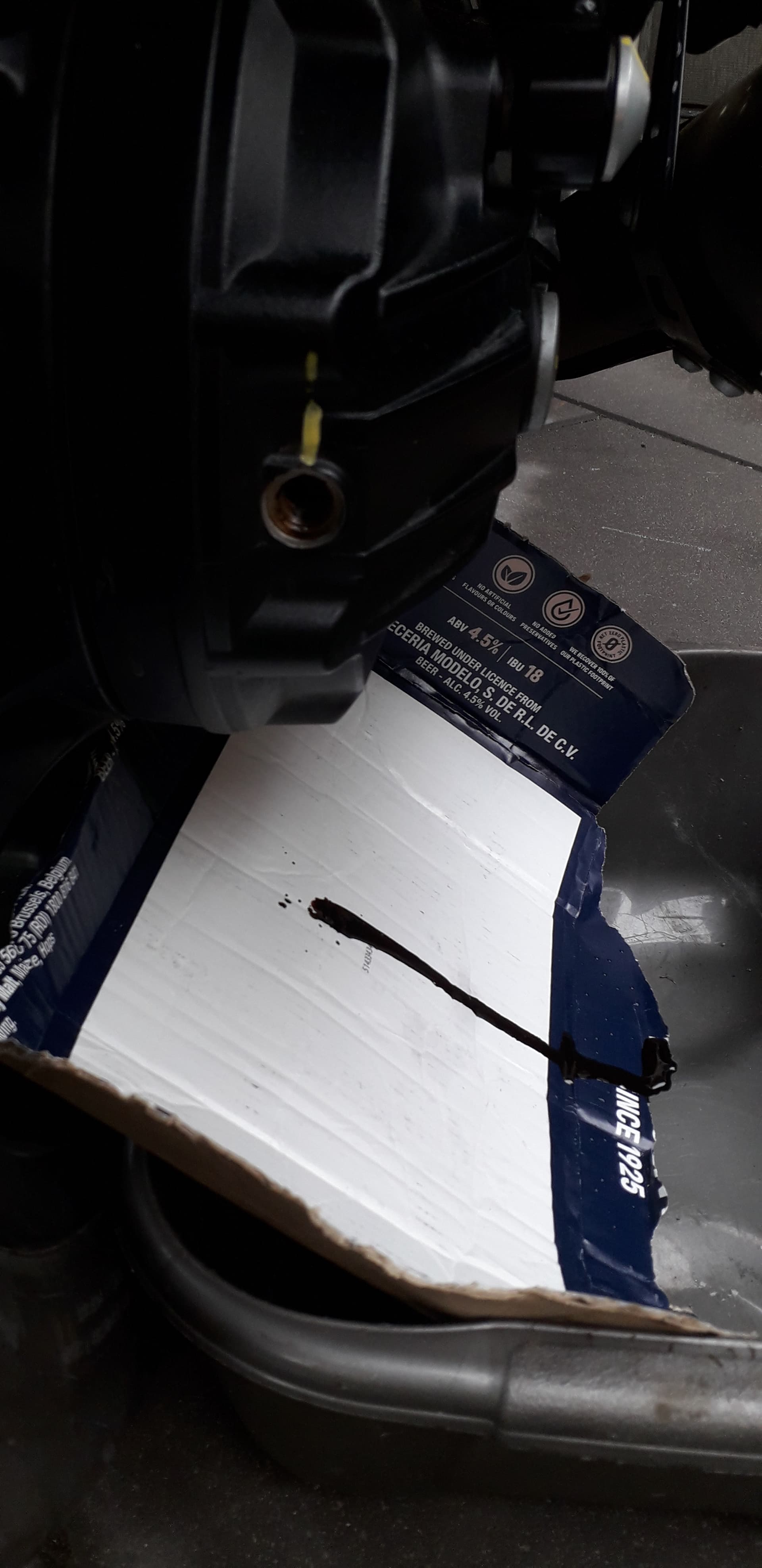

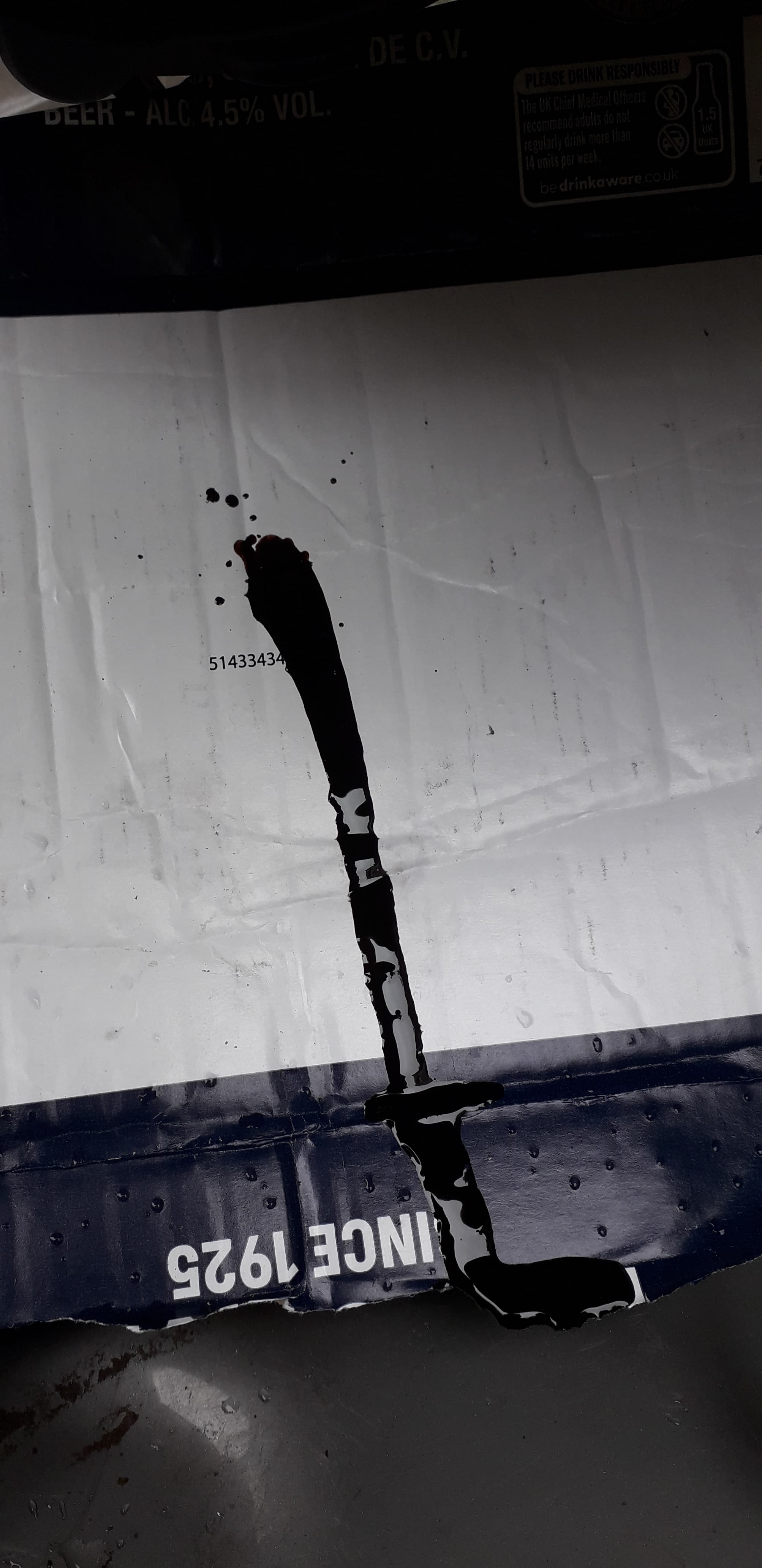

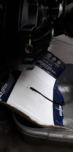

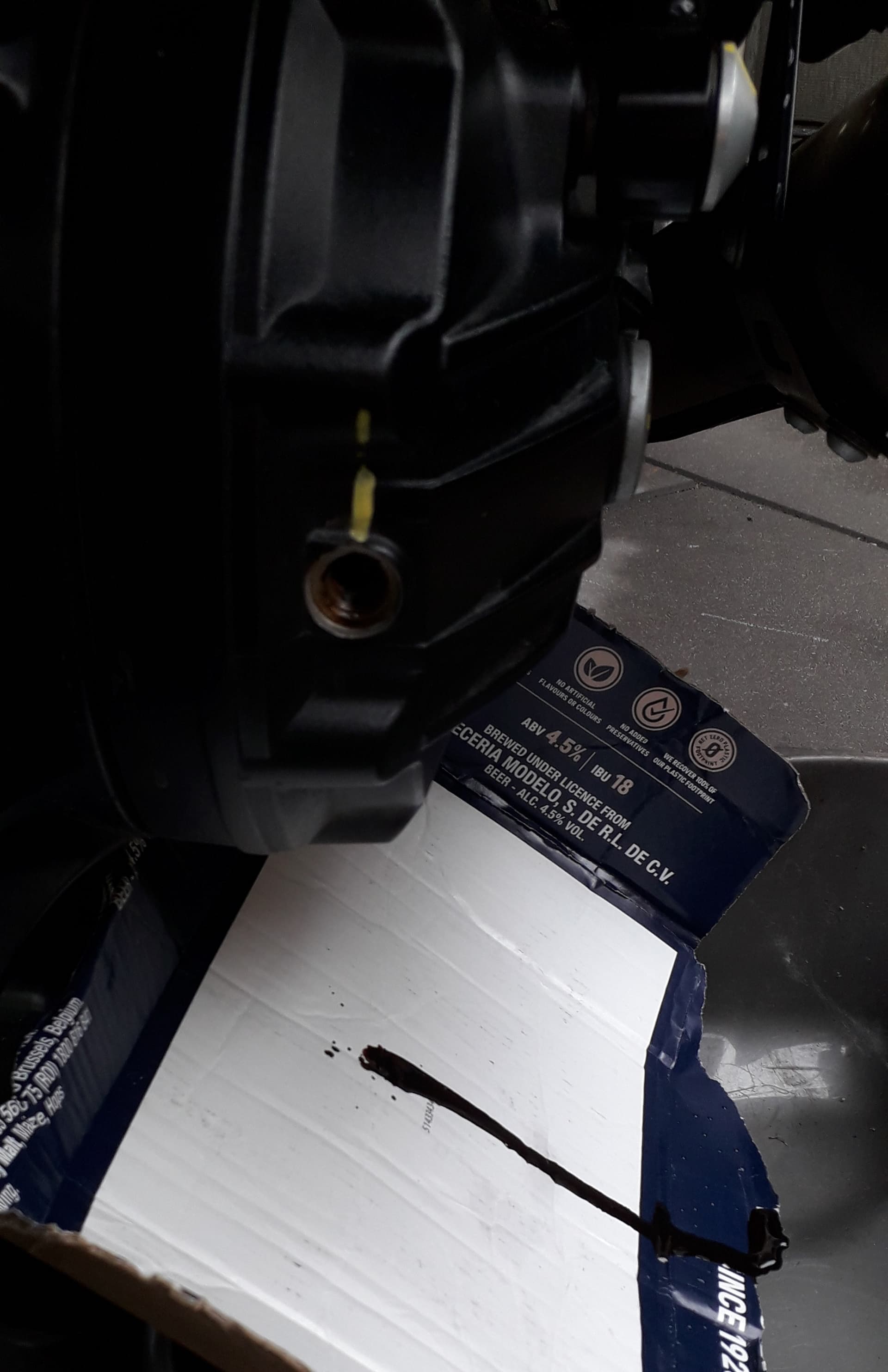

Just an update. Cracked open the FD drain/filler plugs having been on a short 50 mile ride so the drive was hot. To my astonishment rather than a gush of oil a mere drizzle came out. Blackish and thick with a paste like small residue on the drain plug. No sign of any metal bits though. It’s as if it has been running on the initial assembly build and Mr Guzzi forgot to put the oil in it…It should have 180cc of oil according to the manual.
On the plus side how resilient is this bike…but glad it was spotted in time :rofl:

I’m only speaking from my experience of V85’s, but it was recommended by the factory to refill with 160cc rather than the 180cc stated in the manual. This may be the same for V7’s.

Yes as you say, after checking the manual it states 180cc. However I am aware that normally a bit of oil always remains inside so a trick would always be to collect it in a clear plastic beaker and using a 2nd beaker fill up to the same level and pop that in. In any case you only fill until it starts to come out of level plug. But cheers and thank you for your interest.
Yes I am thinking the same thing as well. As it should be changed at 18,000 miles I will whip off the filler plug, shine a light inside so hopefully judge the level and take it from there. The joys of a Moto Guzzi :rofl:. By the way the engine oil is okay and due replacing come the Autumn.
i think dealers were initially putting in 180 and it caused problems with gear oil seeping out when hot and guzzi revised this to 160. i know my v85 always had 160 put in at services.
The manual specifies 180cc at initial assembly but as it also advised that due to the difficulty in ensuring ALL the oil is drained subsequently, they recommend 160cc (though I think it was something like 163cc or something odd from memory?) for refilling. Be VERY careful not to overfill as you may blow the seals due to increased pressure.
Once filled to that level a trickle through the filler plug is all you’ll get in my experience. I too changed the final drive and gearbox oil myself once out of warranty and there was a shiny silver sheen to the gearbox oil, so I’m glad I didn’t wait till the 18k interval or whatever it is.

If t’s like mine (2021 V7 850 Special) the FD filler is also the level plug so it’s impossible to overfill it. If you haven’t quite drained out the last 10 - 20cc, so what. Refill will be to the bottom of the filler hole (then it trickles out) so it can’t be wrong.
