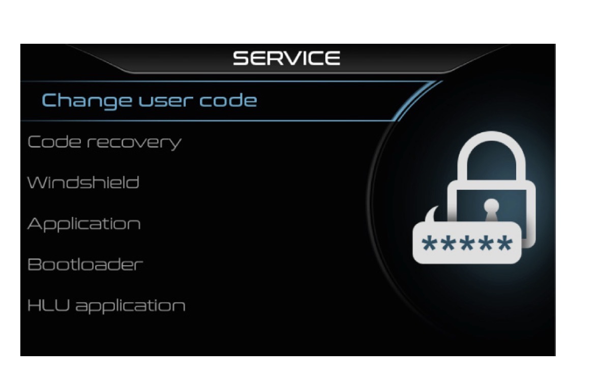

The software versions are shown on this screen - get to it by a long press on the right navigation button (of the four on the left switch cluster). Then press down arrow to go to the Service screen.
My Software is 206, Bootloader is 101 and HLU Software is 7
