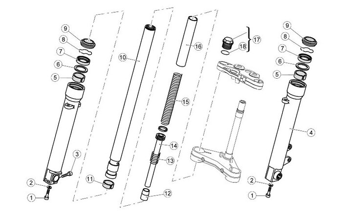

Just to nip in the bud any misunderstandings, the new E5 V7 850 (>=2021) forks do NOT have internal damper cartridges. Instead they are ā€˜normal’ configuration, with damper pistons working with a renewable fork oil of a specific weight, as per every other bike. (Almost.)
According to the manual dismantling looks complicated. I’ve seen videos of Ducati and Japanese forks rebuilds and it’s like that. For example to drain the oil, the manual starts off with ā€œRemove the stanchionsā€, because you have to turn them upside down to pour it out of the top, and pump the piston to get it all out. Another issue could be compressing the springs on reassembly. The instructions go on for quite a few pages.
