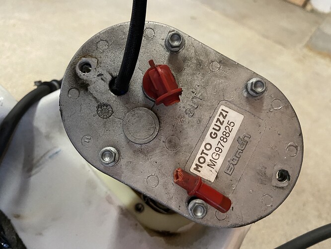

Fuel connector on 1200Sport8v
I broke the little red right angled tank connector whilst trying to fit a new oil pressure sensor. Mainstream parts suppliers only stock the complete fuel pump assembly at around €900 !!! Even second hand they’re north of €200. So is it possible to replace this little part on its own with same, similar or alternative connector & union? Failed to find much help on Google as yet.
https://www.guzzitech.com/forums/threads/broken-red-elbow-fix-it-to-oem-configuration-or-just-fix-it.17070/

I had to destroy the Connector on my Stelvio to get it off the first time I did it.
One of the Locking Tabs was damaged previously, just couldn’t get it apart.
I ended up just putting a longer Hose on, semi-permanently fitted.
It was long enough to lift the Tank and move it out of the way, without disconnecting.
I’ve since fitted a QD Connector, but left the overall length of Hose the same.

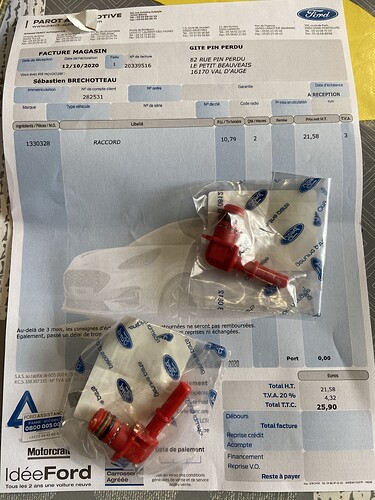

Just to let you guys know, I picked these up from my local Ford dealer. Easy to fit :smiley: €25 for the two
I understood that it was difficult to remove the original elbow. How did you do it? Does the new one seal OK?
That is very useful to know
