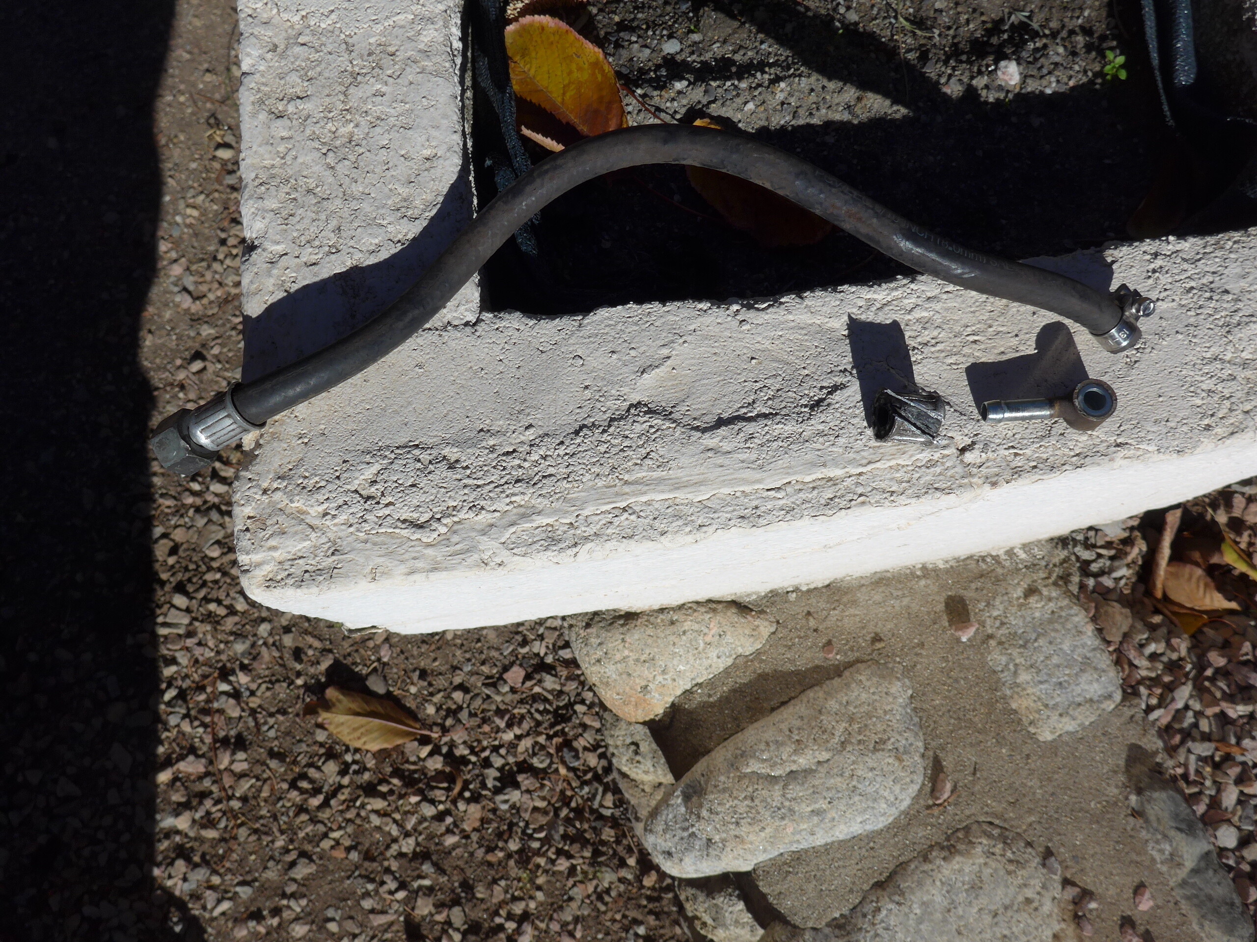

For all currently available regulators one must modify the fuel hoses. The Weber unit has a ‘Pressure In’, a ‘Pressure Out’, and a ‘Return’ connection (one with a banjo bolt). It is quite easy to take that off the hose, and just use it with a Jubilee Clip instead (see pic). The new regulators only have ‘Pressure’, and ‘Return’. A brass ‘T’-piece between the ‘Pressure In’ and ‘Pressure Out’ hoses gives the Pressure supply to the new regulator.

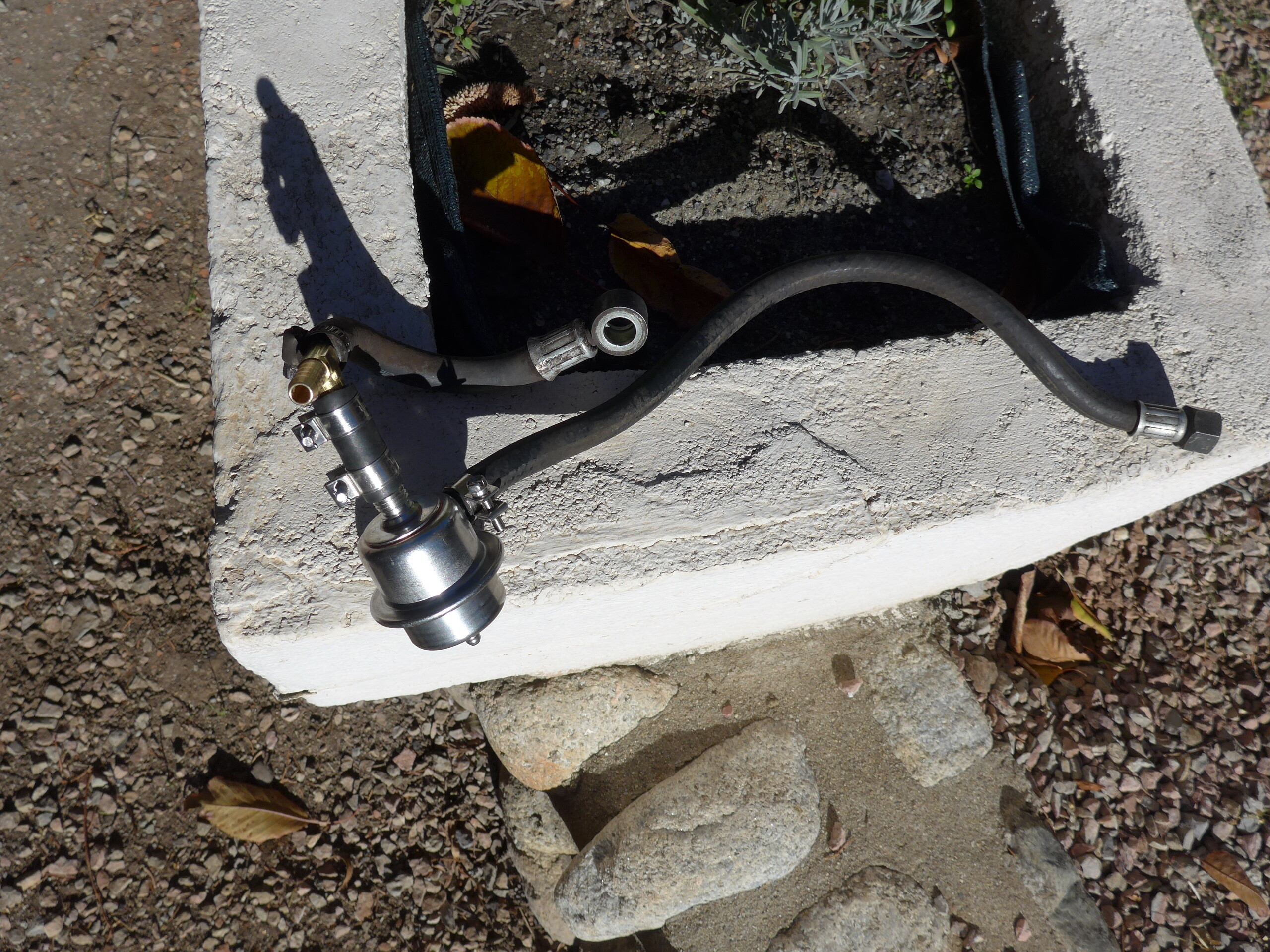

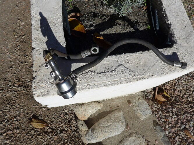

NOTE: The fuel hose pics show the first (wrong) replacement regulator!
