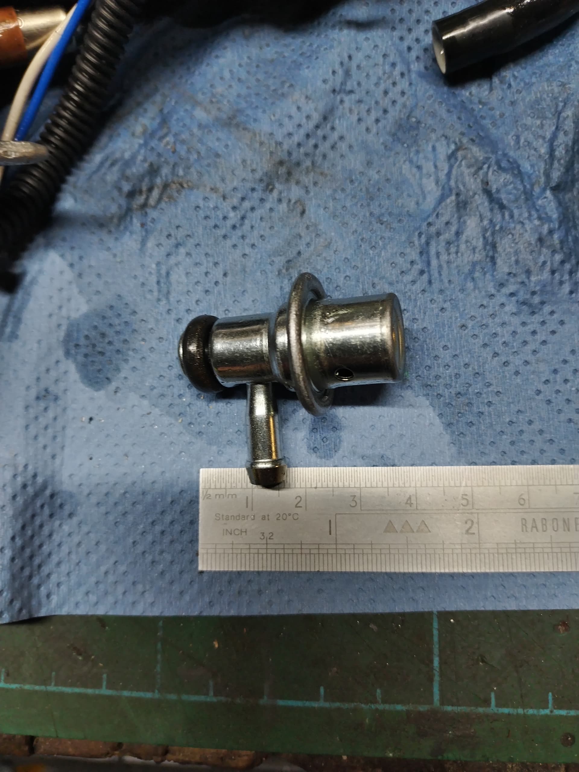

I am hoping someone already has the part number of the “in tank” fuel pressure regulator that is fitted on the 1200 8V bikes?
It will save me having to remove the fuel pump assembly!
If not does anyone know of an alternative pressure regulator?

This item isn’t listed separately - its a complete fuel pump assembly
same on parts list too
thanks though.
If this listing is the correct item, then it is a Magneti Minarelli RPM40 3 bar pressure regulator and is quite common to many cars Or are these for external units?
You may be best checking with someone like Gutsibits, NBS or Baldrick to see what they have to say.
Thanks for the info - I’ll do some digging around
It looks like this, the markings aren’t much help
Cleaned in ultrasonic cleaner and a load of muck came out. So they do get dirty!
Probably best to call someone like Baldrick to see if he can confirm what alternative unit would fit.
