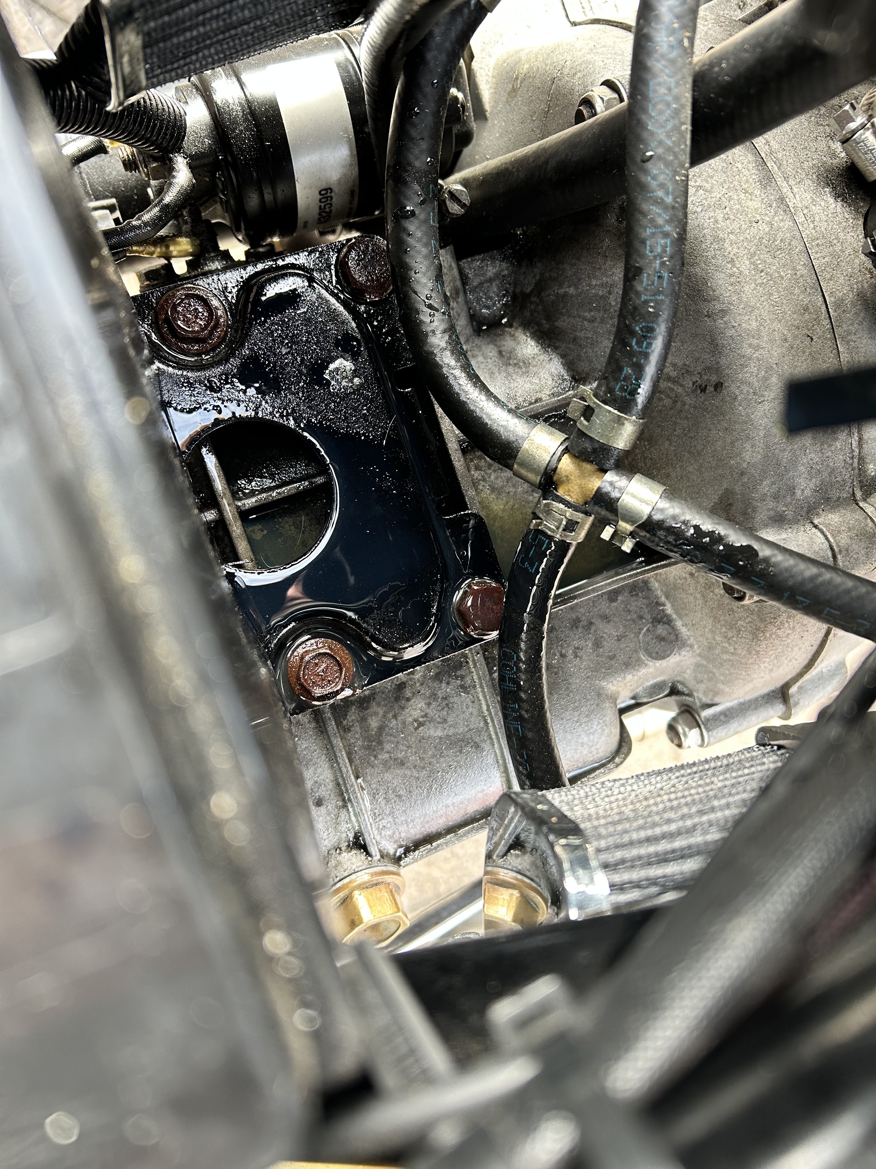

So, I had an issue with an oil leak which I posted on here and got some great help and advice; here I am again with a further request for help with my 850 T3.
Noticed the recurring leak after fitting new oil lines, and it occurred to me that the oil was clear, not black as per combustion products mixed in the crankcase.
Realised it must be from the gear box, so took her for another run and sure enough, got the oil leak; I noticed the oil was collecting on top of the gearbox. Took these photos to help see what was going on and that throws up an immediate question: is there something missing from that hole on the black plate? If so, what is it; please forgive my ignorance here!

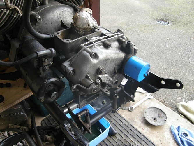

The first question to ask is have you got the gearbox breather tube in place? It comes out of the gearbox under the battery tray plate and should just extend up to the left side upper frame rail behind the side panel. It should be open at the end.
You can see it in this photo just above the starter solenoid pointing up to the sky.
Have you checked your gearbox levels to make sure it hasn’t been overfilled. It should be up to the chrome level plug on the side of the gearbox, not up to the level of the brass filler plug.

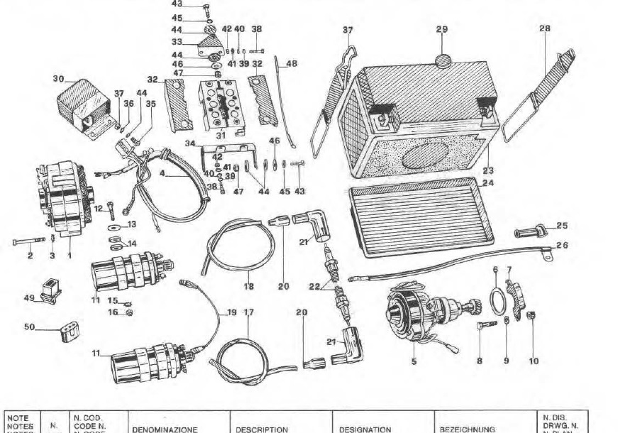

The hole is in the battery plate, it usually has a rubber mat that sits on it with locating circles that fit the holes in the plate.
Item 24
You can readily get these from most Guzzi spares emporia
Best wishes Chris

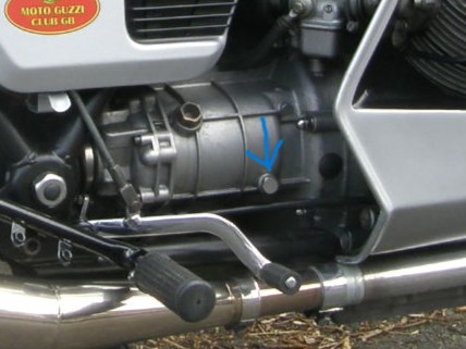

Park the bike on the centre stand on level ground and remove the bolt indicated with the blue arrow in this photo. The gearbox oil level should be just up to this level. If any flows out, then it is overfilled.
Thank you: that sound like a Sunday afternoon job!
