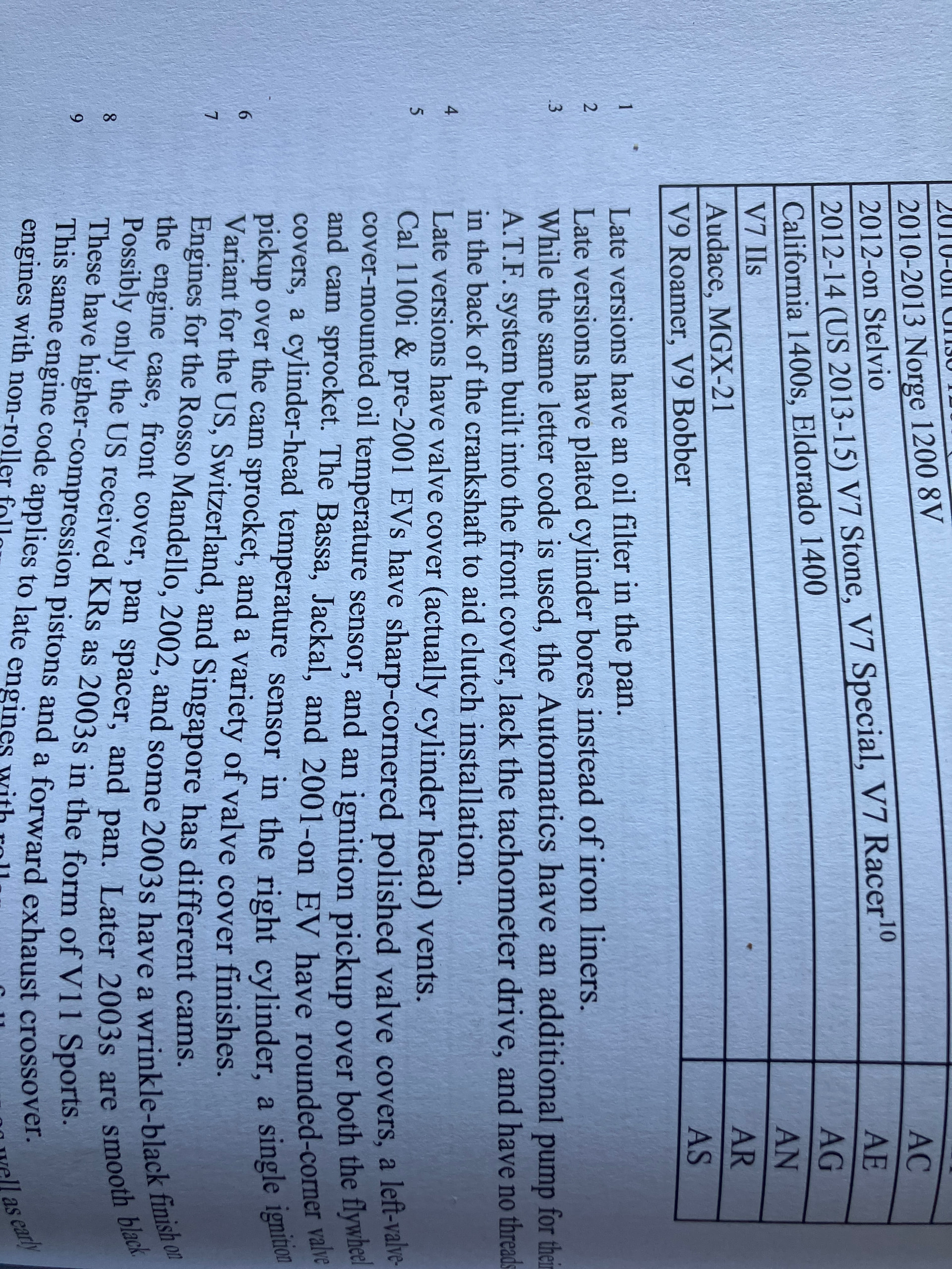

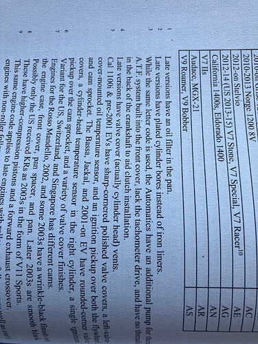

My concern is what’s written in Guzziology at point 3 here:
yet watching a Youtube video by Tiny Tim doing a refresh on his convert it clearly shows the standard 6 threaded holes in the crankshaft as per a G5 or Spada. Gutsibits reckons it should be possible with an early engine, but the only engine code/designation I can see for a Convert is VG -which is the same as my G5 so I’m wondering how to date such an engine and what the cut off point is between an early and later engine.
When changing my clutch I use a spare splined clutch centre to align the plates not the threads that Guzziology mentions.
As said above it all fitted ok 40 years ago as far as I remember.
The thread in the crank is to take the clutch alignment tool. I dont have one of these and have therefore never used the thread to fit a clutch, so I dont think its a big problem.
Ignore the notes as I used pic before to help someone else out and btw this is my cali but I believe the G5 is the same.
