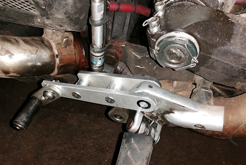

I played about with mine a few times.
Because it’s a single-sided Lever, it’s never going to be totally slop-free.
I machined a Delrin Bush initially, which improved it, but if the Bush is a close enough fit on the Bolt to stop it wobbling, then the Lever is prone to sticking.
Give it enough clearance to move freely, and it wobbles.
In the end, I modified it to be a ‘Dual-Arm’ Lever, one on each side of the Mounting Plate, which I Milled down to suit.
I had to make a different Lever anyway, as the Sensor Rod for the Quick-Shifter I was fitting wouldn’t fit to the original Lever, due to it’s length, because my Linkage is a two-part design, with a Pivot in the middle to reverse the pattern to ‘one-up ~ five-down’ (as it should be!
Pivot Pin slides into the Peg Mounting Plate and is secured with a Grub-Screw.
The two Plates of the Lever have Delrin Bushes that bear on the Pivot Pin.
It’s as slop-free as it’s possible to get without using Ball/Roller Bearings.
Nice bit of work, thanks for input
