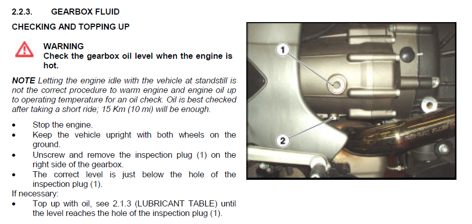

Just serviced my son’s V1200. Manual says 500cc gear oil. Actually takes nearer 750 to the level plug (bike upright). Can anyone clarify?

The V1200 should logically be filled with the bike upright to the edge of the level check hole (clue is in the name). It is the difference between actual and handbook oil quantity that is bugging me.
Never noticed that. My Breva 1100 is the same. I’ve always followed the manual’s procedure:
Excellent! Many thanks for the response. Either two of us are getting it wrong, or everyone else is.
Seriously, the manual excerpt you quote makes much more sense than the “just tip in 500cc” approach.
