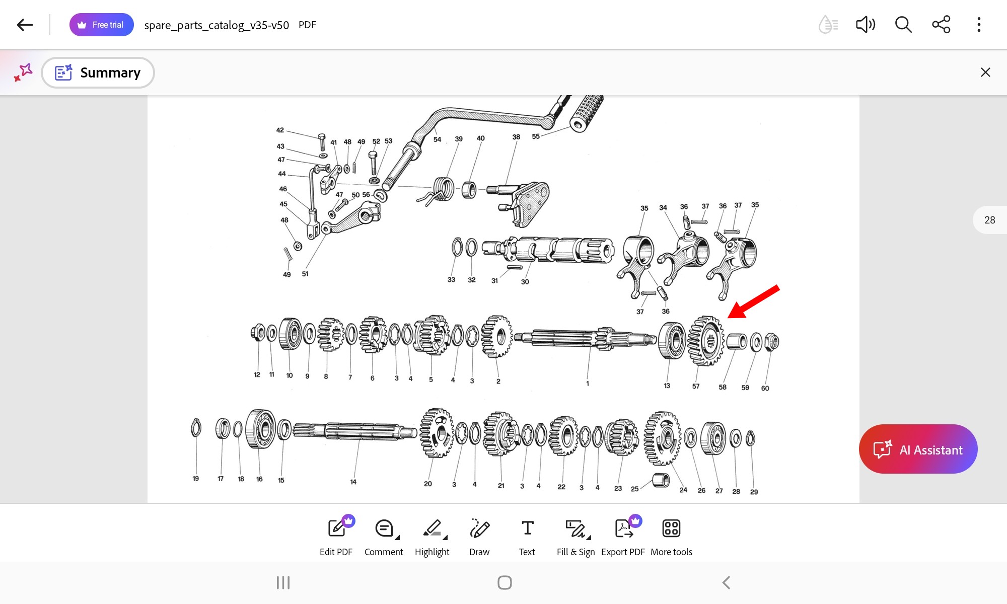

Interesting topic on gearing,I have a v65tt which I believe is low geared from factory,I would like to up the gearing so can I achieve the same resulfs,I have no intention of off roading anyway .:blush:
If you want to go really high, Nevada/Breva/Lario offer top of the range primary gearing. The models were popular, with some patience applied you’ll find such a gearbox sooner or later.
Nearly…
