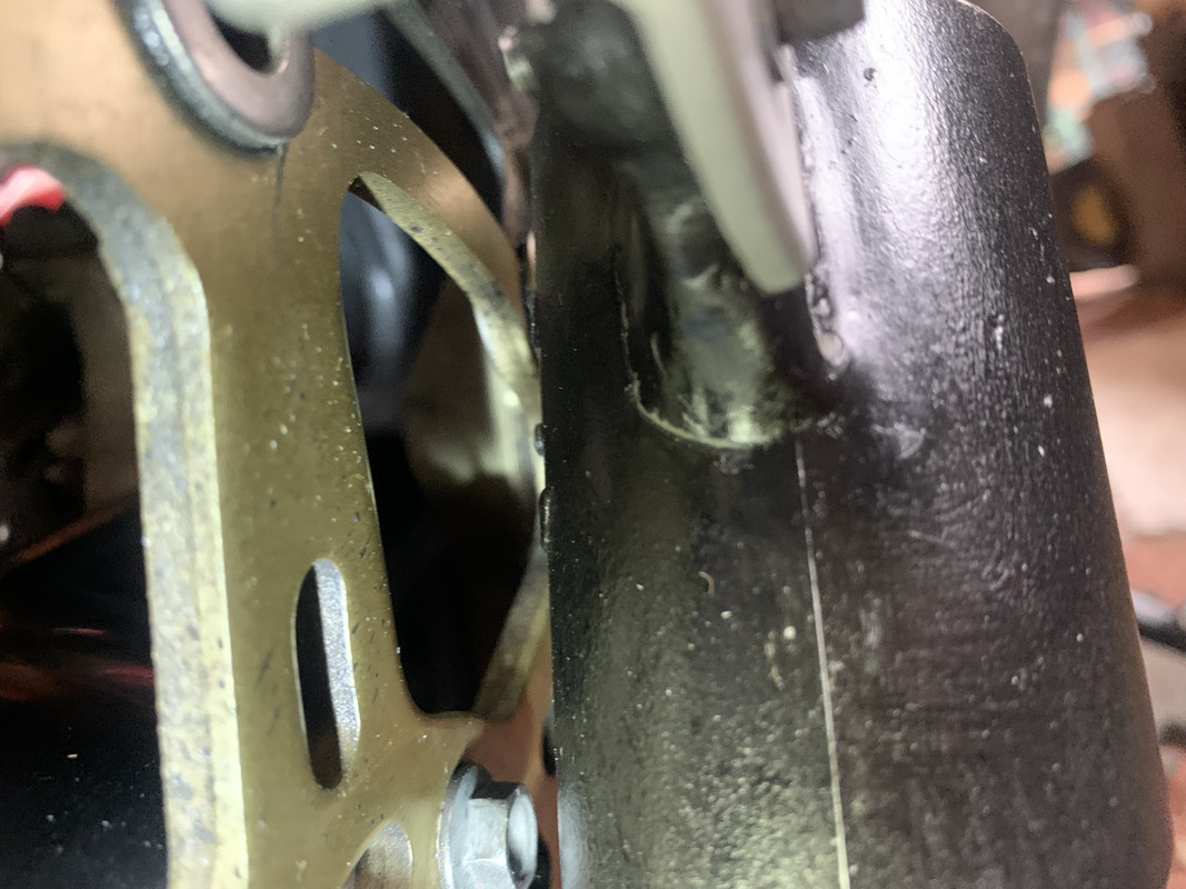

Unfortunately the fork does seem to be damaged on the mounting lug for the mudguard. It’s difficult to see on the photo but it appears to be leaking at the lug, you can just see a shiney silver line against the black paint. I’m beginning to understand why it was low mileage and sold.
I’m also wondering if an engineering firm could somehow weld it up as an alternative. I’m planning to call local firms next week.
Fingers crossed for the repair🤞
Thanks Phil.
I’m struggling to think how it could be damaged enough there to leak but not show signs of damage, so I’m wondering if it’s a manufacturing fault. I haven’t found other similar cases so maybe it was a one off.

If the damage isn’t structural take the leg out drain the oil clean it up and chemical metal the offending area, fresh oil and put it back together :+1:

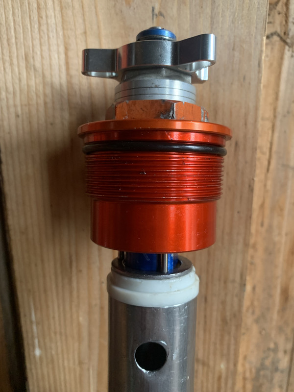

Re chemical metal; my worry is that as it’s a lug that appears to be cracked, that it is structural and would need welding to prevent it spreading further in the long term. The left fork looks to have been stripped sometime in the past as the orange paint on the fork top is marked. Maybe a previous owner tried something similar and sold the bike on? I know virtually nothing about the bike’s history unfortunately.

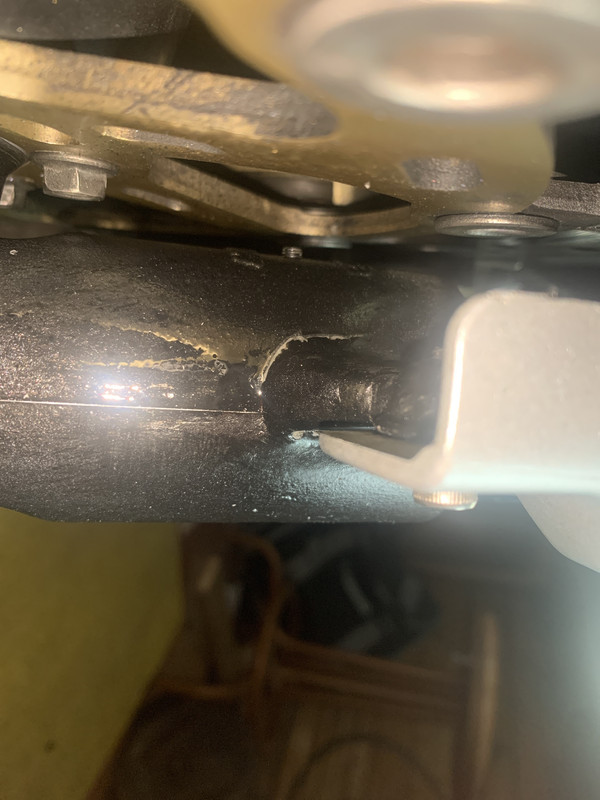

A better photo of the leaking lug.
I’ve spoken to Jake Robbins at Vintage Engineering, who was very helpful. He thinks around £150 to clean and weld.
I also found a secondhand fork on eBay for £160 and I’m in a quandary as to which is preferable.

Did you have to buy the special tool to compress the spring? I had a tentative try using a spanner but wasn’t happy with the amount of contact on the spring.
Did my centauro , (now sold), recently done my 1200s, the only special tool that I needed was the seal driver.
(Loosen the Allen bolt , (don’t take it out) before you take the compression off the spring)
I used a spnner as the spring compressor👍
Thanks Phil.
I wonder if your forks were different to mine. There’s nowhere to get a spanner in. I think I’ll just get the tool. I’ve found one on eBay for £10
My forks are different, Showa on the 1200, ( the centauro had white power, different again)
