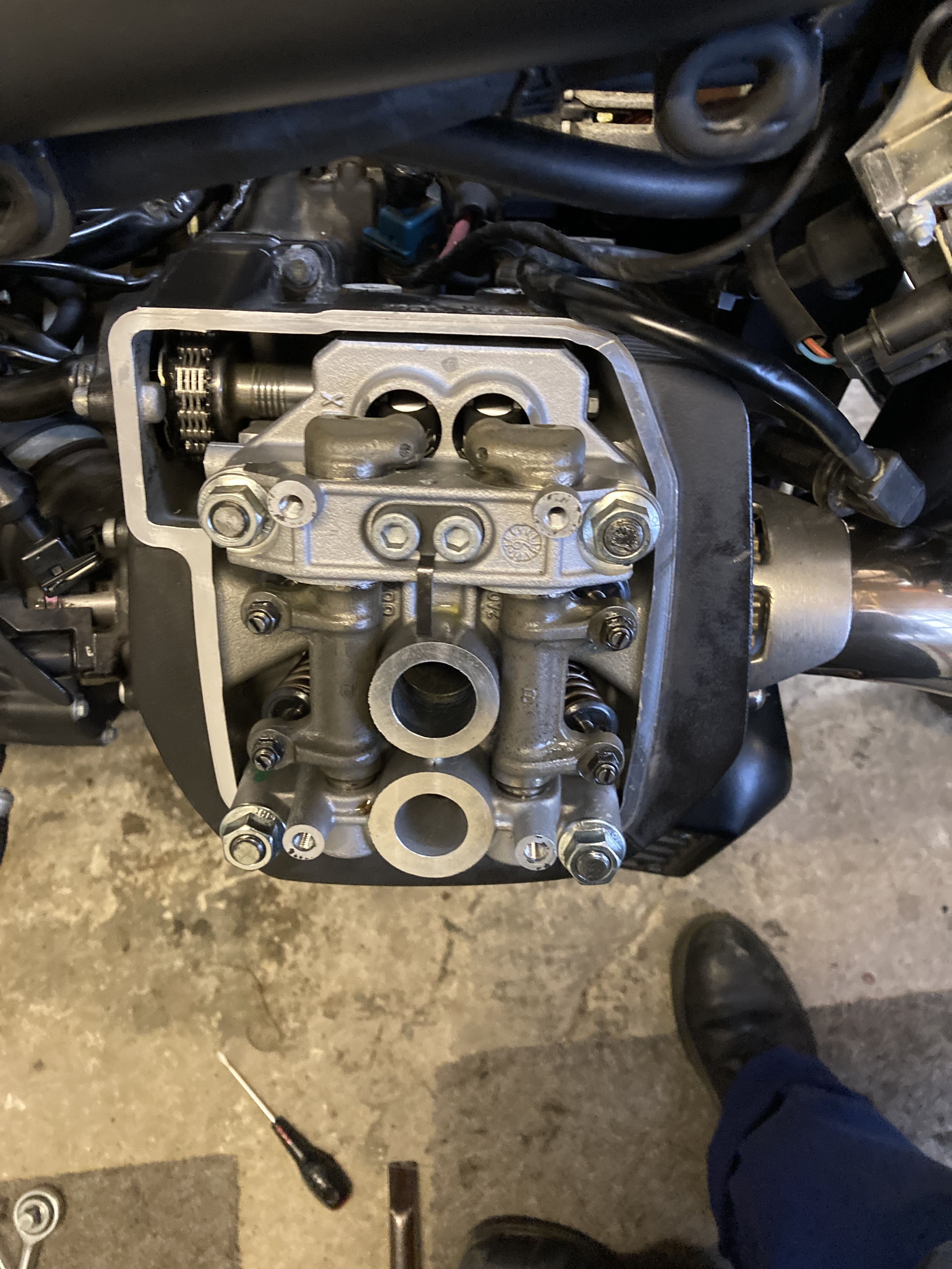

I bought a low mileage (14K) 1200 GT 8v Norge a little while ago, I am going through it with a fine tooth comb over the winter, as I found a few dubious repairs when I first got it. I currently have the tappet covers off for Cerakoting, and although told by previous owner that the roller conversion has been done, I was wondering if you can tell without stripping it down, or are there certain later models that were ok? Mine is a 2014 model.

If it is genuinely a 2014 model it should not have had a roller conversion, it should have come from factory with rollers fitted, surely?
Easy to see. If you can’t figure it out by looking, by now there are thousands of photos on the web. You’ll find with a quick search.
It will look like this
Not like this
This is what I have Gerard with the spring clip as well, thank you.
I looked for hours before asking mate, they all look the same unless you know what to look for. If it was a v twin Aprilia I know them like the back of my hand, but these are new to me and best to ask those whom know best egh?
No worries :+1: Glad you’ve got a rollerised one.

Thank you, I have the valve covers off and I can see it has been rollerised. Thank you.
