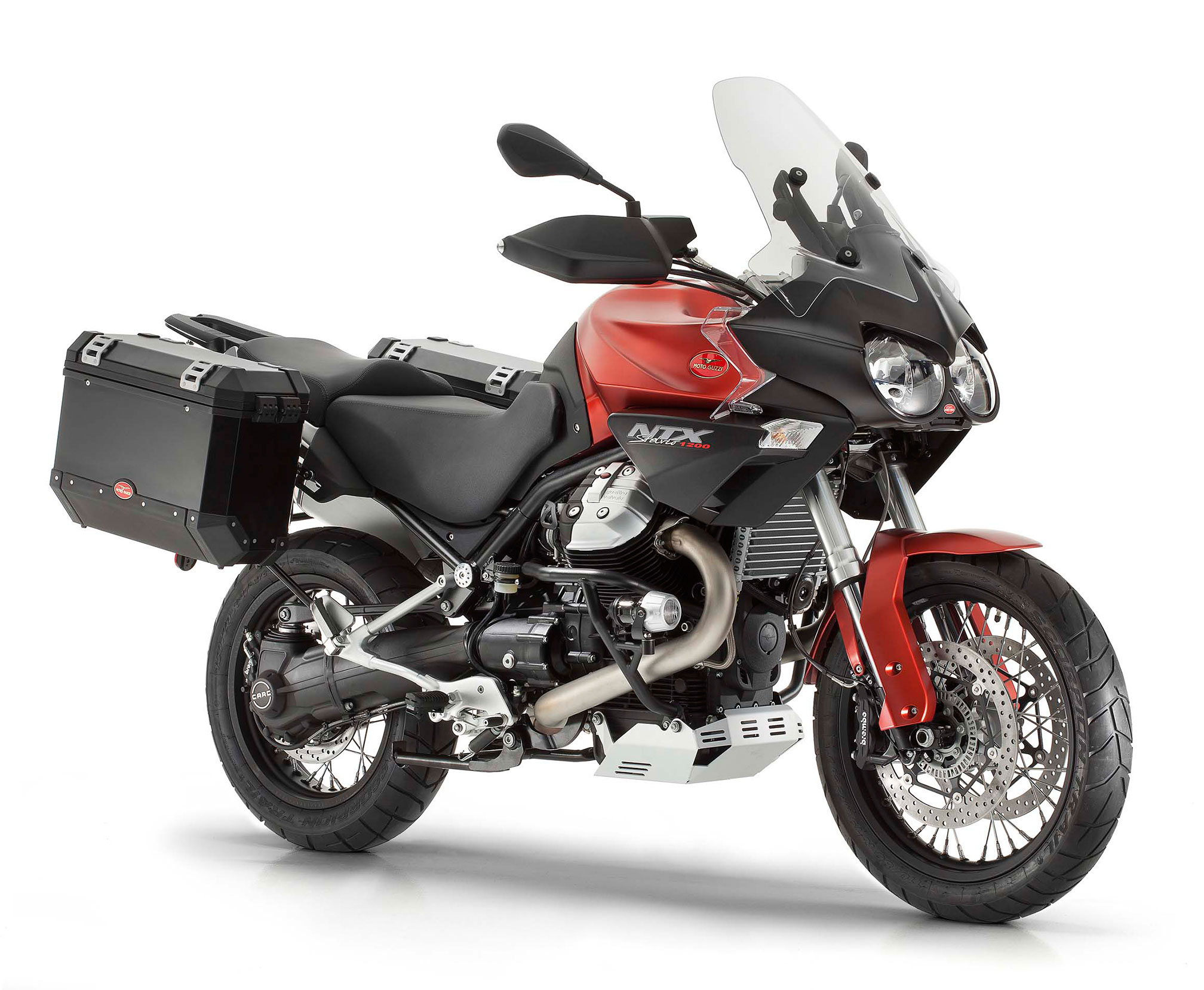

Don’t think it’s an American term. If you look at the front wheel spindle clamps, rather than fasten centrally at the base of the fork leg there is a nub that protrudes from the base of the lower fork leg. It has two pinch bolts that go through it to clamp the front wheel spindle.
This nub is known as a ‘Rhino Horn’. The problem was/is that during tyre changing on refitting the front wheel many fitters over tightened the spindle clamps beyond the recommended 20nm. This could and often did result in the ‘Rhino Horn’ cracking along the line of the clamp bolt holes.
This shows it I think - B-I-G picture hence a link not img:
https://www.totalmotorcycle.com/wp-content/uploads/2016/12/2016-Moto-Guzzi-Stelvio-1200-NTX-ABS3.jpg
This is the fork stub with the wheel clamp if you could not spot it on the big picture, apparently called a rhino horn. Ignore the plastic cover that is part of the mud guard. It is a tad thin around the front wheel spindle mind…
