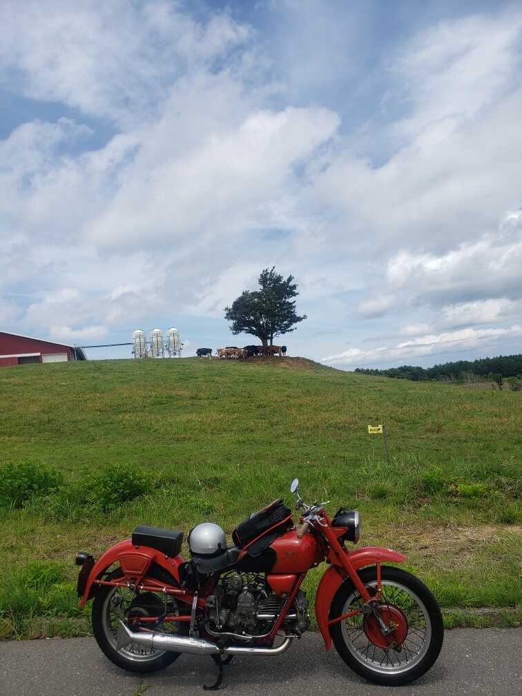

I love MotoGuzzi falcone sport in Japan and I am a Falcone loving owner.
In the first, I apologize for the sudden inquiry.
Right now my Falcone is having trouble with the carburetor.
If the fuel is released, the carburetor float will be punctured and the petrol will leak.

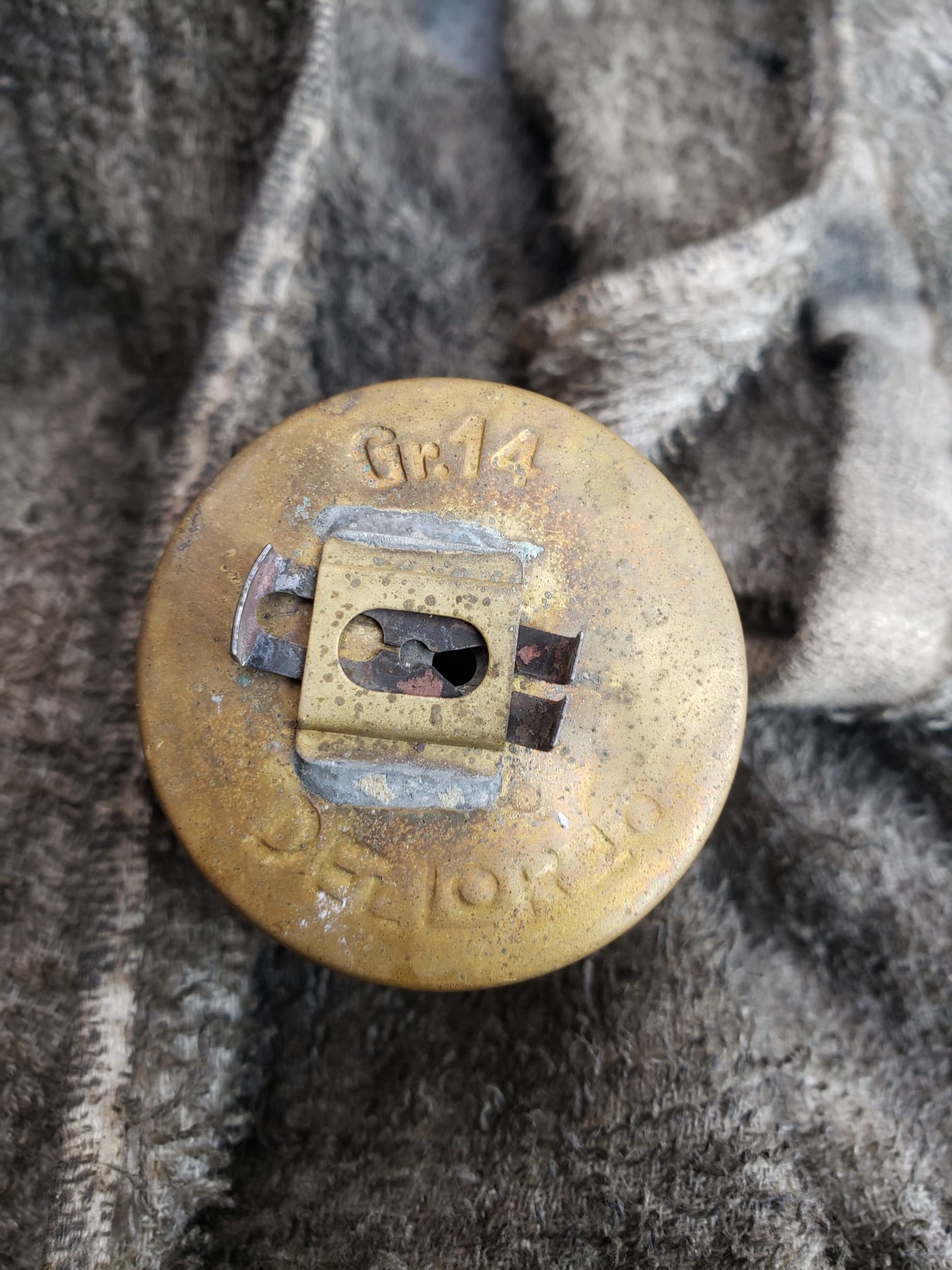

My Falvone has a Dellorto carburettor with a brass carburettor float stamped “Gr14”, but it has a hole in it so the float doesn’t work.
“Dear fellow Falcone brethren from England, could you please help me?”
Would you be willing to sell this Gr14 brass float to Far Eastern Falcone enthusiasts?

I might try to solder it to fill the hole, but that assumes other person knows how to solder.
it looks as if the hole is meant to contain something
in fact it looks more like the slide, with a clip for the needle
might be the language translation
