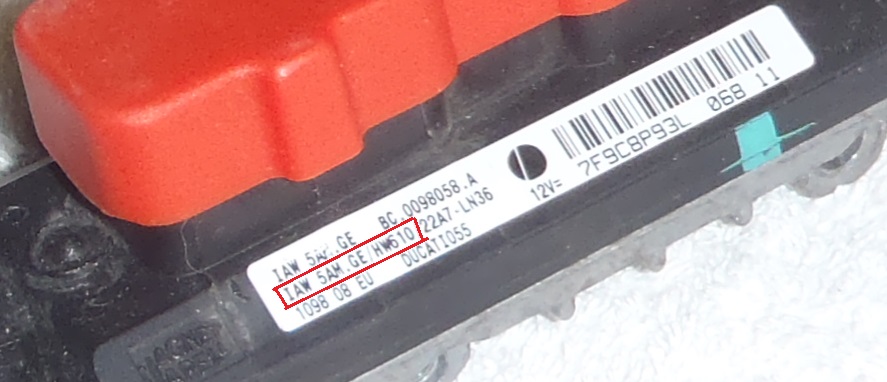

Before I download the relevant software can someone please tell me which ecu I have? 5AM or 15M and how could I have found this information myself?
2008 Norge 1200 T 2v by the way!
All the ‘CARC’ Models use the 5AM ECU, as do many Ducatis, Aprilia Mana 850, & Moto Morini 1200s, useful if you ever need a used spare.
I have one from a Ducati in my spares pile.
Full designation is 5AM HW610

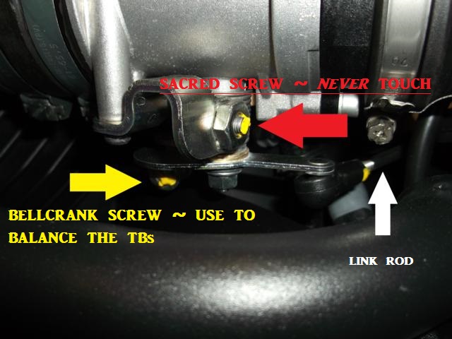

The Lonelec leads have arrived so I am just waiting on the manometer and I’ll be all set. One piece of info not included in the info I found on balancing the throttle bodies was what value to reset the TPS too once I’ve done the rebalance although I seem to recall reading somewhere 4.5 to 4.9. Can you confirm this is correct please?
You can’t choose what the TPS is set to, you just do a Reset in GuzziDiag.
This tells the ECU to use the current position of the R/H Throttle Butterfly as the Datum (Factory set at 4.7).
This is becasue the Factory set Stop Screw (the SACRED Screw, NEVER EVER touch it!) is on the left Throttle Body, but the TPS is on the right.
When you do a TB Balance, you move the position of the R/H Throttle Plate (Butterfly), in relation to the ‘Fixed’ L/H one.
If you don’t reset it after doing a TB Balance, then the ECU will be using an incorrect Datum/Baseline for the Fuelling, so it’d be off across the whole rev-range.

balancing the throttle bodies can be broken down in to about 7 steps
The idle balance screws (the brass ones) - only one should be open [if needed] - never both
Any more than 1/2 turn on throttle balance screw (on a reasonably running engine) is wrong
