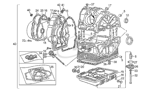

hi all 1986 v65sp there is a round hole 25/30 mm in the right hand case aft or the right hand cylinder what was/is it for and should it have a blank in it thanks

i have tried to put a photo on but no joy if you look at the photo that has been put on by iansoady if you look at the bell housing bolt above the timing hole it is above it in the case behind the cylinder not the bell housing thanks

it is a hole in the case behind the right cylinder not the hole for the timing marks and it is not in the middle and there is no thread in it and it is not for the oil pressure switch look at the case and it is under the carb inlet area .thanks
On the later big blocks there is a blanked hole where the distributor used to sit, could it be that?
Can you send the photo you have to one of us and hopefully we can put it up on here to work out what it is or you. my email address is in my profile
thanks breva-al thats the one now what is it blanked with plastic bunk or metal plug now some one must know what used to be there in the past thanks all
A parts list is always a good thing to turn to on such occasions. They are available in various places, but this one - on the Fowlersparts.co.uk site will surely show you what you need to know.
Not a 100% certain, but looks to me like Part #17 in that diag is what your photo shows - GU19017120 : “cover” NLA.
If it’s the right bit, or when you find the right bit, a bit of Googling with a combination of ‘Guzzi’ + ‘GU19017120’ (or variants of that number) might win you a goldfish.
Interestingly, my downloaded parts book (19 92 00 01) doesn’t show or list that part although otherwise the diagram is the same.

yes i think it is that part i would like to know what it is plastic or metal then i can make one but i cannot find one to look at thanks
To have a look at one, now armed with the part number, all you have to do is Google it, then select images. You can pretty much always find what you’re looking for, if you persevere, and when you recognise that a Guzzi part number might be, for example: GU19017120, 19017120, 0019017120, and so on.
