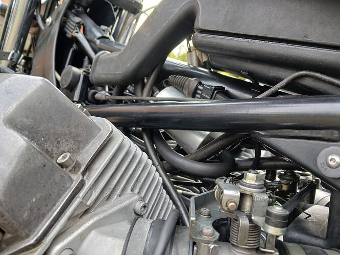

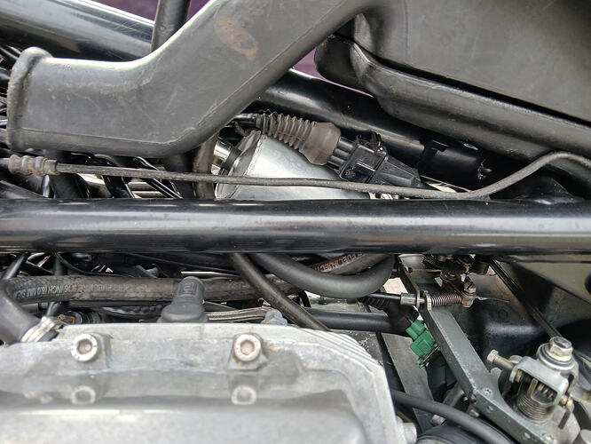

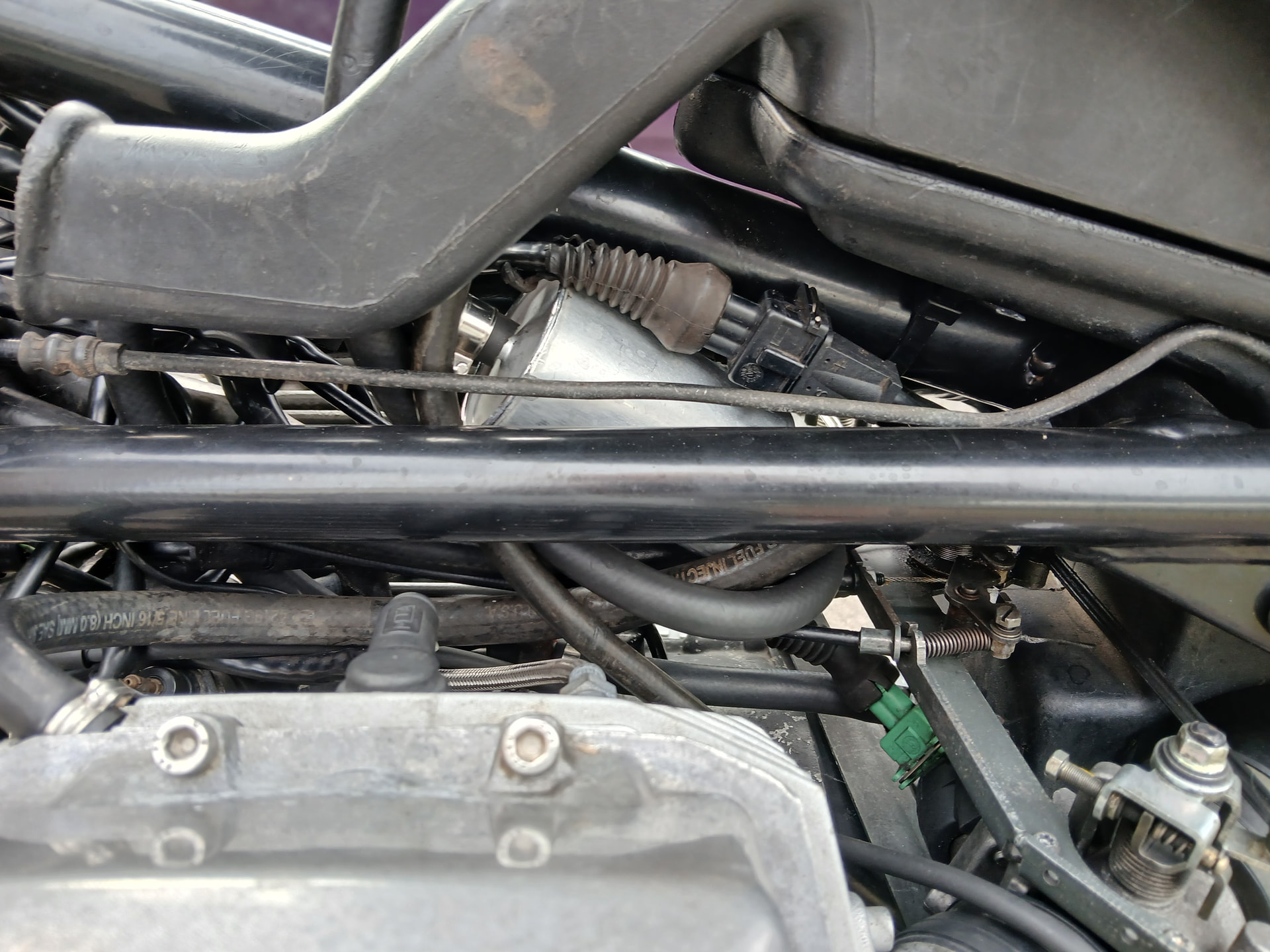

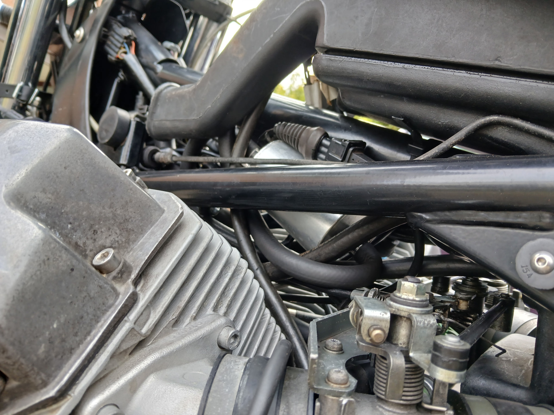

I had exactly this problem. Took delivery of the bike - the owner rode it to my house. I went down to the shops and it seemed OK, then went to ride to work. Got 3 miles from home and exact same thing happened to me. Perhaps someone had been there before and it was not factory spec? The hose between pump and filter was SAEJ30R6 - no good for modern ethanol fuel, even if external. Inside the tank it was a disaster waiting to happen. The outer rubber had gone sponge-like, so the clamps were squeezing on soft stuff, and then a slug of sludge in the tank blocked the filter and the pump must have been trying to turn the hose into a balloon!
My fix: Proper SAEJ30R10 from the (new) pump direct to the outlet spigot - eliminating the internal fuel filter. The fuel pump assembly now goes in and out of that silly little oval hole so easily, probably as per the original design, which had an external filter - which is precisely what I have done. In the process I found a mixture of R6 and R9 hoses under the tank and have replaced all the R6 with R9 and used proper crimp type clamps (and a proper crimp tool,) except for the two which connect to the new filter, still using screw type hose clips for serviceability. This replacement filter is actually a quarter of the price of the official items and probably about three times the capacity, on the shelf at Halfords, suitable for a range of various different cars.
It fits snugly between the frame tubes under the tank, having been offered up by passing it between the base of the left cylinder and frame down tube, under the injector etc. Once in place it is more or less wedged into place by all the cable looms and other hoses. It does not even need holding with cable ties or anything!
And I’ve now done 120 miles since the rebuild - big grins with a big Guzzi back in my life again after a 25 year lapse (of all bikes), so I’ll lift the tank again at the weekend and check to see that the re-used rubber gasket is holding up OK and I’ll take some photos… watch this space.
And here are the photos taken as promised, but sorry, it took a while to transfer them from my phone!
I can now also confirm that reusing the fuel pump rubber gasket in the tank has worked out fine. I even fixed the small weep where the cables exit through the rubber grommet. Loctite 5922 gasket sealant liberally spread around the inside of the grommet and more on the face of the old gasket seems to have done the trick.
With the new hoses to the new external filter I can now easily lift the tank to access everything. The two electrical connections (pump & level indicator) are much easier to use now that there is loads of room to get hands in there.
