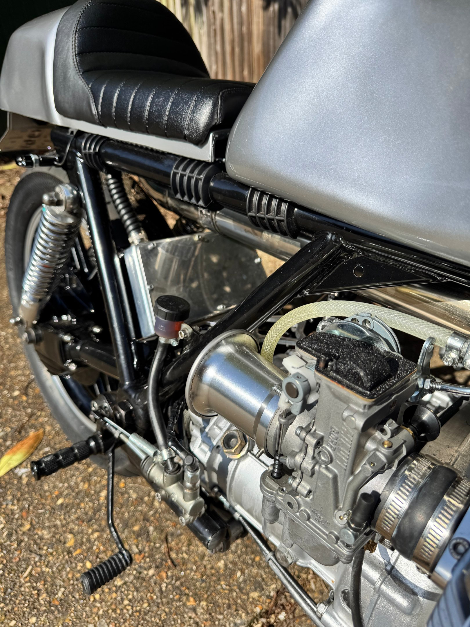

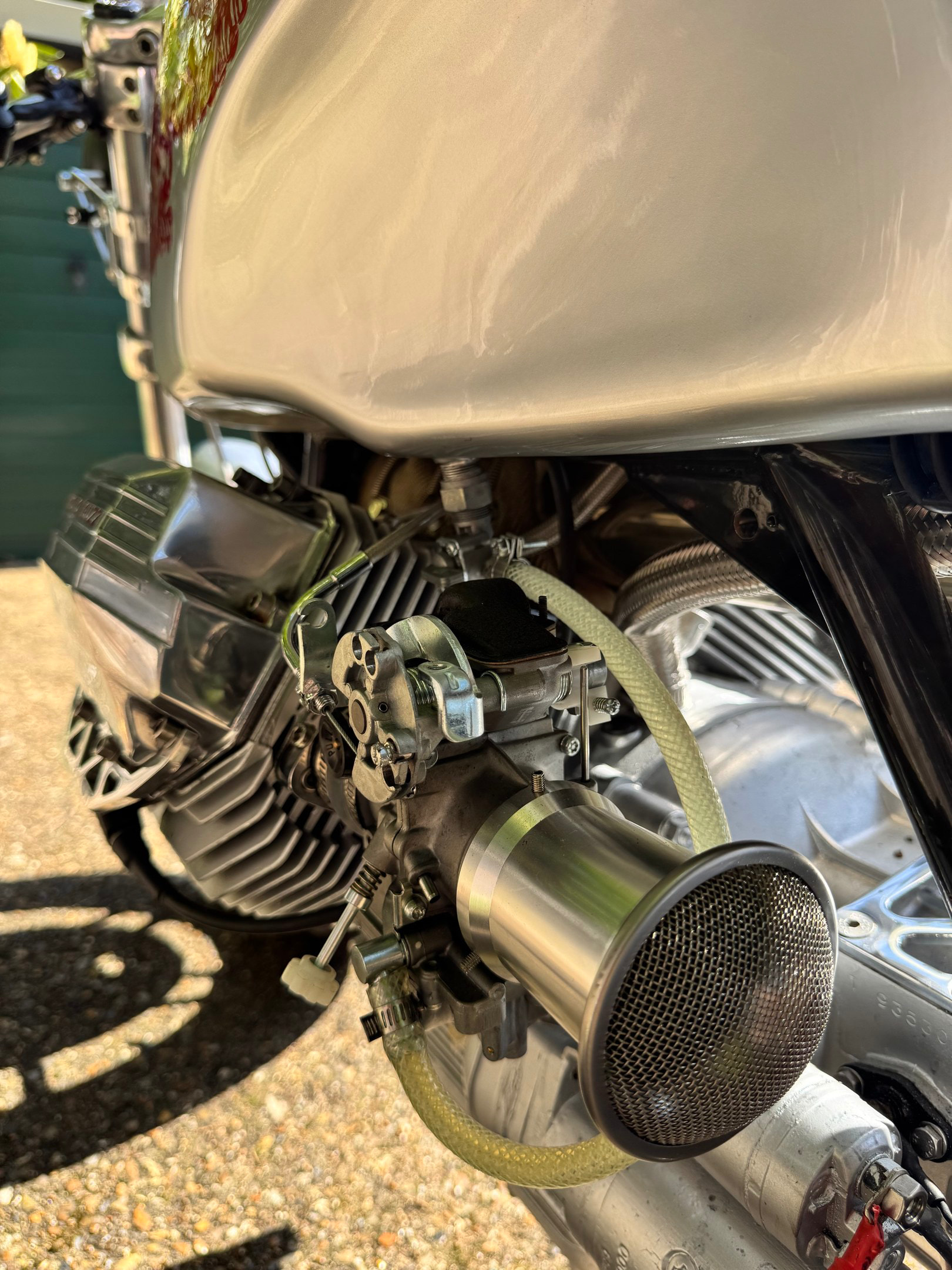

I want to run my carbs on a straight run into the intake as per these photos…anyone know where such things exist please that don’t point the carbs inboard? Thanks
I imagine that the builder has engineered their own solution there. Have you tried tracking them down to ask?
Edit. Having said that, a search on “Moto Guzzi straight inlet manifolds” immediately produced results, inlcuding: hmb-moto.de
Yes, I found HMB Moto but they don’t have them for my size of my carb so was hoping something similar was available. If not, I guess I could potentially make my own out of mild steel.

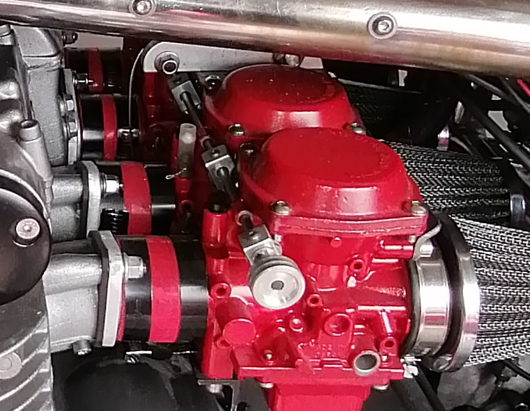

I made some a while back for a Trike I was rebuilding (for a Friend).
6mm Alloy Plate cut to shape/size, then appropriately sized Alloy Tube pressed into the hole.
Tube was almost identical in inner and outer diameter to the Carb Stubs, I only had to turn it in the Lathe a little to match.
I then attached the Carbs to the Stubs (the Alloy Tubes) with Red Silicone Radiator Hose, with an appropriate inner diameter, and the correct length to let the Carb Stubs sit right up close to the Inlet Stubs.
It all looked pretty ‘Factory’ when done.
