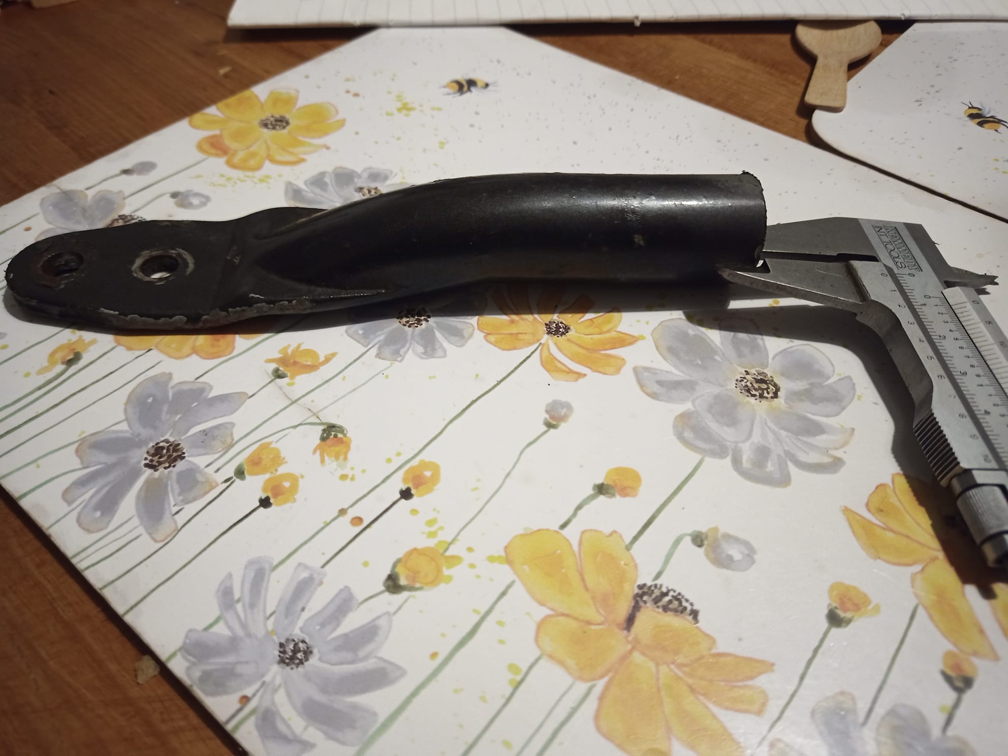

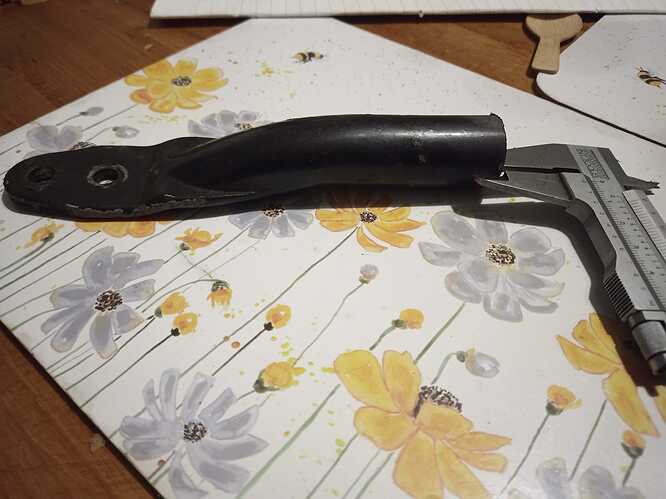

Anyone know what the internal frame tube diameter is on the top rails please? I am looking at a small integral brake/tail/indicator from Kellerman that might possibly fit in the end of the top frame rail at the rear. Or, if nobody has cut their top frame rails, do we know what thickness they are in terms of whether 1 or 1.2mm tube was used? Thanks
OD 25mm+, ID 20mm-, wall 2.5mm
I’ve made that cut especially for you:>

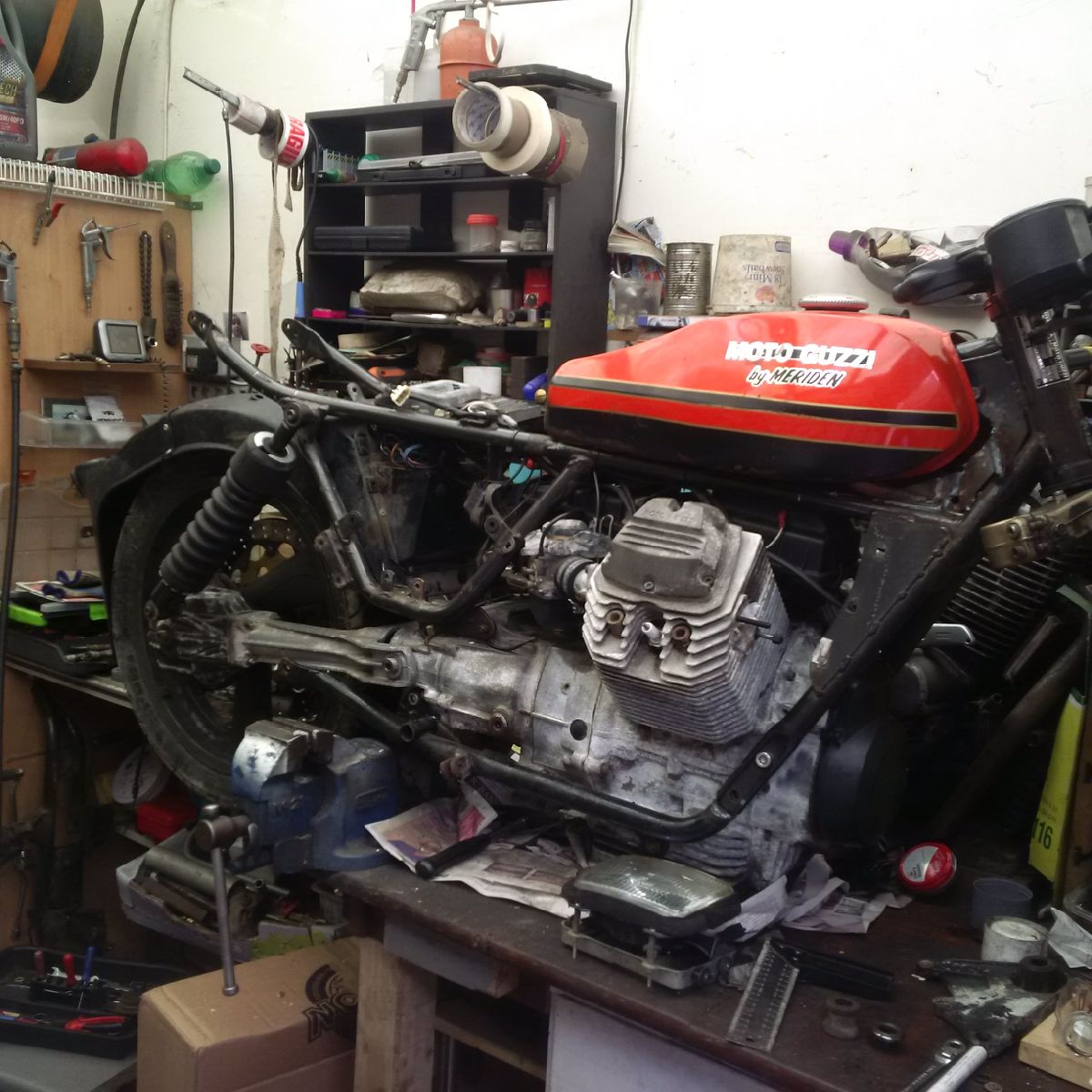

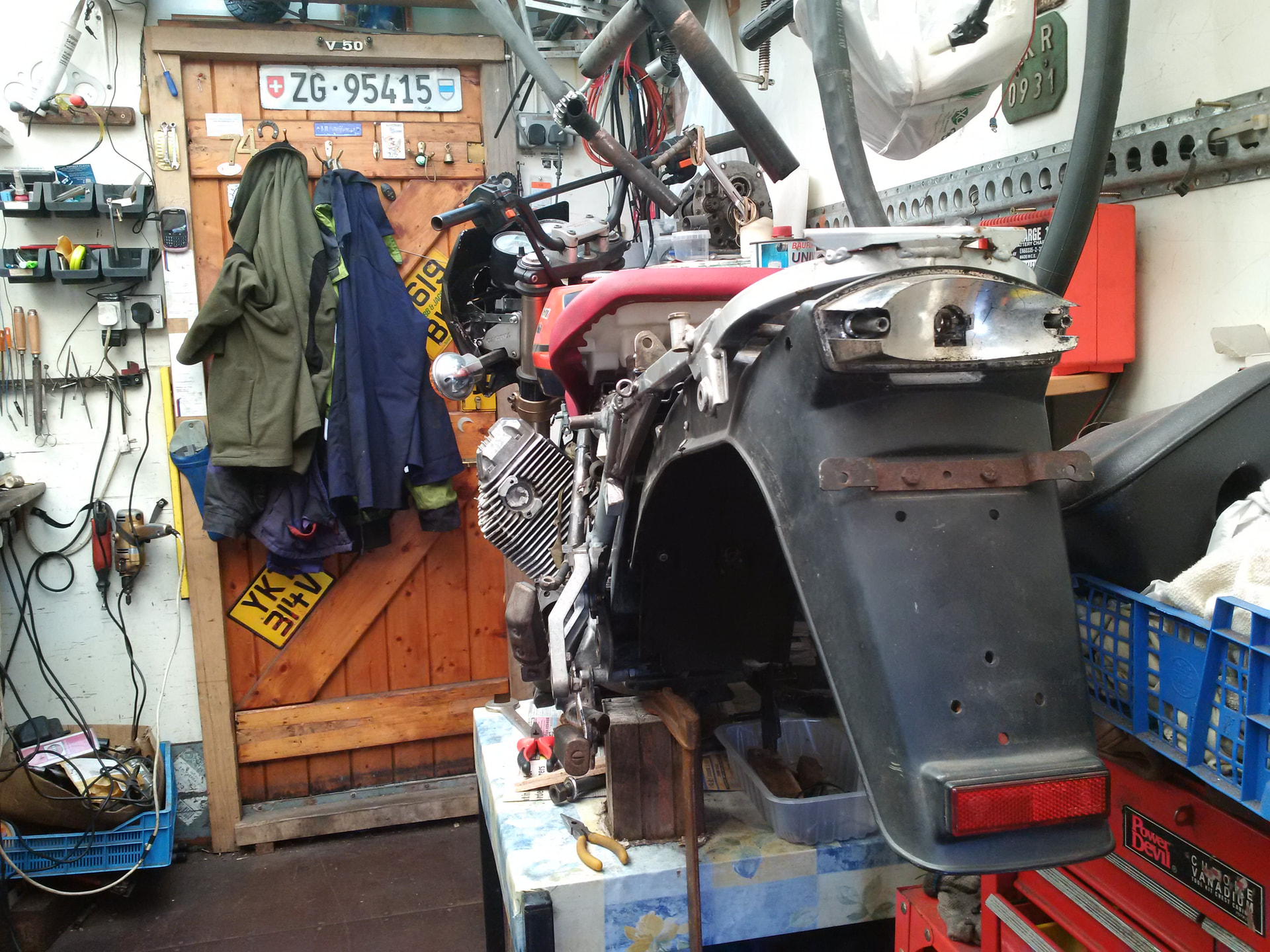

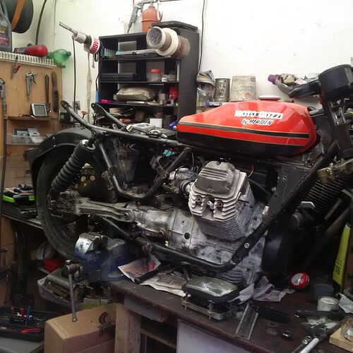

Yeah, I hate Nevadas and chopped one with real pleasure. Just look at this tail, how pathetic.
Cut it right behind upper shock mount and extended with unwanted Cagiva River rear subframe. You may notice a mid-thick steel lug(not sure if this is the word) , triangular in shape, does the job, for carrying passenger too!
much better…is that its current state or has it moved on since you took those photos?
