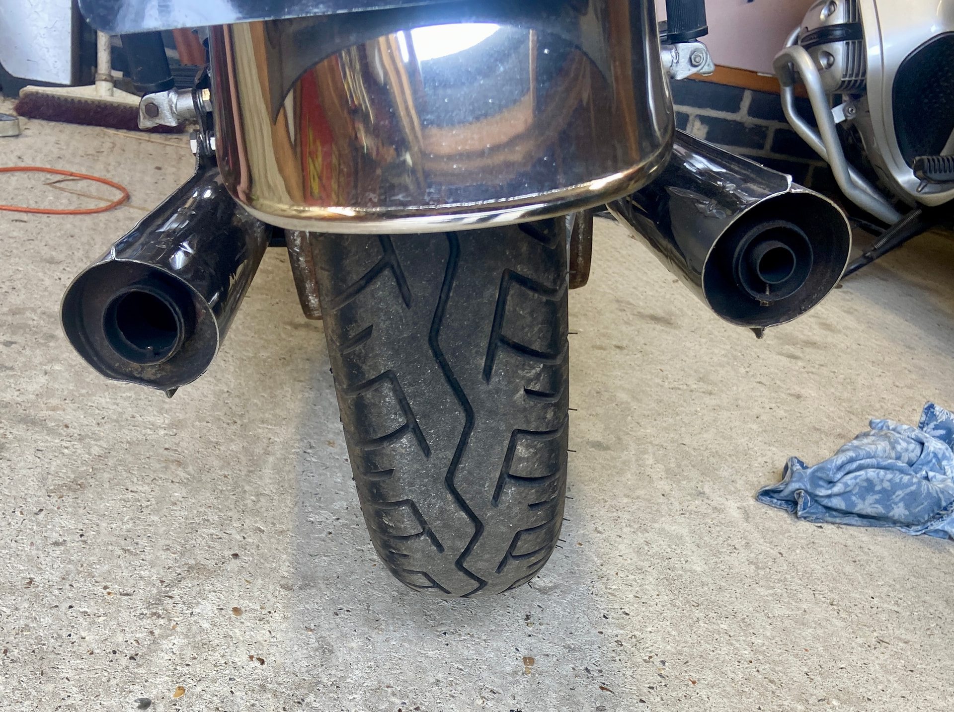

Just taken my (new to me) 1973 850GT for a first blast and dismayed to discovered Ive lost a baffle from the nearside Lafranconi silencer. To be precise a Lafranconi 10 DGM-10172S. Has anyone out there ever replaced a baffle in one of these… I see that ebay has quite a variety of universal baffles available. Advice please on whether its possible or do I have to replace the whole system… and on that note has anyone got a silencer for a Loop ie with ballancer kicking around they want to sell!?

Hello David, I had exactly the same thing happen on my 850GT. I found the best thing was to remove the baffle on the good side and get a pair of VW beetle end pipes.
I then made up a metal bush to take up the difference and it worked OK, and the end pipes are chrome so they look OK.

Measure the baffle diameter required (from your existing baffle) and have a search on ebay etc, you’re sure to be able to find a suitable candidate to replace the missing one. Ive had to do this on several occasions over the years. A bit of loctite on the baffle bolt threads will help prevent reoccurence.

Thanks guys for all your advice… I bought some from eBay but they made no difference to the overall volume… despite being billed as ideal for a classic bike etc… so I got a fabricator to copy the remaining one and make me 2 new ones which are working well…Phew! Prices of replacement lafranconis scary…
