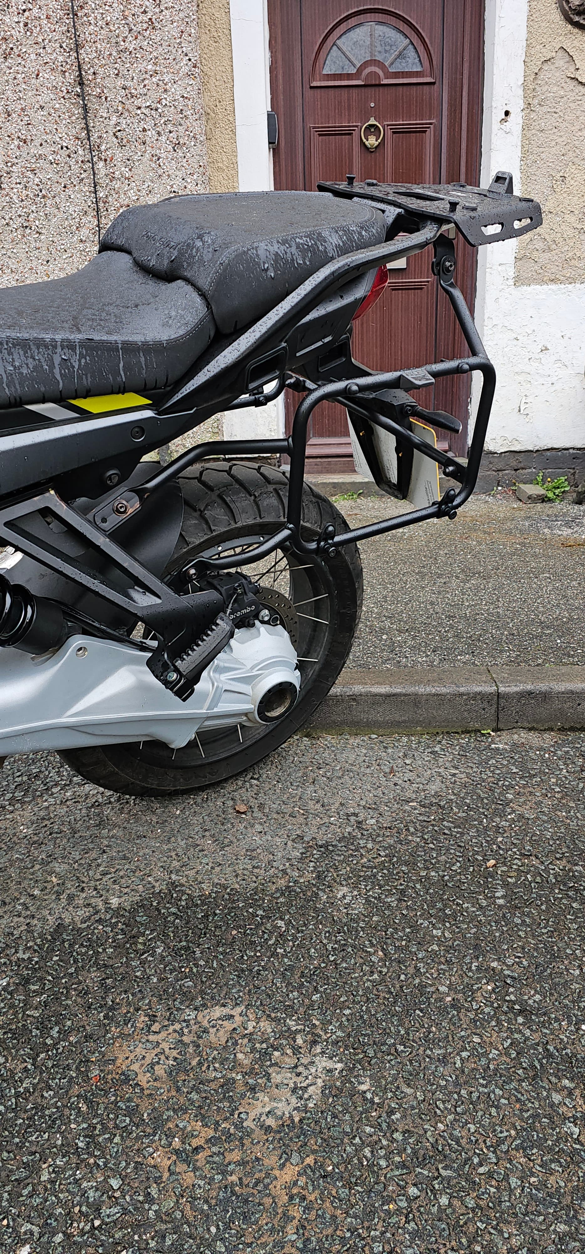

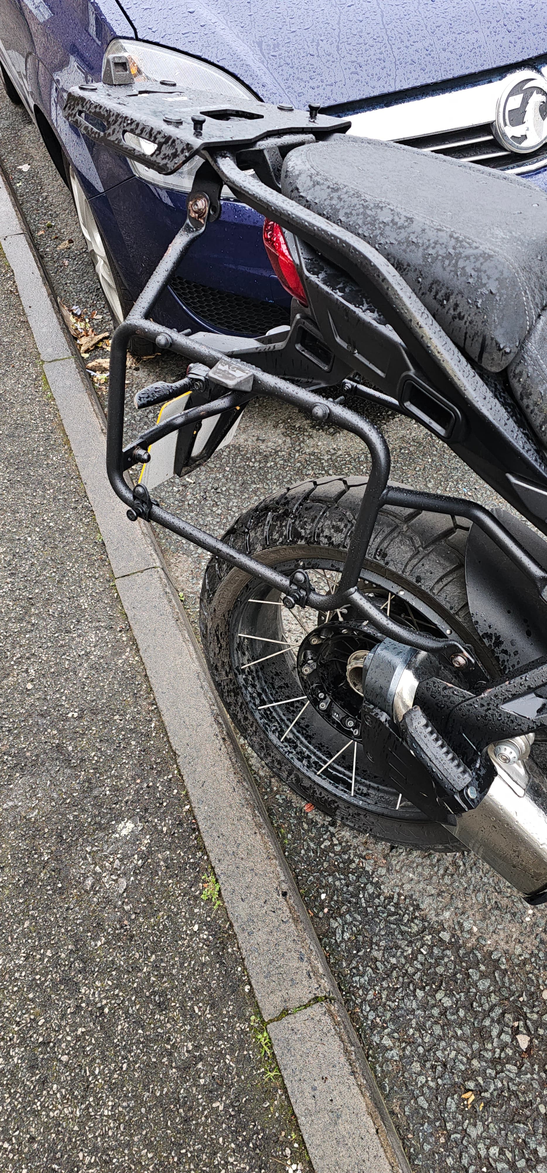

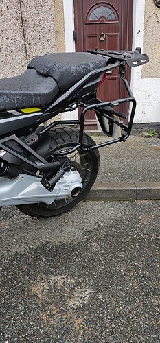

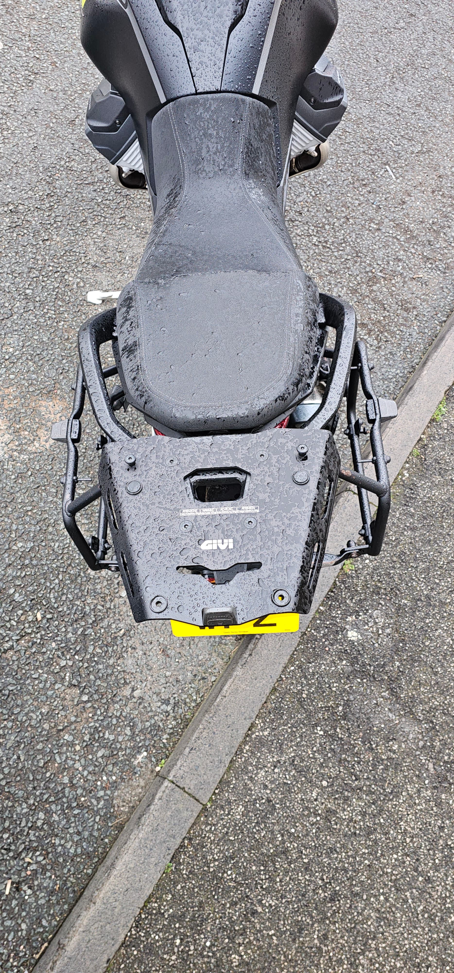

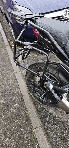

So the MG Panniers are a stupid price and have diddly squat capacity.
I already had a full set of Givi luggage, keeping itvItalian so the PL08208MK was the way to go.
Only issue was that MG had locktighted the footrest hanger bolts to high heaven and beyond. Trip to the dealers sorted that out, big thanks to Wigan Motorcycles.
They look quite neat, rather than the scaffolding look some have.
The top box plate is nice too, not like some big dinner table affairs you see. :+1:
I have a similar set up on my Vstrom which is quick-release too.
Forgot to say, I found the tie-bar that runs under the mudguard soon became chipped and rusted, so I re sprayed mine and then covered it with a section of clear tubing (from an aquarium shop).
(Warmed up in hot water I found it slipped on nicely and the bar is now weatherproof :+1:).
