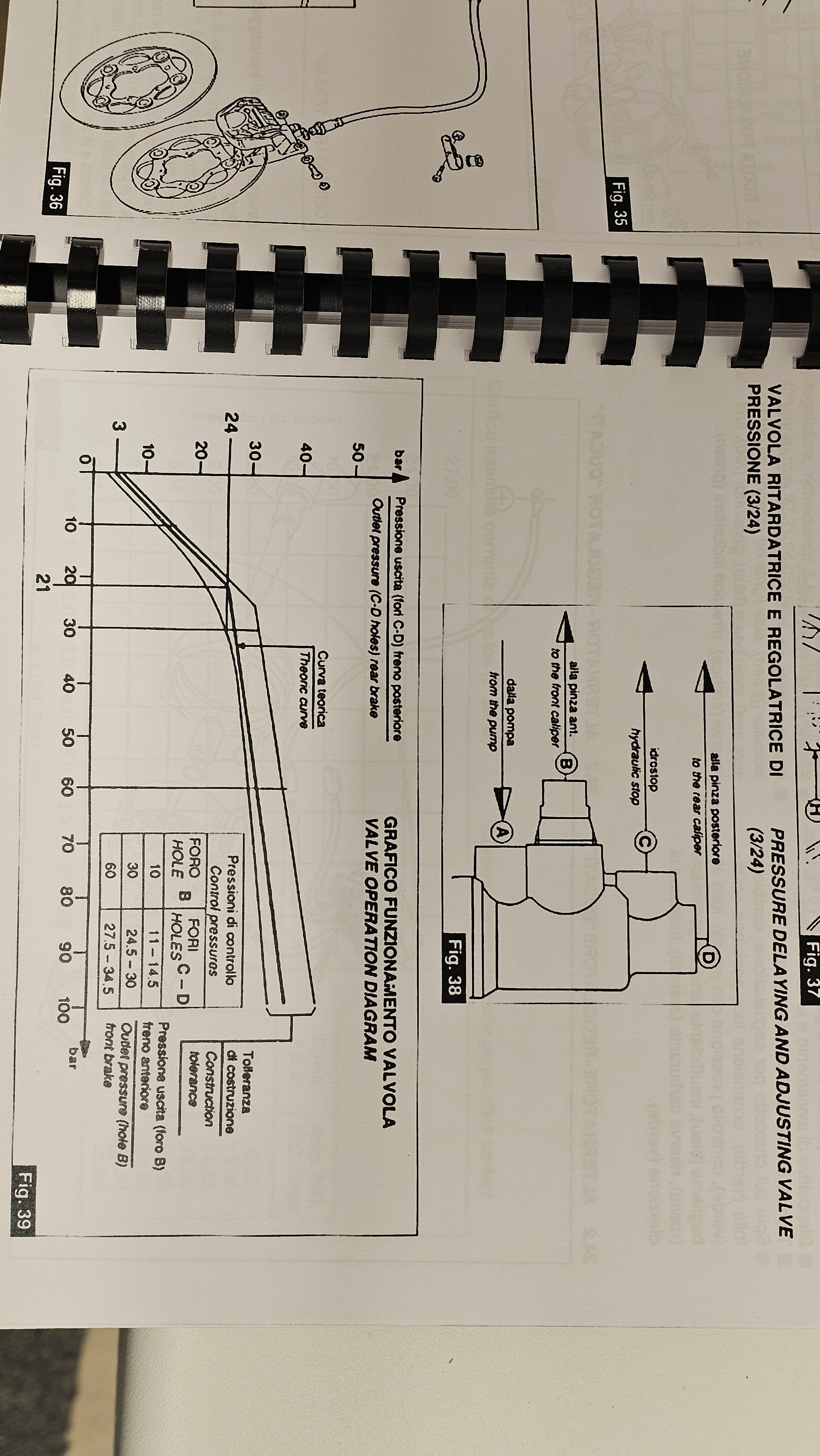

To clarify the manifold or splitter does not change the pressure to front and rear. The braking distribution is down to relative piston and rotor sizes.
On other bikes with the proportioning valve, SP,G5 and Cali 1100, there is a spring loaded piston which kicks in at a certain pedal pressure and this varies from model to model. They are not interchangeable but I dont suppose in practice it makes much difference. Again this relates to pressure and braking distribution will be affected by piston and rotor size eg the SP has a much larger rear piston.
This is from the 1100 manual
