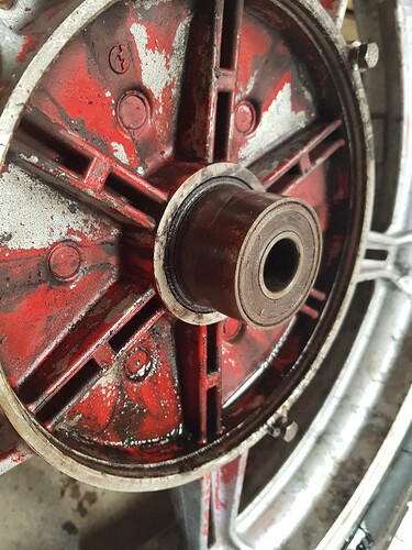

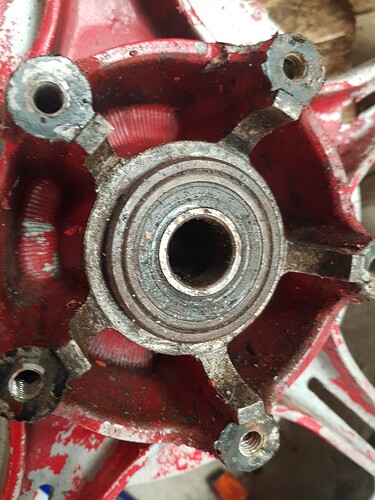

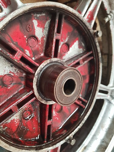

Do you mean the splines that engage in the bevel box. It’s a long time since I did mine, but I’m sure it was quite simple. Is there a large circlip that holds it in place?
The bearings should just knock out with a drift inserted up the centre.
https://www.motoguzziclub.org.uk/forum/download/file.php?mode=view&id=1809&sid=2d52ba1a2fcb3200893ae1ff7509fccd
I have uploaded a picture of the ‘hub’ for clarity so you can see what I am speaking about.
Not sure myself, I haven’t stripped that bit out. More heat would be my first thought. But Chris may have a far greater knowledge
Could it be masked off and left in place whilst you have the wheels powder coated? Obviously the bearings would need to come out and be replaced.
I was thinking the same myself, it’s the first time I have thought about powder coating so not absolutely sure how stripped the wheel needs to be.On the Gutsibits website they have a bare rear wheel and the center hub has been removed. I think I’ll give Carlisle powder coater’s a ring on Monday and get some advice, rather not damage the wheel needlessly.

I’ve had a couple of Cali hubs powder coated. The steel boss/insert which carries the drive plate remained in place. The powder coaters blanked off any areas not needing powder coating.
Many thanks for that I was hoping to leave it in situ.
