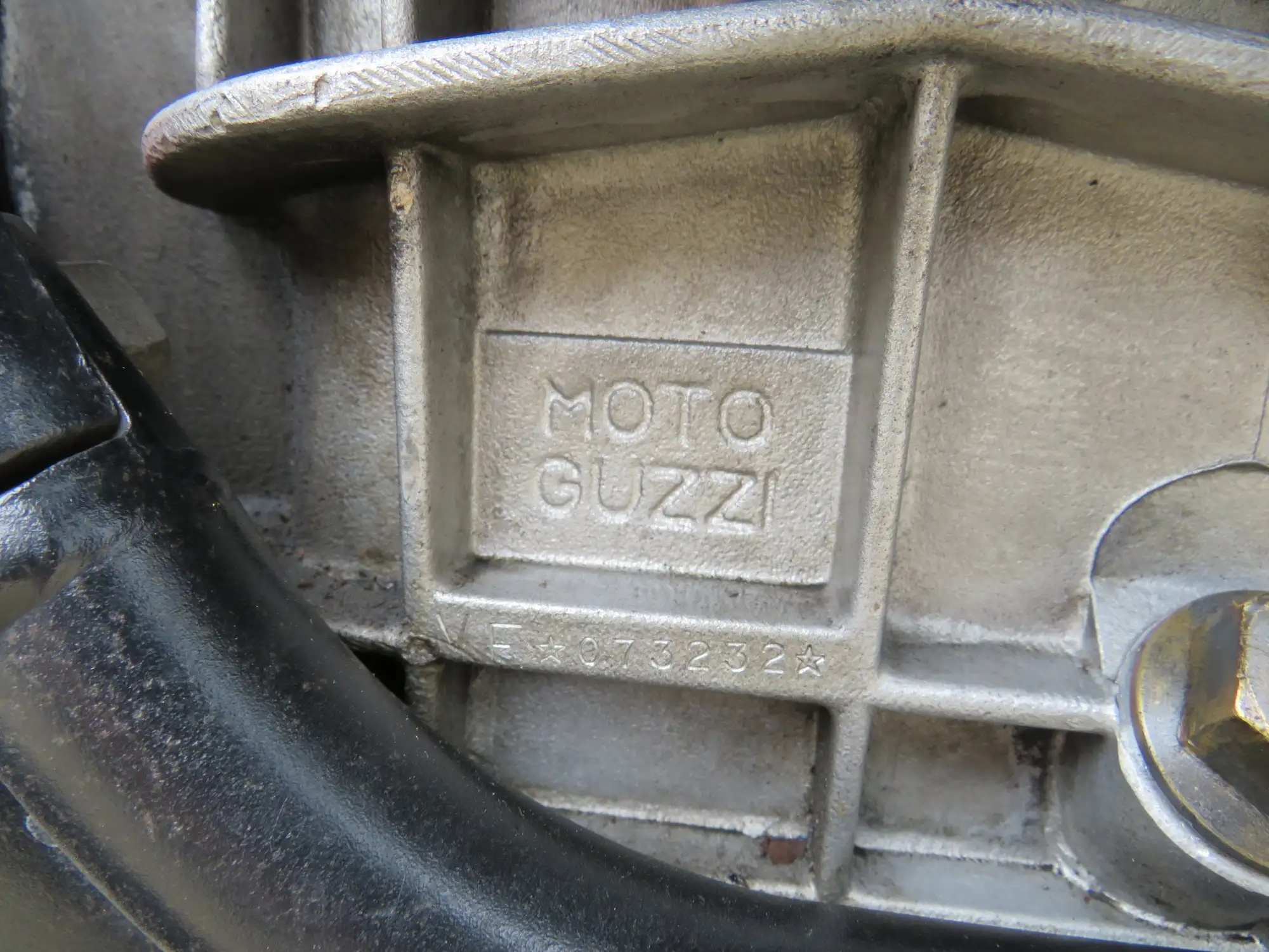

Engine number is VF (or could be VE, it’s not very clear) 075214.
Heads are 13.02.22.60 with M6 manifold bolts.
VF engine numbers are for LM 3,.

The strip where the engine number is stamped is quite narrow, could it be that the lower edge of the E in VE just missed the metal and so it became a VF ?

I had a LM1, the manifold screws were M6 (all others, T3 etc. are M8) and the eng. No. began ‘VE’. If memory serves ‘VE’ means Le Mans.

It’s possible but it does look like an F when I blow up a photograph of it
Does anyone know if the middle bar of the E in VE engine numbers is shorter or is it equal in length to the top and bottom?
Here is an image of a VF engine number

And image 56 in this album shows the numbers for a Lemans 1 series 2

I’d also add, based upon Greg Bender’s files, that your engine number is about the right number to be a VE, late Mk1 or early Mk2. There seems to be some overlap, given the engines were pretty much identical. I think Don’s right, that’s a badly stamped E, and seeing his auction photo implies that’s reasonably common. In answer to a previous question, the middle leg of the E is about half length, so likely the F would be similar. I’ve not got a decent photo to post.
That photo looks exactly like mine👍
