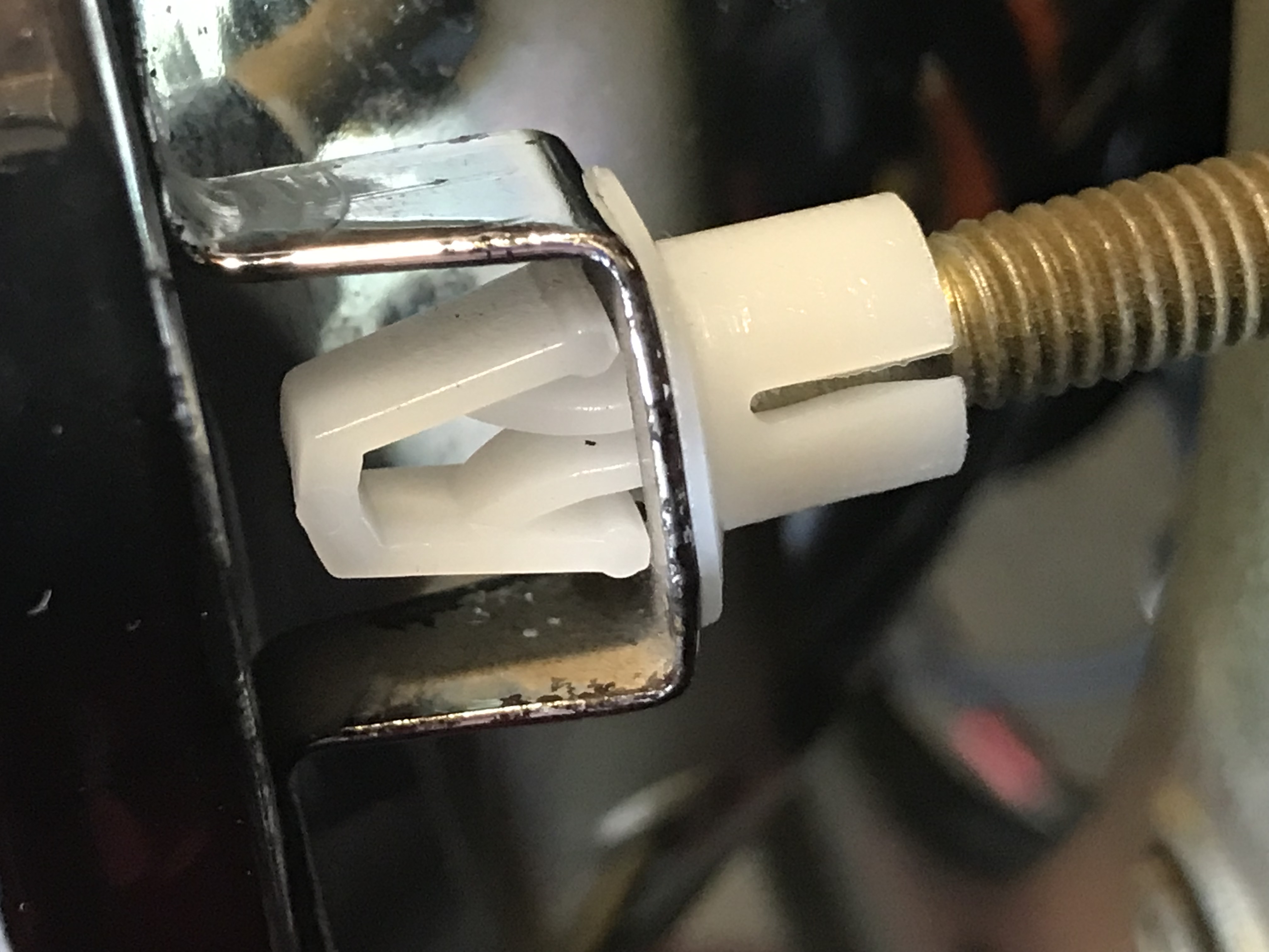

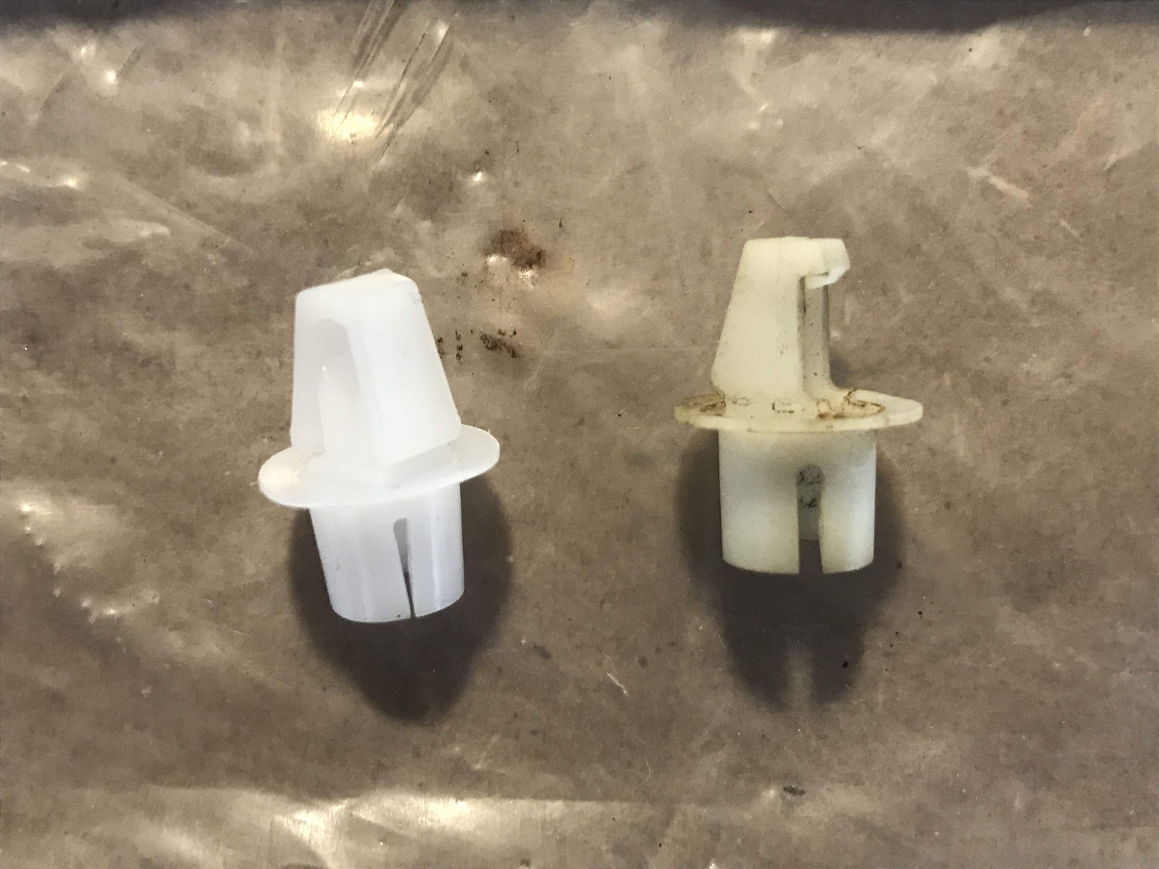

My actual headlight is in good shape, the nylon clips are badly worn but I’ve found new replacement ones, that should cure the wobbly headlight, I’ve also found an adapter to convert from the old tungsten bulb P45T fitting to a more modern H4 halogen bulb P43T fitting. Hopefully that’ll sort out my headlight woes :+1:

Quick update in case anyone else has similar headlight issues, the Fiat headlight nylon fittings work perfectly, 5 minute job and the wobbly headlight is no more, it’s now rock solid, the fittings are Fiat 126, 127, 128, 131 Strada Ritmo Lancia, at least that’s what it says on the invoice.
The adapter also fitted perfectly so now I’m running a H4 bulb in the original headlight.
Cheers, Don.

Like your old nylon fittings, mine have loosen considerably and are now ‘tighten up’ with various size cable ties…
