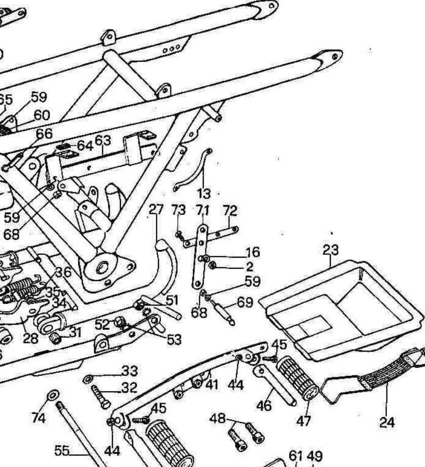

Anyone got a lifting handle for a MK1 Le Mans? Part 13 shown in picture.

By the way, just so you know, it doesn’t look much like that drawing. And there’s a spacer that goes behind one end, I think it’s the top, because the other end clamps the brake manifold splitter.

There is one in this photo click here that looks different to the parts book one.

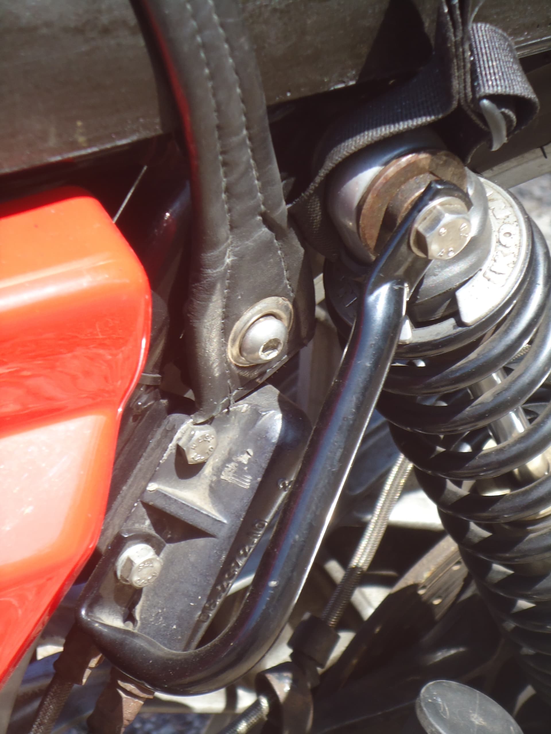

Here’s a picture of what it looks like. Note the cylindrical steel spacer between the handle and the washer over the shock silentbloc bush, at the top.
Unfortunately, I’ve never been able to find it in the parts book. On the suspension page, they list the two bolts as being different lengths to cope with it.
Thanks Andy, that’s very clear what I’m looking for :+1:

It looks correct. The other thing to do ( because I can tell you’re trying to ā€˜originalise’ this machine ) is to ask about that spacer.
Or get one made, internal diameter to suit the bolt + 1mm, outside diameter ID + about 20mm, thickness looks like about 12mm. Second thoughts better to get someone to measure one.
I have had made spacers for my bike in stainless, not an expensive exercise when you have a friend with a lathe.

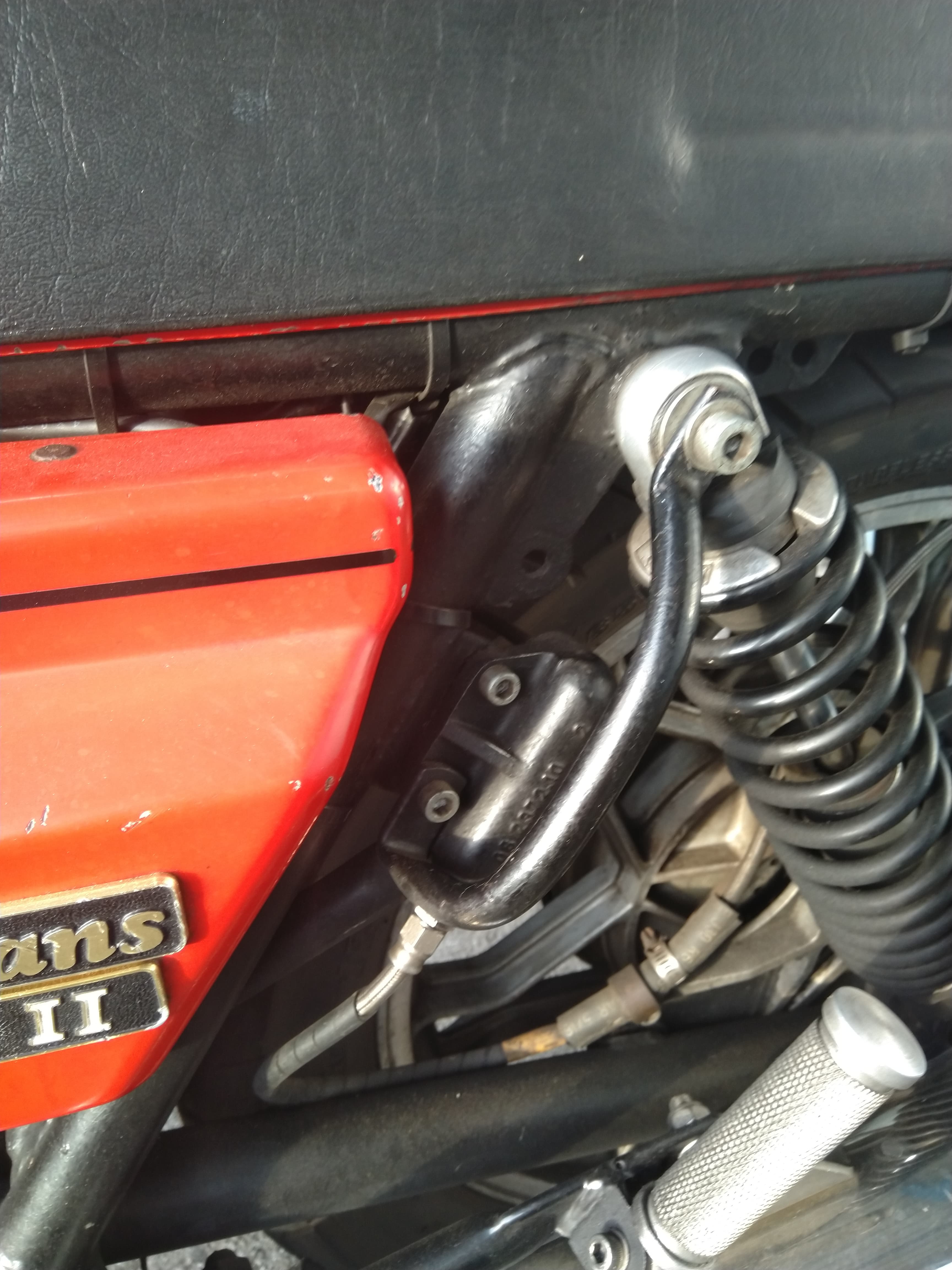

My friend found a Mille GT lifting handle and fitted it to his Le Mans 2 quite easily. It swings out more and folds away, I think it is easier to grab and use as well.

The lifting handle comes in two shapes - the one shown by Andymay was on the LM I and earlier versions of the II, whilst that shown by Fairytail is for the later II. The earlier handle has the effect of sliding the lifters hand into a narrow gap and crushing the fingers. The later lifting loop is more ā€œDā€ shape and doesn’t do this. I’ve never seen a spacer here although I have used a thicker washer.

LM1 part is 14464351, the later LM2 part is 14464355.
The LM2 parts book has a much more realistic drawing of that handle.
I have both on two different LMs and my fingers bear testament to the horrors of the early version.
