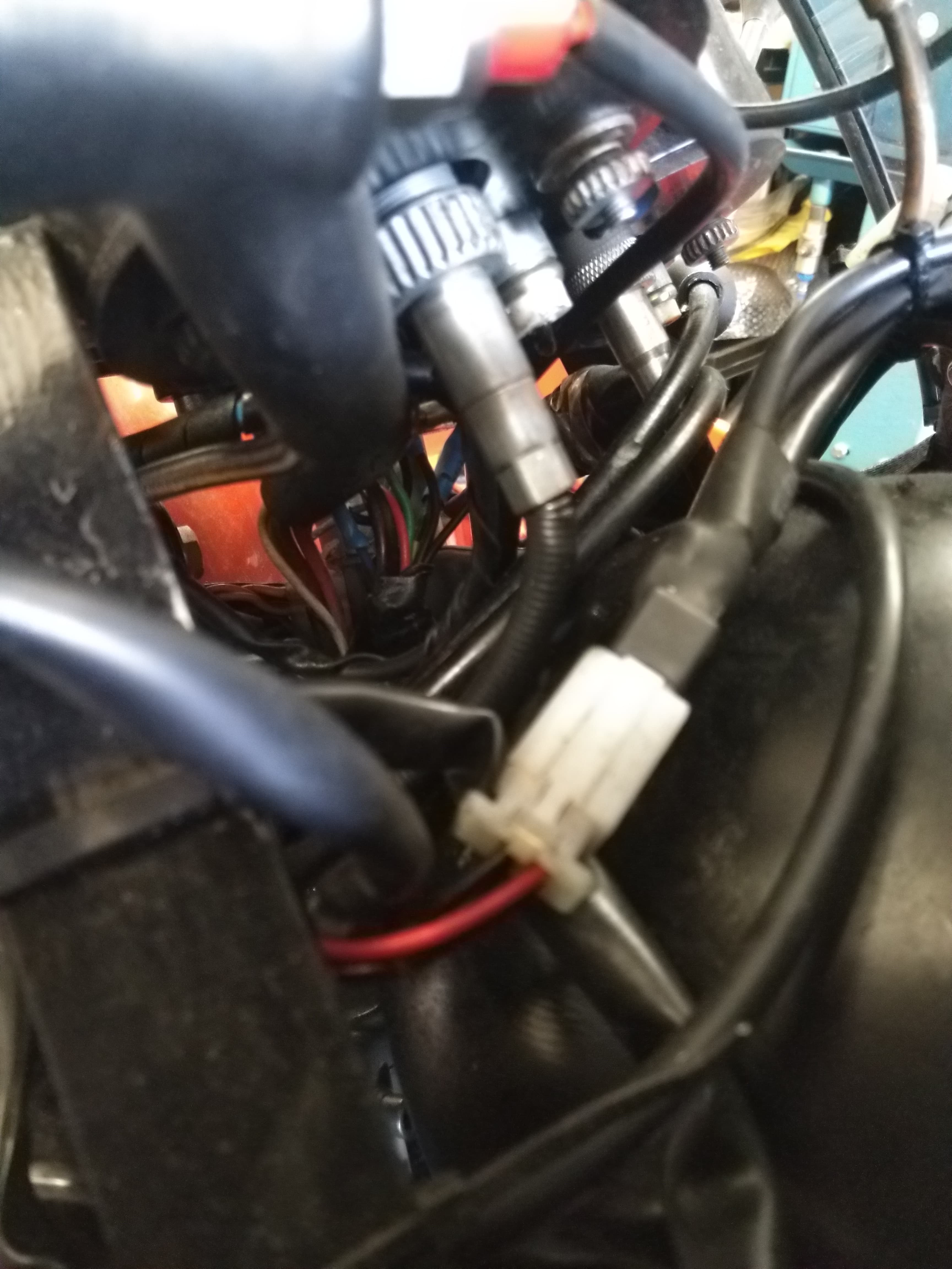

The inner speedo cable only lasts a few hundred miles.
The curve under the speedometer looks too severe.

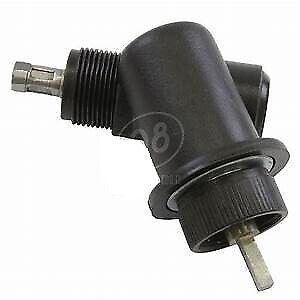

The LM2 had 60 degree drive boxes fitted to both speedo and tacho.
Not sure if this is the right one but this is the sort of thing you need
Installed one of the two 90’ bevel boxes I found in the huge pile of spares that came with the bike, and normal service has resumed - sorted.
