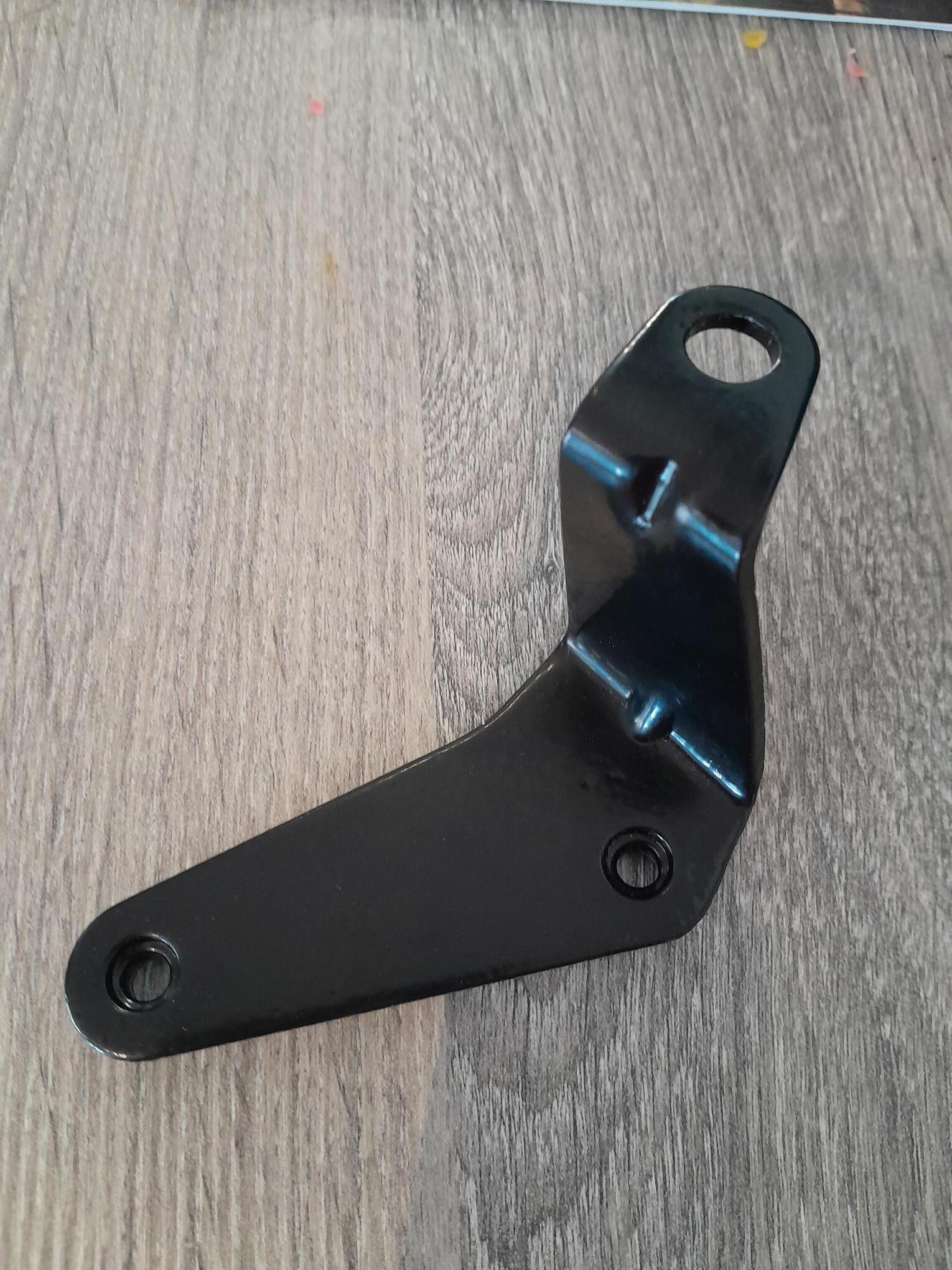

I’m trying to establish the correct lower fairing bottom brackets for my rebuild. The bike never came with the side fairings. From what I can see, there are two main types - fibreglass and abs type plastic (which I have) I have a bracket from a 1000SP and another and they are slightly different but both on the same principle. Does someone have a picture of what they think is the correct lower bracket?

Attached is the bracket that I have and for the life of me, I’m trying to understand it’s fitment - if it is correct!!

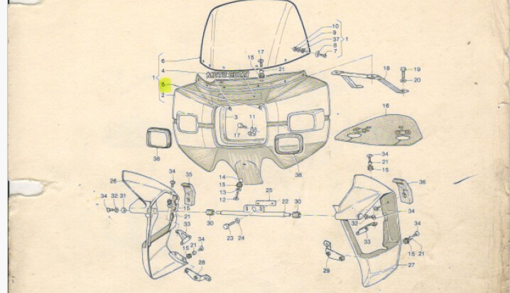

These fit between a gearbox mounting stud/nut and the bottom of the fairing
There are R and L handed versions parts 28 and 29 on this picture
Almost certainly the same part as on an SP1000 as the lower fairings are identical

Thanks Russell. As soon as I saw the orientation of the bracket I knew where I was going wrong. LHS fairing now in place and just need to sort the choke lever orientation and real progress has been made. I have the other bracket, so it should be plain sailing from now on.
