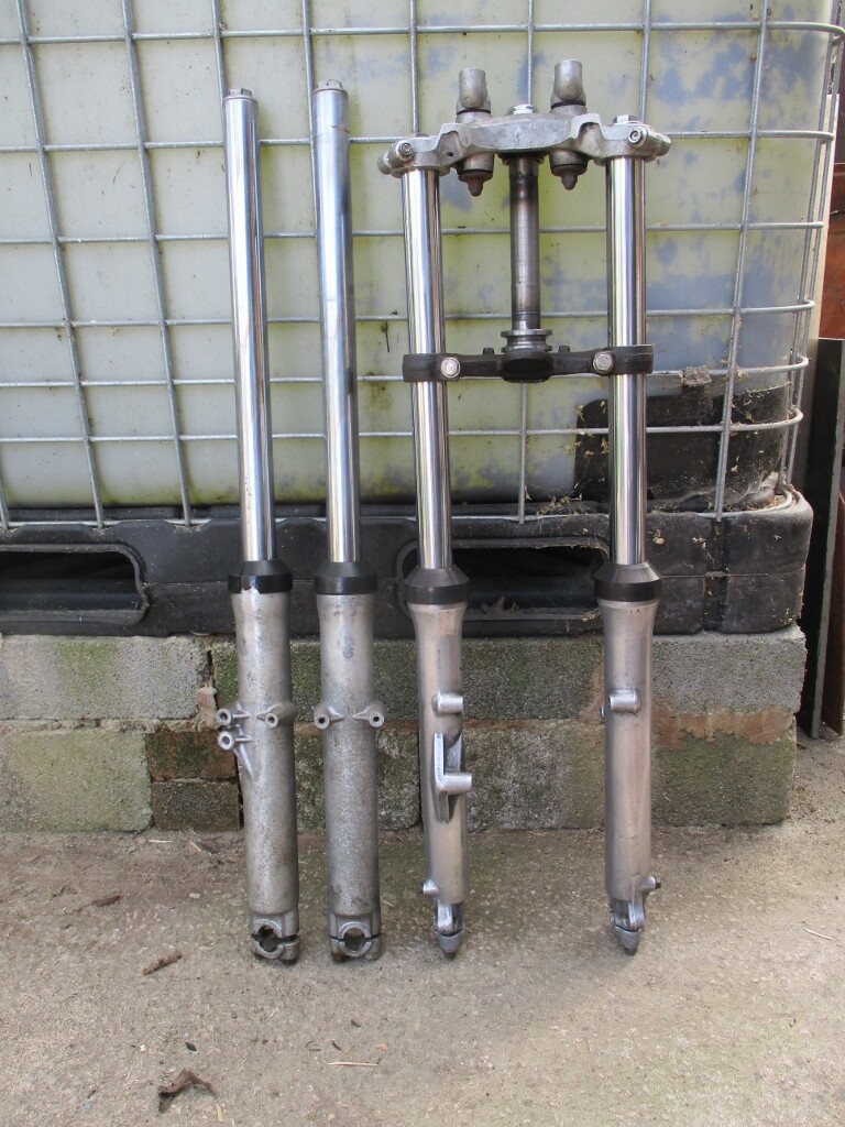

How long are your DT forks? The ones I have are a bit too long and a few inches shorter wouldn’t go ammiss.

forks are 33mm dia and 780mm overall long. They need to be 730 long unloaded so I may shorten them. But they have a centred axle, and the extra length might be useful in adjusting the length and therefore trail to get the steering to be what I want at the height I want.
The rh set are Honda CB360T forks for a BSA 250 trials rebuild for comparison.
Rick
They are about the same length as the Suzuki ones I have. The yokes are very flat, but the wheel spindle sits in front of the leg so am hoping that will help with the trail.
