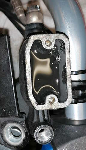

This was the Reservoir on a friend’s Stelvio that I did some work on recently . . .
Couldn’t decide whether to flush it out, or dip a Quill in it!
