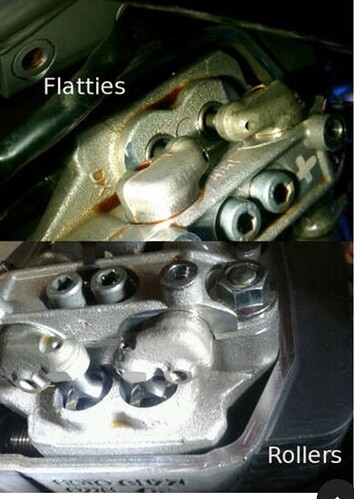

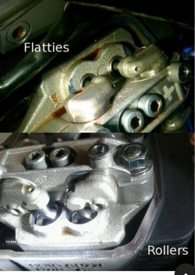

  3. is there an easy way to tell if the tappet modification has already been done? For example, can the roller tappets be easily seen from the top of the engine?

Here’s a pic that may help you to see if your bike has been rollerised…It was taken from the “Griso Getto”.
A great forum for loads of help/information.
PS take off the head covers and look…they should be easily seen. Cheers :blush:
Larry46 - Many thanks for the images they are most helpful. I will take another look but I fear it still has bucket type followers.
If it has the buckets they must be replaced asap before the metal filings thrown off kill all the bearings. If they are the last attempt by Aprilia to make the buckets work (with Diamond Like Coating) they will kill the bearings faster and more completely by embedding flakes of that coating :frowning:
Once “rollerised” it is a wonderful engine but otherwise…it is a grenade
