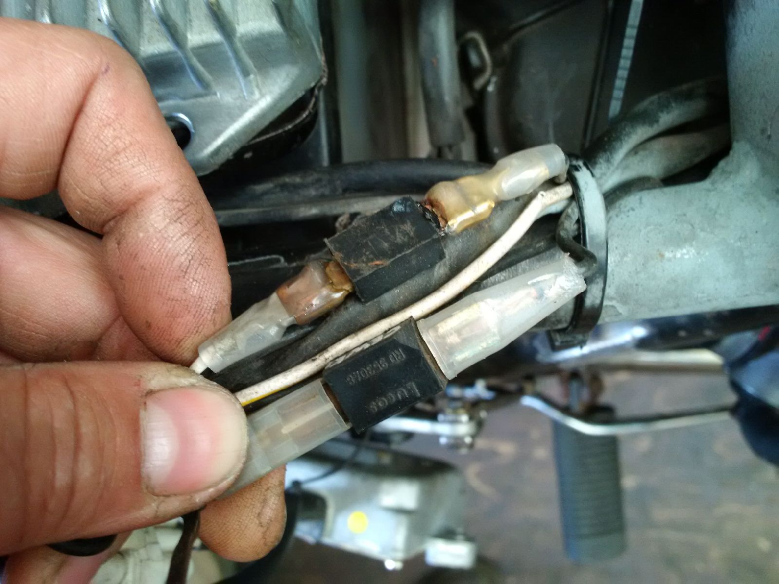

A friend of mine has a V50 Monza that has an intermittent ignition issue - its fitted with a Lucas Rita System - there appear to be diodes fitted in the earth wires of the two coils. These connect between the coil earth and the Rita box. Both look a little tired and burnt. Genuine Lucas replacements seem unobtainable (we have searched the part number) Does anyone on here have experience of the Lucas system and know if there is an alternative part available.

Sounds like the 2 x 12V coil variation - where isolating diodes must be used otherwise only one coil will spark. If you test the coils’ resistance and they’re about 3 Ohms, then they’re 12V coils.
Alternatively you could use 2 x 6V coils in series instead, which won’t need the diodes. Personally having used one of these before I would favour that, the diodes version always felt like a bit of a bodge-up to me.
Also check the 5-way plug block in the Rita sub-harness for bad connections. Mine ended up very tarnished and brown (originally just bare brass I think) and I ended up cutting the wires and soldering them together to guarantee no further issues with the connector.

The diodes on his bike look burnt like those in the photo above. Hopefully new diodes will sort it.

That looks like a classic case of the spade connectors went high resistance (‘dirty’ contacts) and subsequently got too hot. The heat wouldn’t have done the diode any good either, so one issue creating another fault. :unamused_face:
My friend replaced the diodes with these - which have the correct connectors to match the loom.
Running fine again now
