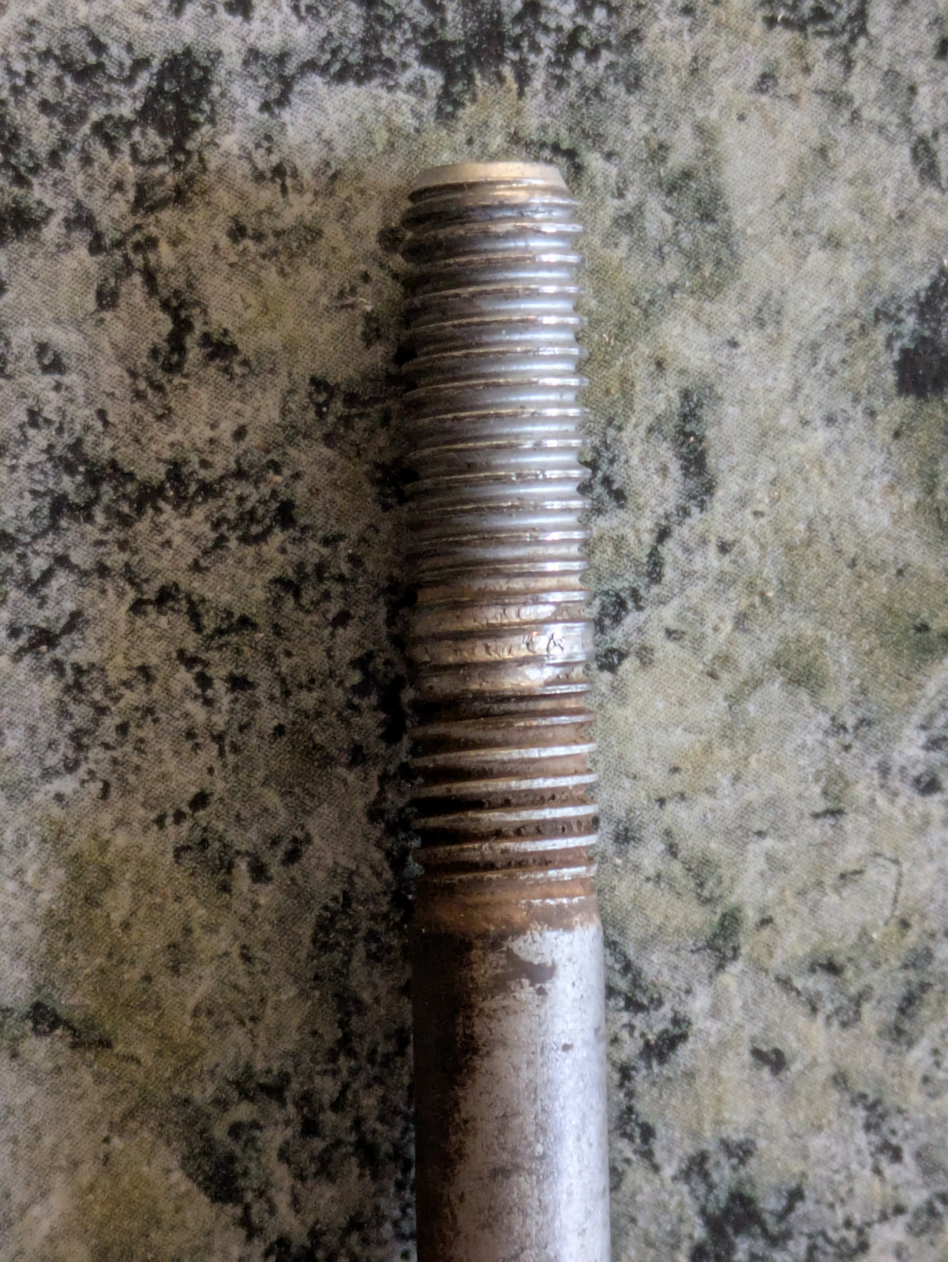

First problem was getting the standard front pipes off – the mount above the Cat uses a long bolt into an alloy bracket, in turn bolted to the back of the gearbox. The cat support bolt was corroded in and I had to use an impact driver to remove it – it came out with the first two threads of alloy welded onto the bolt. As the bolt isn’t needed with the new pipes, it wasn’t an issue, but I did remove the bracket from the gearbox and then run a tap through the mounting bolt hole to ensure the threads left were clean. The exhaust mounting bolt goes in far enough that I deemed it reusable.

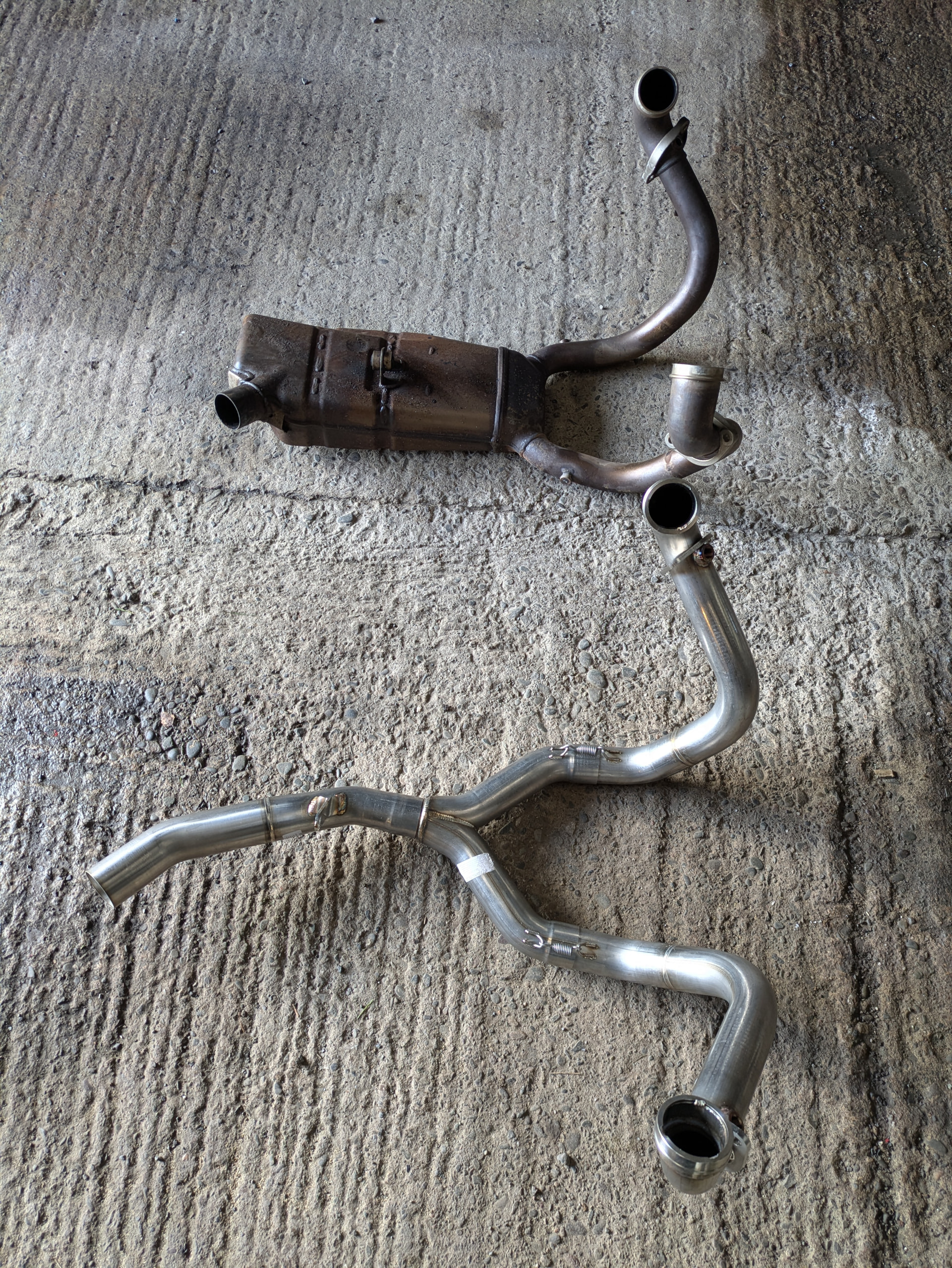

For my own interest I weighed both the OE pipes/cat and the new MIVV decat headers:
OE = 6.3kg
Mivv = 2.4kg
The object of the exercise isn’t weight saving, but every kilo helps!

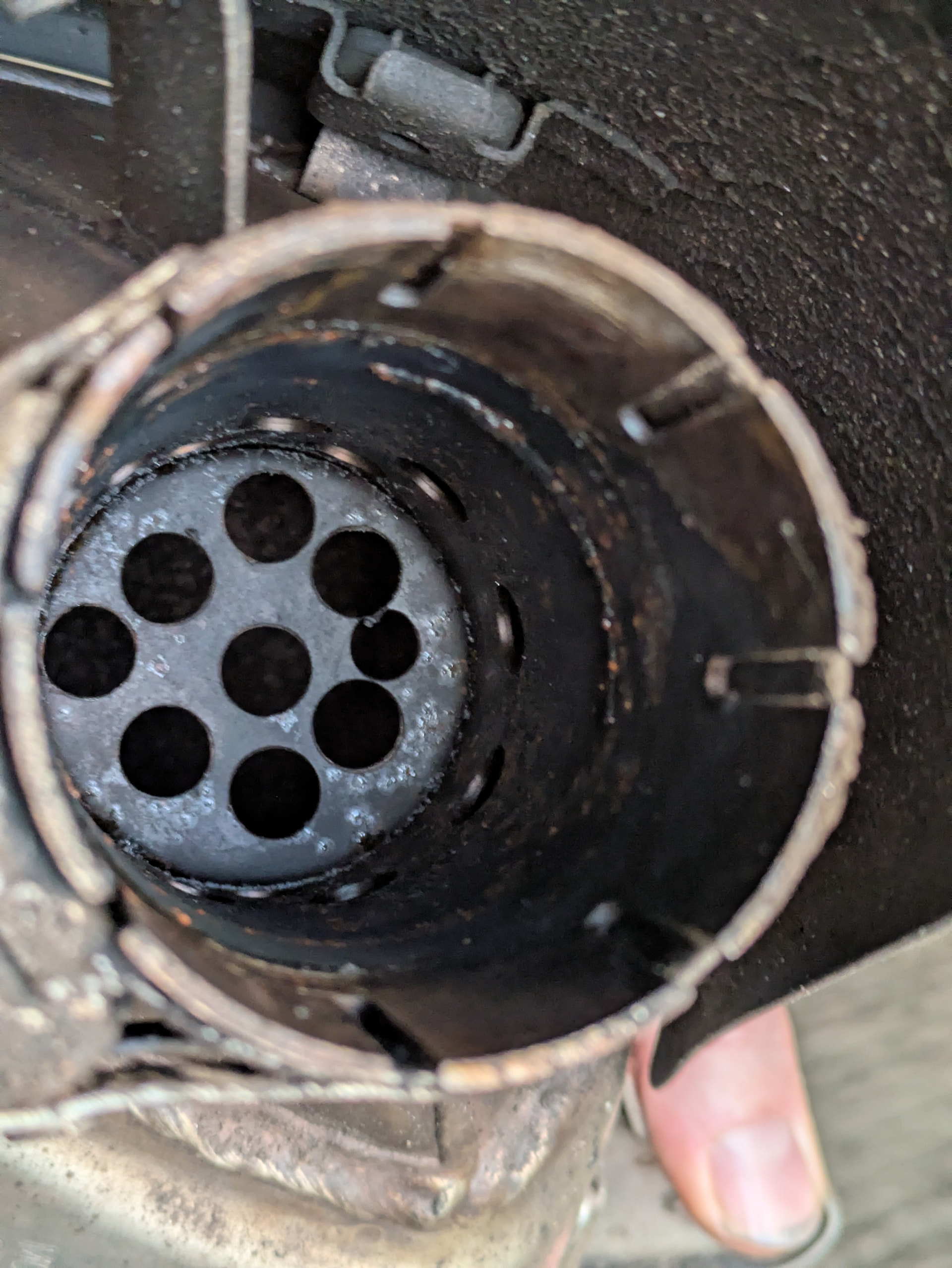

Not everyone loves the stock silencer and although it is heavy, actually I do like the look of it and it may be helpful to have the OE can on when I start needing MOT’s, only 6 months away now. That said, I have already taken a long drill to the internals from the front to ease gas flow, making it slightly more tuneful but not loud.
If you look into the front of the OE silencer as provided, it has a flat plate that the exhaust gasses hit at the end of the entrance tube, the gases then pass through small holes in the periphery of the tube to get into the main body of the silencer. That seemed awfully restrictive using fairly small holes to me and not ideal for a 1,000cc twin to breathe, so I have simply shortcut the process to allow more direct movement of the gases through into the silencer.
