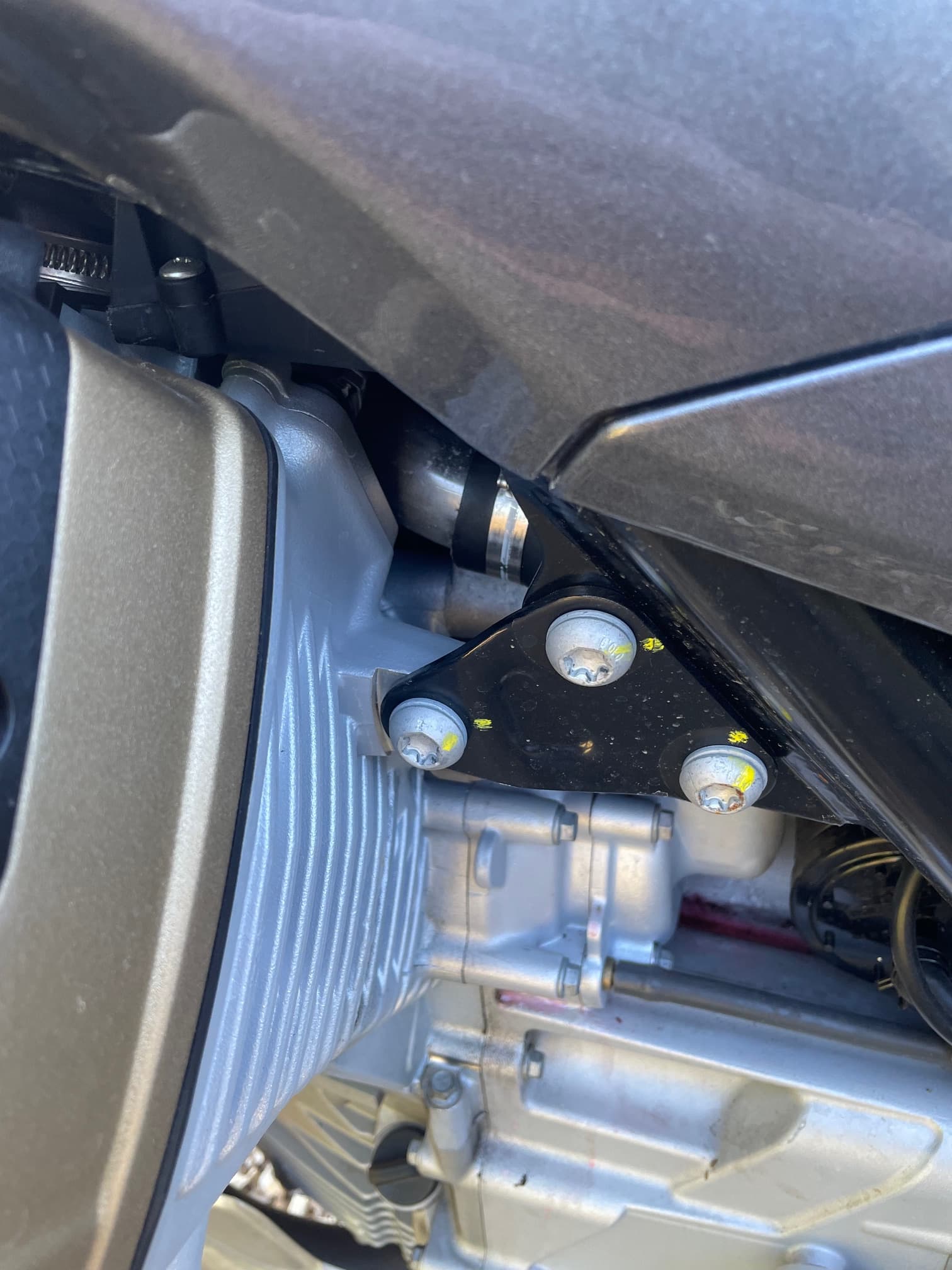

So, nine months since purchase and 2000 miles and the Mandello has a water leak. See picture. Dealer says it’s not common but easy to find examples on the net. Apparently it’s likely to just require a jubilee clip but will take the dealer three hours to get to the offending item.
I wonder how much it has cost Guzzi in warranty work to fix these cheap clips? You would think they would have rushed an upgrade through to production ASAP as 3 hrs labour is a good few quality clips isn’t it.

I’m afraid it is remarkably common. I had same issue surface in Campbeltown. Long way to ride down monitoring coolant level. I don’t think the clips are cheap; reckon they’re quality. But as the rubber hose ages slightly it relaxes the tension on the clip. So maybe just slightly the wrong size, or need a different type. Either way, yes, the warranty bill is high, but I think the dealers end up eating a fair bit. Piaggio don’t pay them much for warranty hours.
They just used a Jubilee clip on mine, rather than the Clic’R that was on there.

They are not all down to the clips. Mine was due to a warped thermostat housing, the two halves of which turned out to be missing the required O-ring between them!
Mine was something similar to that as well. The casing distorted.
