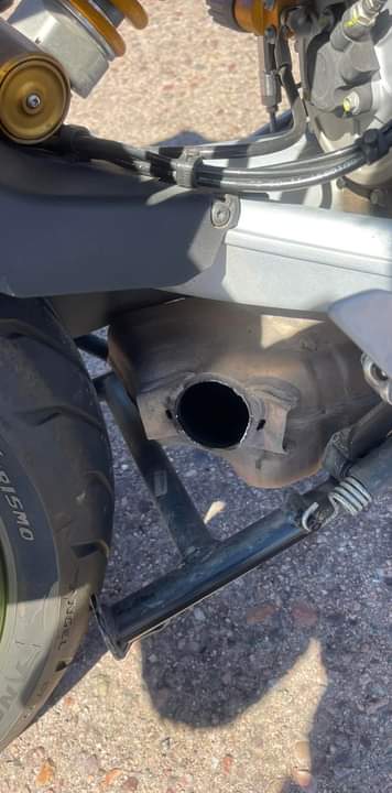

What about this, then?
Not me but someone off a facebook group. Apparently 5K on clock..
Just something else to look forward to?
Ffs, that’s a horror, not acceptable at all is it. Only thing I can say about that is anything now with a v100 should still be under warranty… :-/
Wow!, my question, what happened to the rest of it?
The can is suspended from the footrest hanger so it didn’t just fall off.
Apparently, when the weld failed, the rider just stopped, removed the end can, put it in his pannier and continued on his way.
I am convinced that this failure mode stems from the way that the cat box is suspended on that metallastic bush/bolt arrangement that allows it to move in a fore and aft plane while the end can is held by the bush on the footrest hanger.
There again, I could be wrong.
But as usual, this does not appear to be an isolated case.
