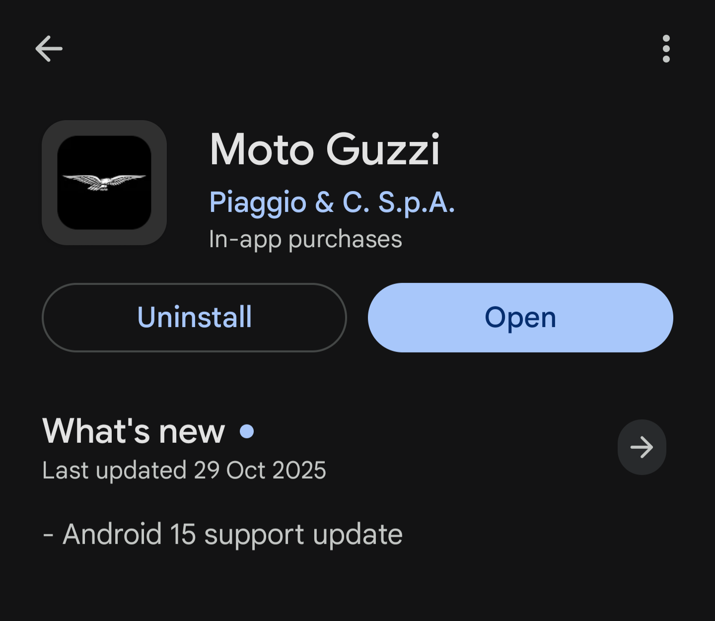

Just had a look to see if a update for the app is available, nothing unfortunately.

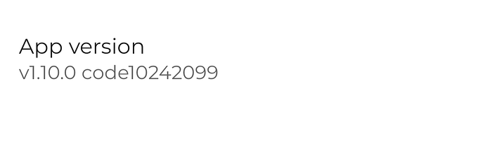

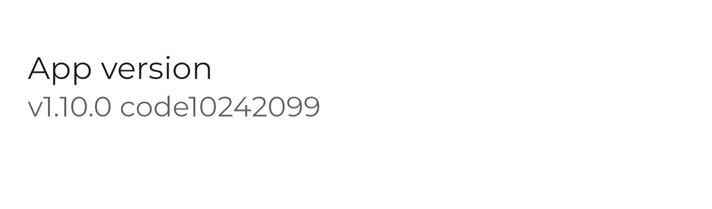

My phone is a android, the app version i am currently running.
v1.10.0 code10242099
perhaps you have auto updates turned on and it has updated itself?
this is the current version which was only available from last week. I tested it yesterday on a 50 mile trip and it works noticeably better than the previous one.
