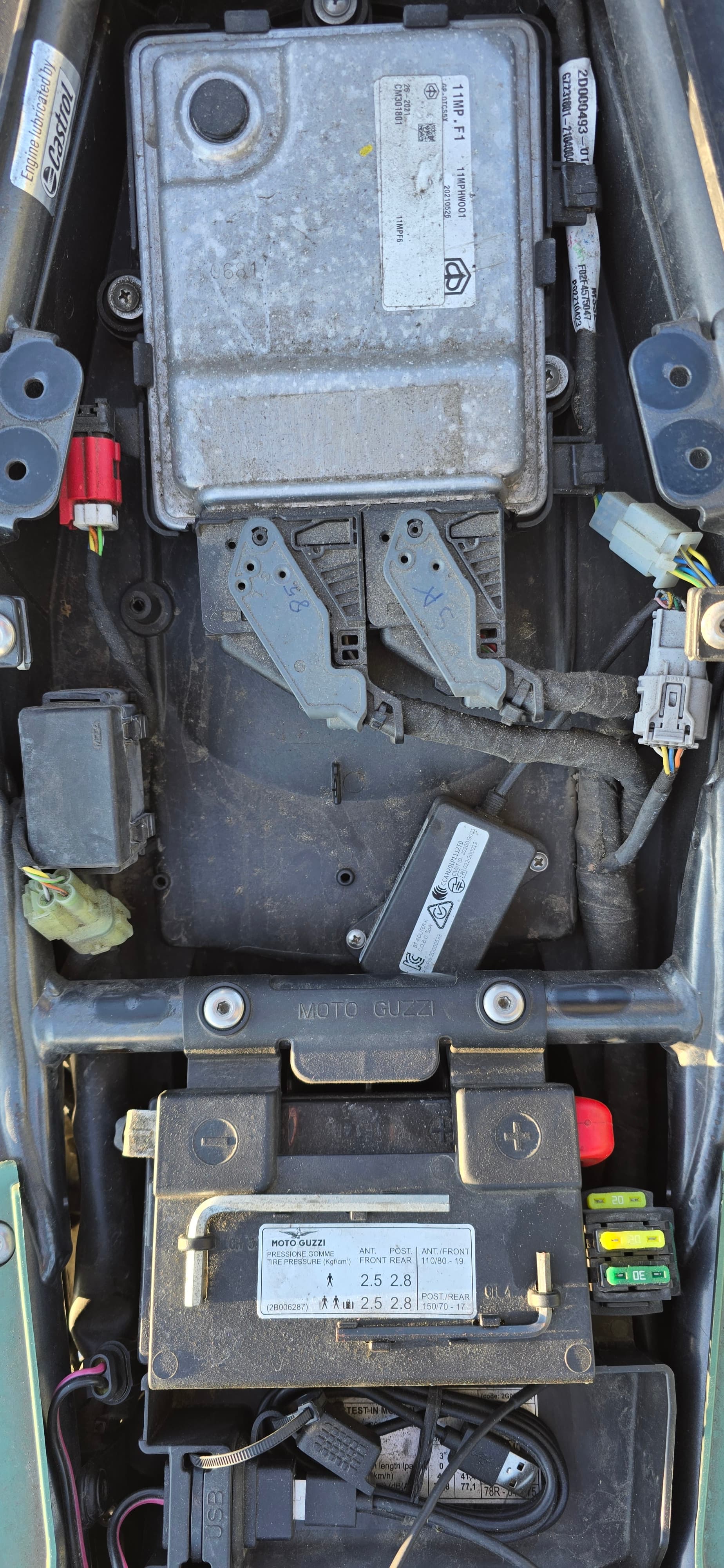

So, I ordered the MIA and fitting kit from the dealer. The MIA comes with no instructions, they are with the fitting kit.
The fitting kit consists of a badly printed set of instructions and 2 screws.
So save some pennies and don’t bother with it.
To fit, seats off, locate the appropriate 8 pin block which is supposed to be by the fuse boxes but mine was down the back of the side panel.
Remove the blanking plug, insert the MIA plug, job done.
The two screws are to hold it in place but require you to drill 2 x 3mm holes somewhere that I couldn’t figure out from the instructions.

not sure why he didnt use the hole in the centre there below the small plastic standoff/post, which seems made for it and the hole to the left
That’s a very good question.
On the Stelvio instructions it said drill two 3mm holes for the screws
