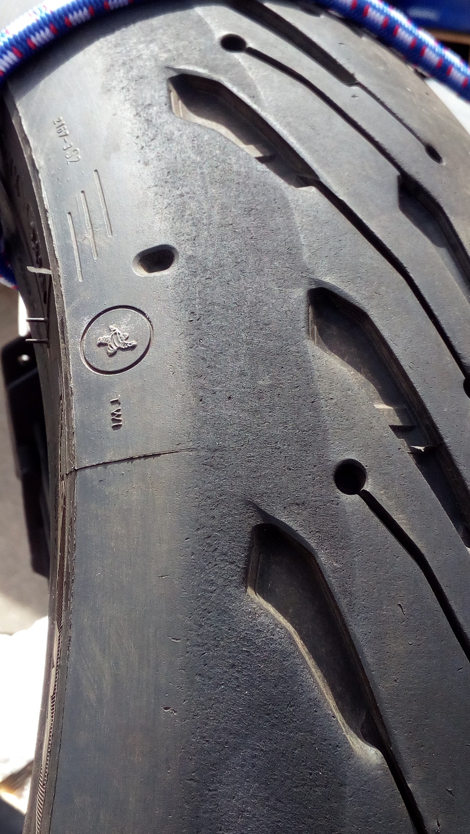

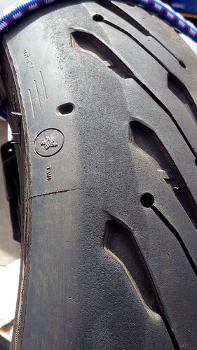

So after a period of time I have contacted Michelin and they suggested taking the tyre to one of the tyre shops that I use and get returned as faulty; the upshot of this was that they replied back to me and said it was “user error” [the tyre had not left the deport]. To be honest I am not too worried now baout getting a refund - but I do feel the tyre is faulty, so I contacted Michelin again via their web site contact email and explained the situation sent a couple of photos and they said could I take the tyre back to the tyre shop and they would (Michelin) collect it.
as a note my son has a PR5 on his BMW and it does not look like this [see attachment]
trying again with attachment - hurrah

And, what are we looking at? Specifically (Yes, a tyre … :smiley: )
I have PR5 on my BMW, but it’s a sport bike. (150+hp). Brilliant tyre and mine look like the one in the picture. It’s just the dual compound .

Interesting that you too have the same compound difference; my son’s BMW 1200 Adventure does not show same banding and he is well happy with them, you can’t really see the stepped edge between compounds in this picture; but you can feel [stationary] and see it.
My son’s tyres warm up as you would expect, rear quicker than front
I have seen the PR5 fitted to many different bikes now but not on any Moto Guzzi’s yet so unable to gauge.
On my tyres I can’t feel the difference , there’s no ridge, but you can see the difference. It might be that the pressures need tweaking for your bike. A ridge similar to the picture has happened to me in the past (not with Michelin) when I’ve done a lot of touring, ie the bike has been upright most the time. You can also get “feathering” which is not a tyre fault.

Banding, OK.

I have just recently put a Road 5 on the front with a PR4 rear [spare tyre - another story], but chatting with tyre shop who had lost my PR4 front i had originally ordered said that the Road 5 rear had been improved and was not the same as when first released. The actual look of the tyre is different when brand new - new one you can see the compound differences across tyre.
