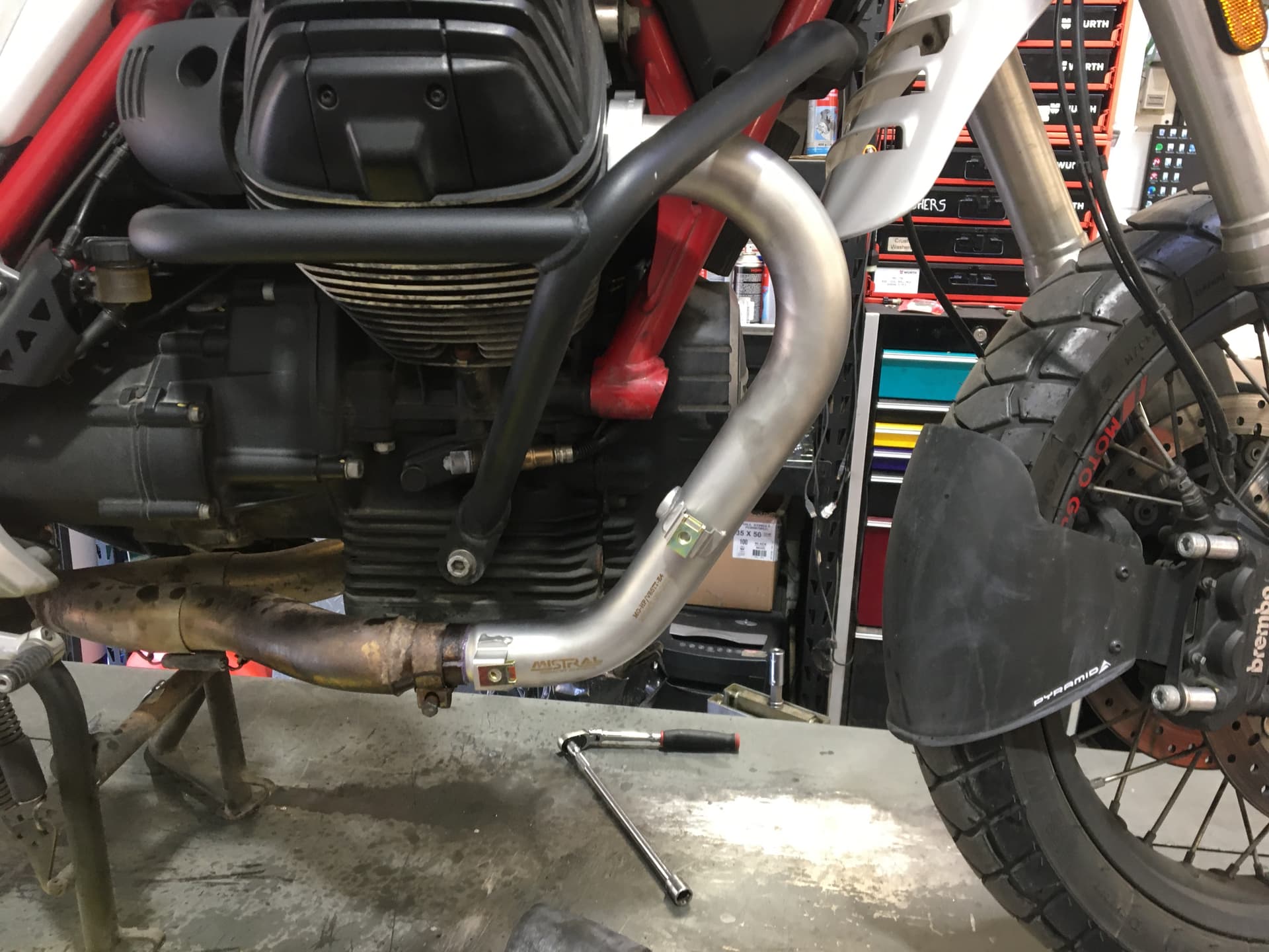

The first problem was the confusing ordering system, where one advert showed several photos of the item which all showed an item with different details. This lead to me receiving a unit that was different to the item I thought I had ordered. I returned it and got a refund.
I ordered again, ensuring that I was going to receive the one I ordered. It arrived and appeared to be very nicely made.
When it came to fitting the parts, two of the joints were very sloppy and would have been difficult to seal. I solved that problem by making two cylindrical packing pieces, but when installing the Y piece with the mounting bracket on it, it would not line up with the mounting bracket on the bike, even when all the joints were pushed together far beyond where they were supposed to go. That system has now been removed and returned.

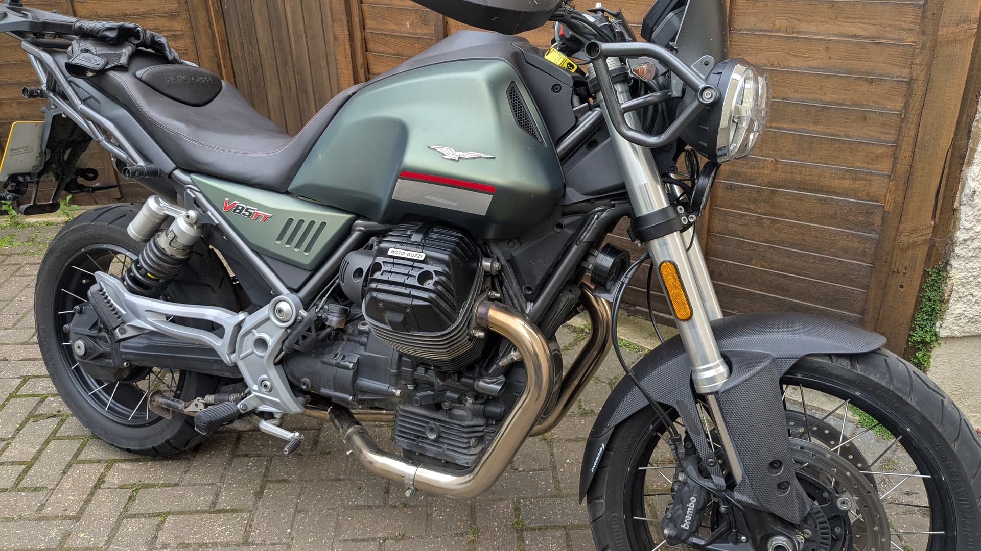

Just polished and fitted a chinese stainless 2 into 1 exhaust
With new (cheap) exhaust gaskets and (expensive) graphite pipe seals exhaust Pipe seals 44mm OD 38mm ID it fit together firmly with enough movement in each joint to get the pipe ends flat to the head and the support bracket in the right place. I used spacers & washers each side of the support bracket on an m8 allen screw. No leakage, started well with a deeper tone but no strange noises.
Have done 900 miles since installation and it is running smoother at low revs (can hold 1900 rpm in gear and pulls smoothly from 2000) and seems to have more midrange 2500-4000 and smoother through 4500 to 7000. I seem to be holding higher gears than i expected. I am very pleased.
