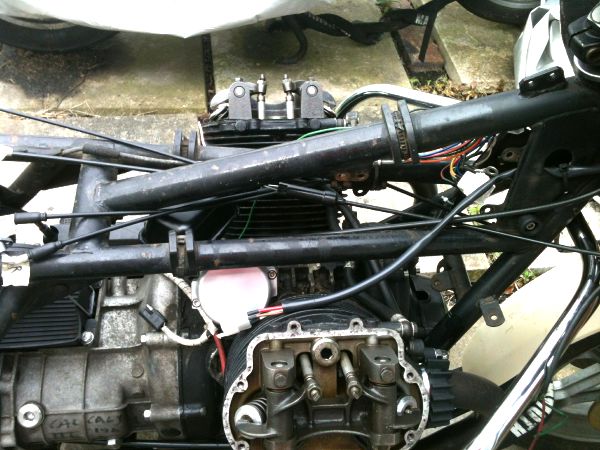

Frame top tubes fuel tank rubber buffers…

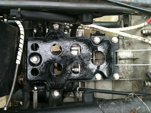

Metal battery base…

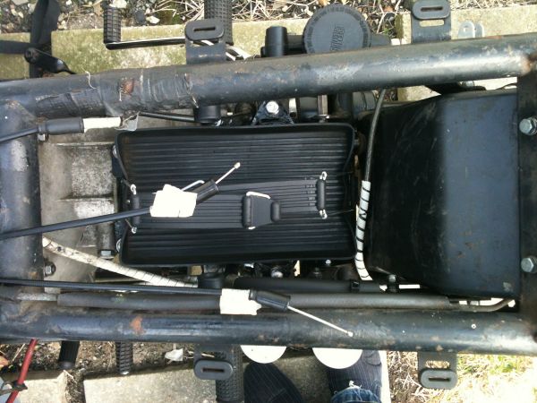

Battery rubber tray and securing strap…

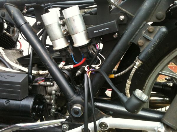

Left side panel, front to back - ignition coils, regulator, linked brake lines manifold block…

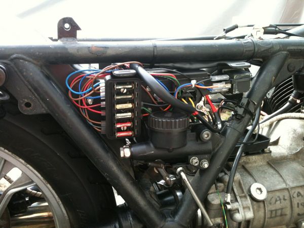

Right sidepanel - left to right - fusebox, rear brake master cylinder, indicator flasher - rectifier is behind this and between m/c and battery…

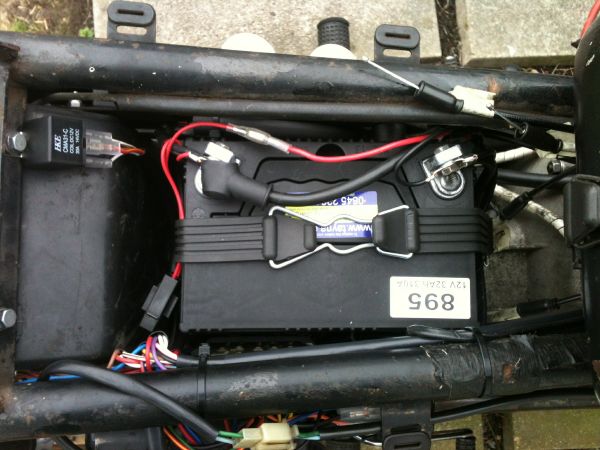

Battery in situ with strap… (starter relay at top left, not original position)…
