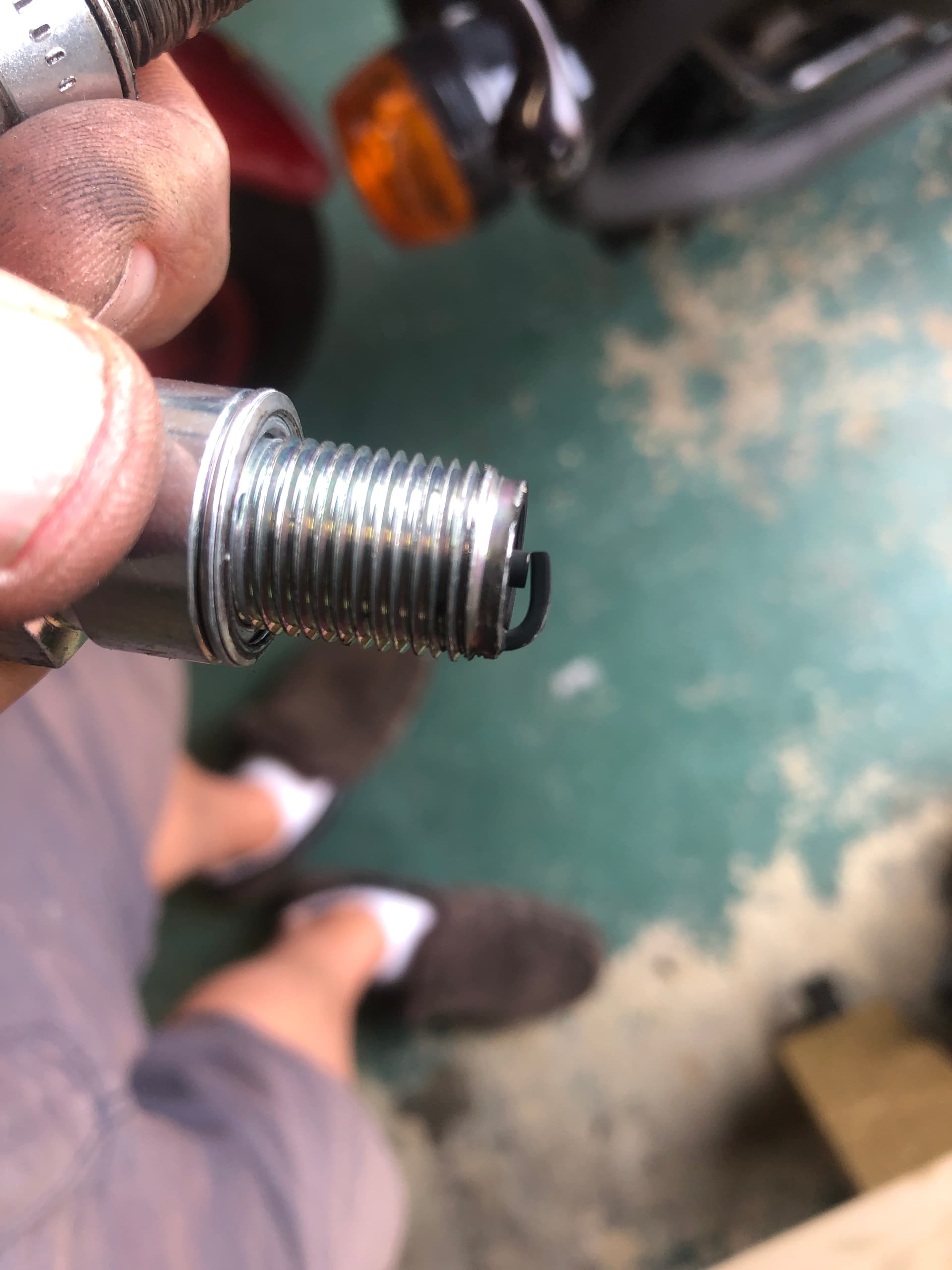

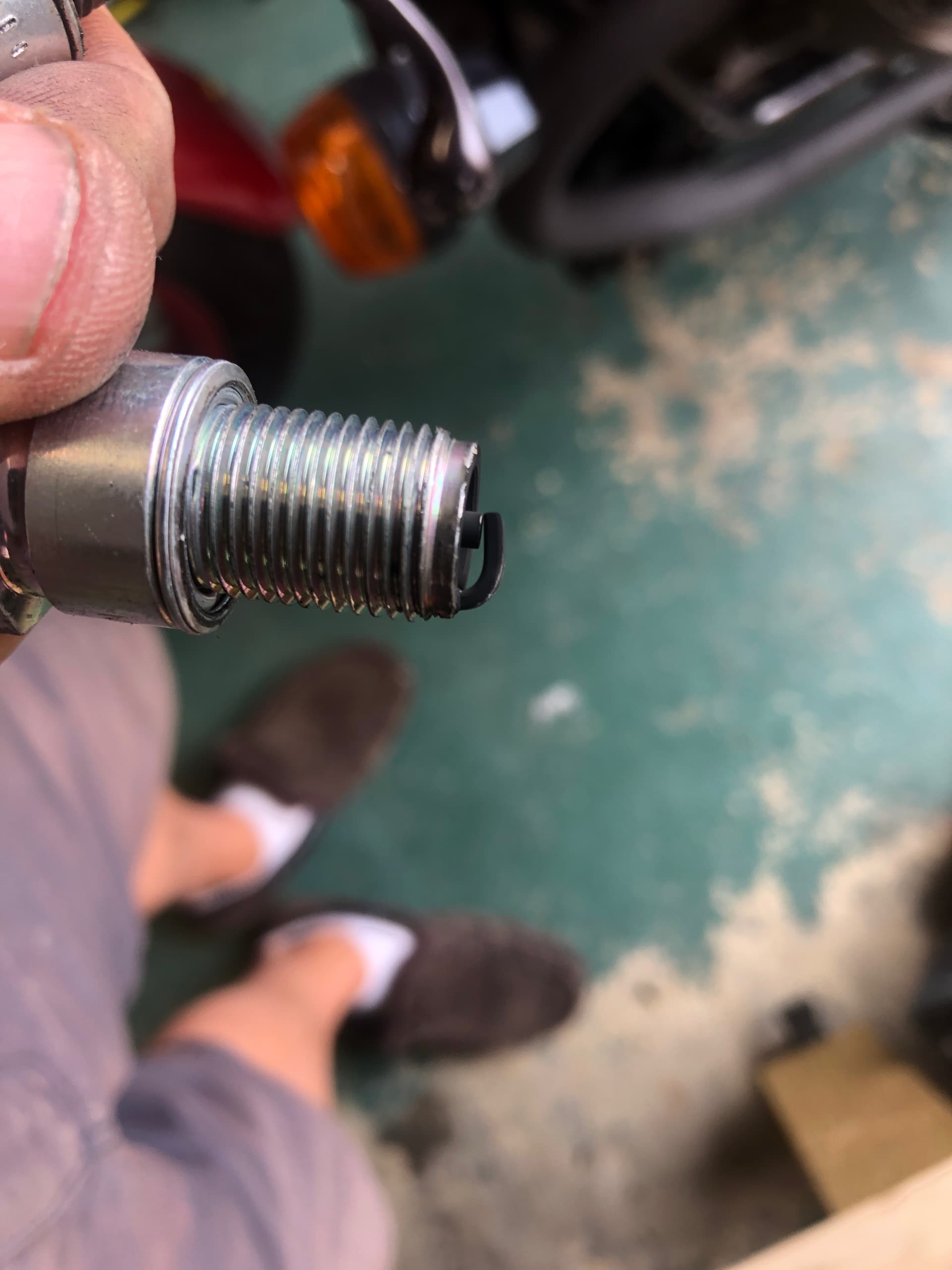

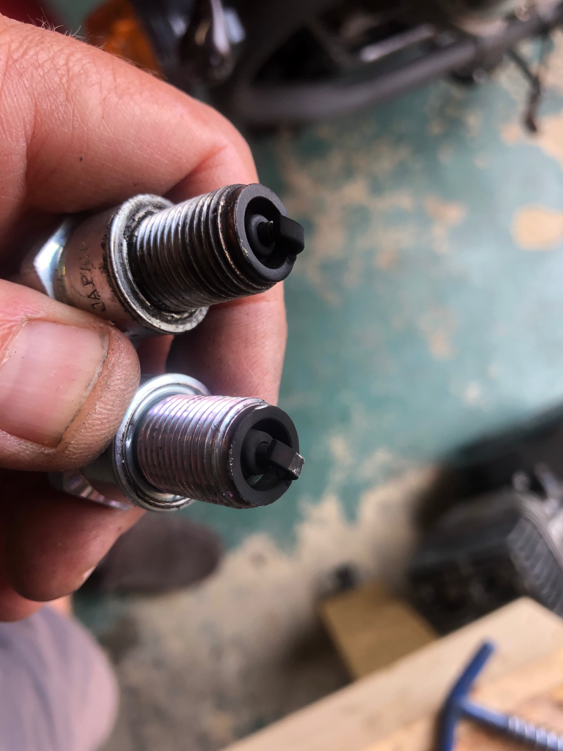

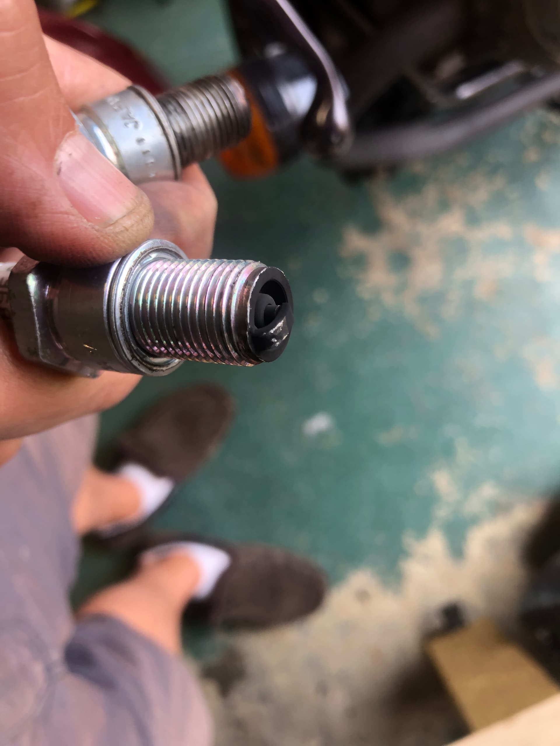

Now the troubling bit. I checked the plugs again and they were both black and one of them had the ground electrode bent over and touching the centre electrode an there were small marks on the top of the ground electrode where something had been hitting it. Is the compression that high to limit the clearance?
I’m guessing this can only be piston? Does the MK1 use standard length plugs and not specially shortened ones……really puzzled.

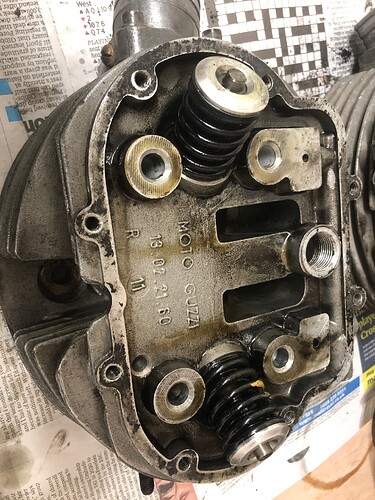

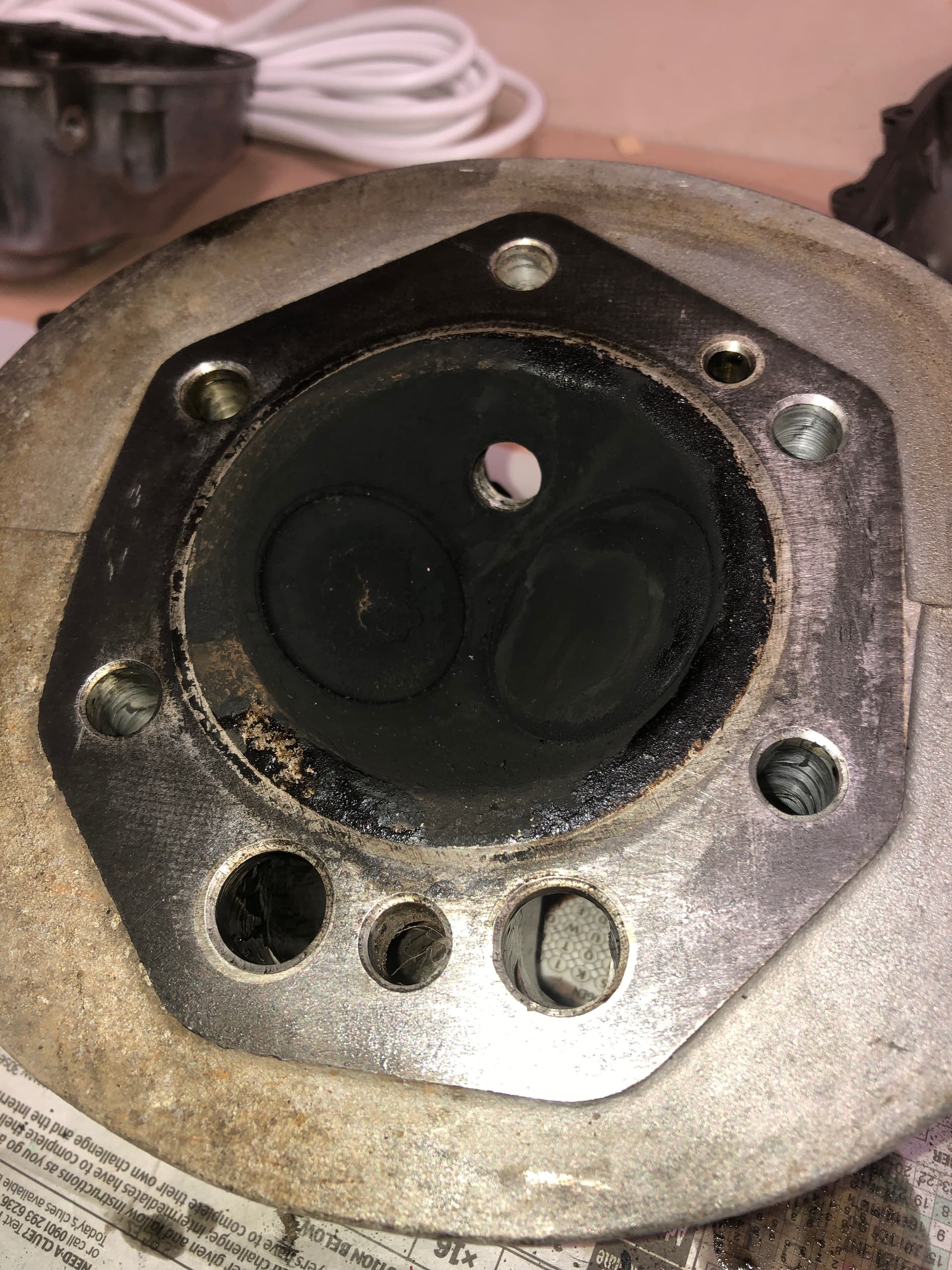

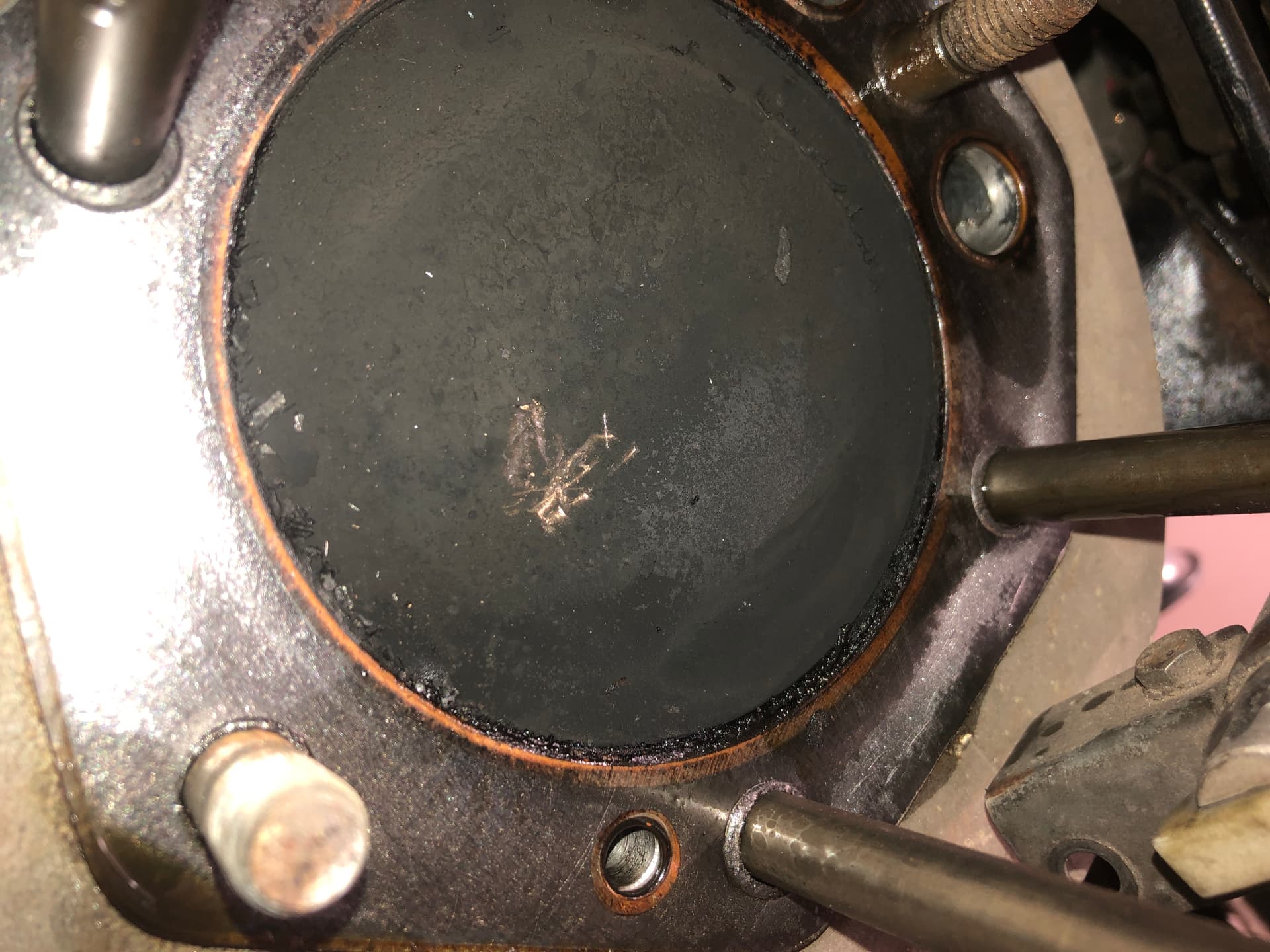

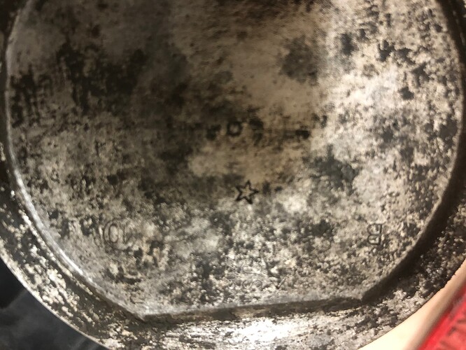

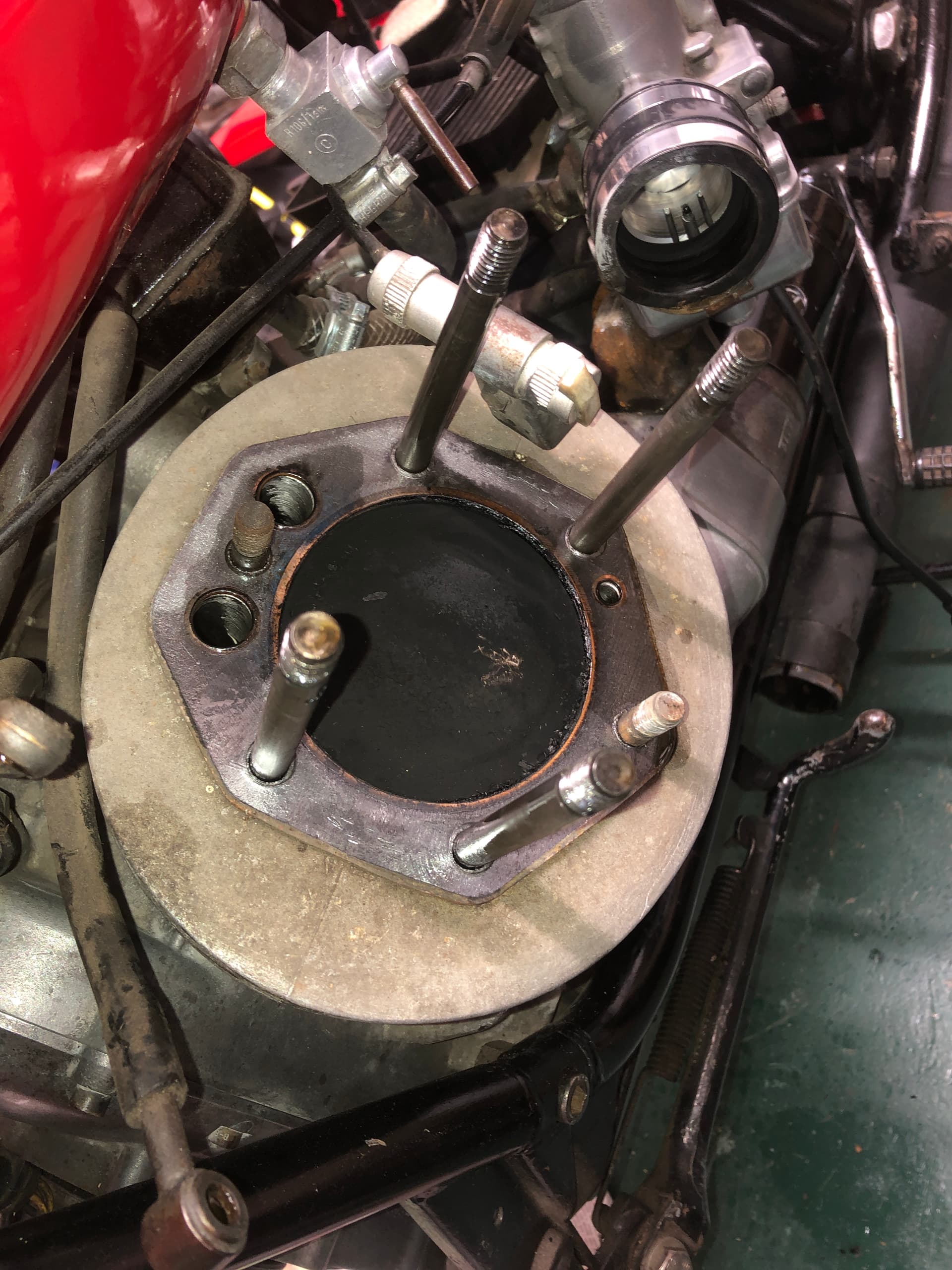

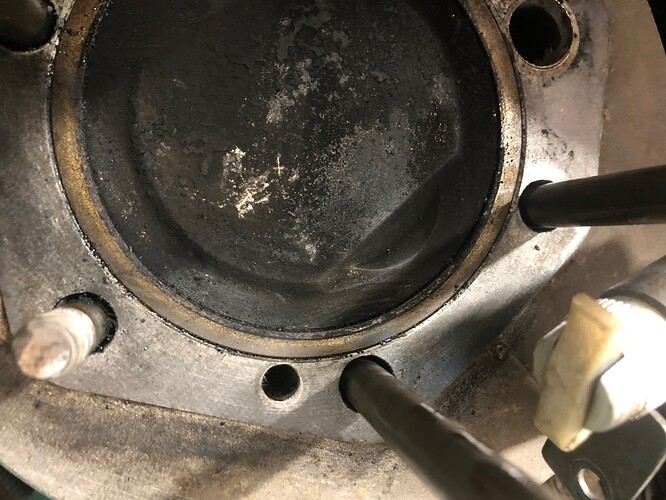

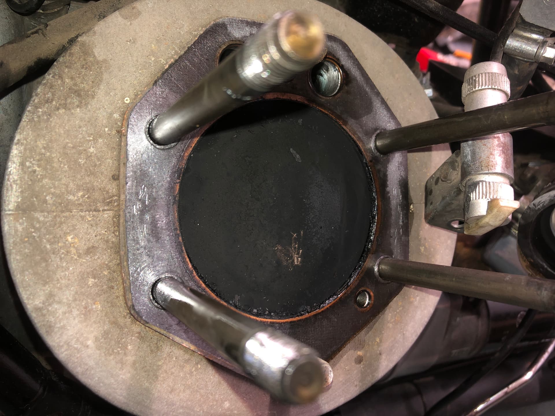

Well an interesting update. I removed the left hand head today and all looks good apart from being very sooty with the rich running. There are some definite light scratches on the piston top where it looks like it’s been hitting the plug.
More interestingly, the bore measures at 90mm and has a relatively flat top piston compared to standard, which means it’s at least a 950 conversion.
Question is, with this conversion (maybe by Raceco), do I need a shorter or different plug. I’ve placed a call with Gutsibits who are phoning me back.

On the barrel and piston they look like Spada barrels. Do they have steel liners?
Did the bike come from the States because they had a Le Mans which had the 950 Spada barrels because of environment laws
Agreed they look like Spada and American Le Mans CX100 barrels/pistons, these are 88mm bore - 950cc - the OP measured them at 90mm (possibly innacurately)
Russell

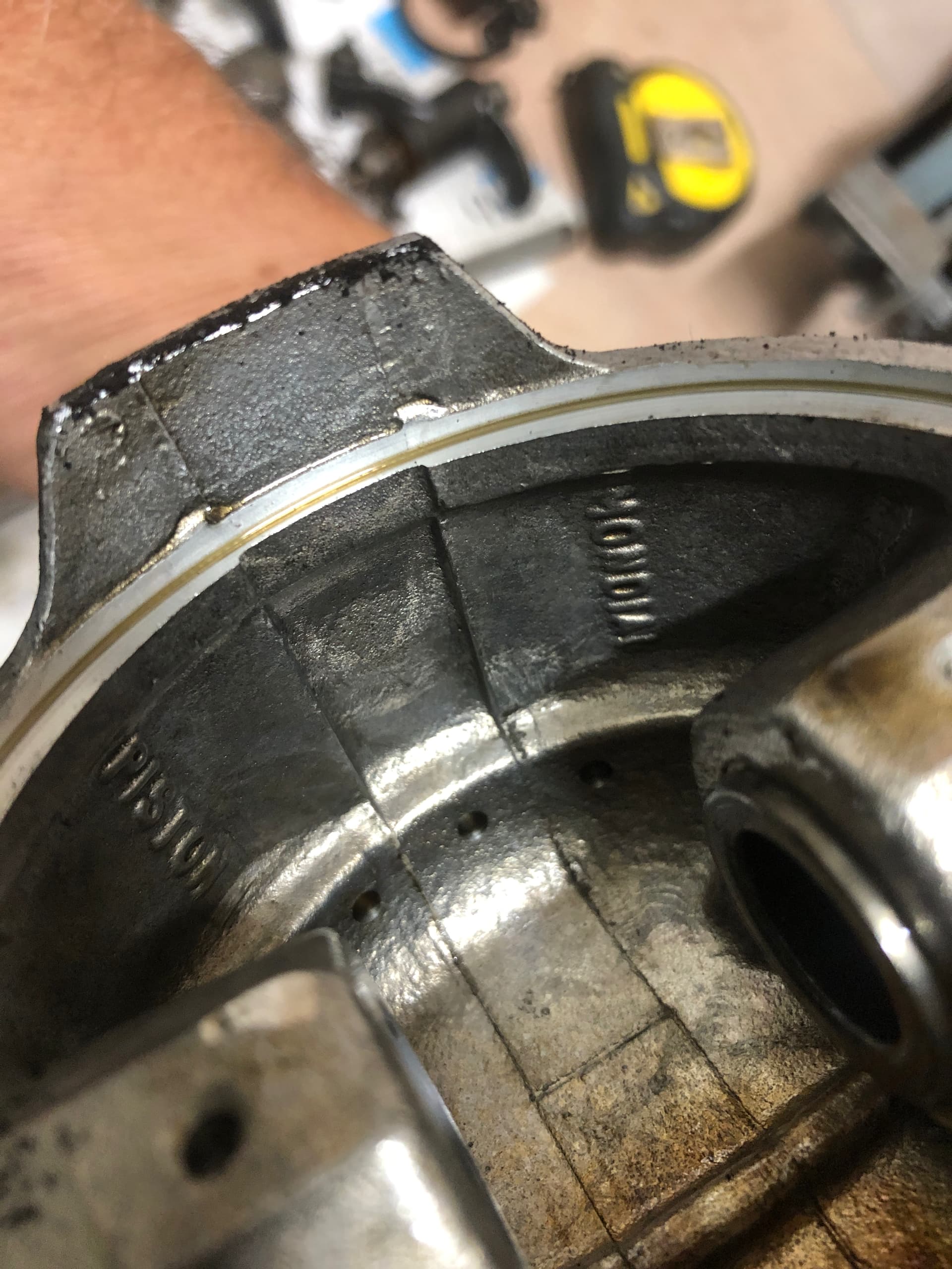

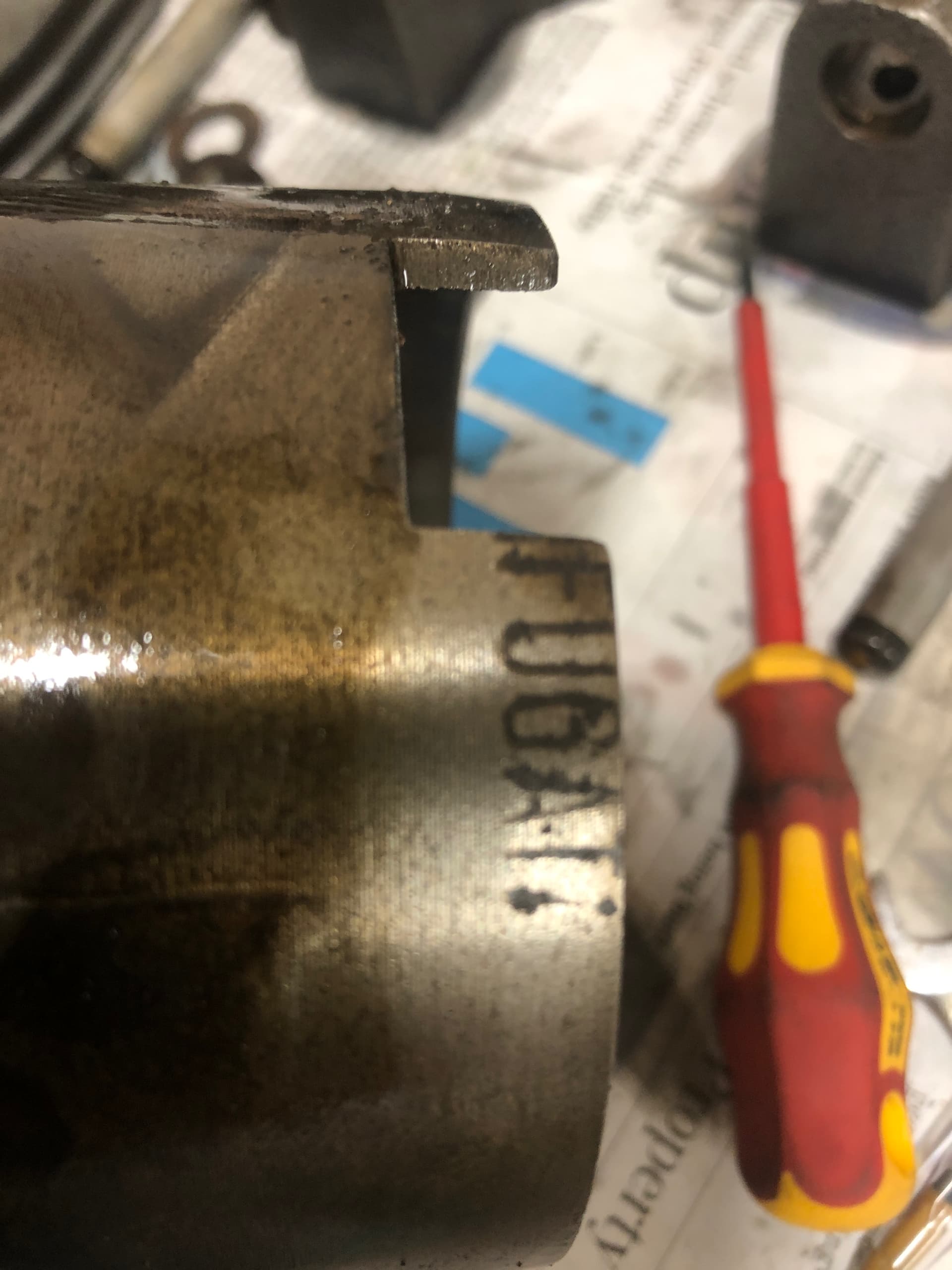

Have a good look around the barrels. I do believe that the replacement Gillardoni barrels have the makers name and capacity cast in between the fins somewhere lower down.
The plug thread looks very short - run a plug in and see if it protrudes

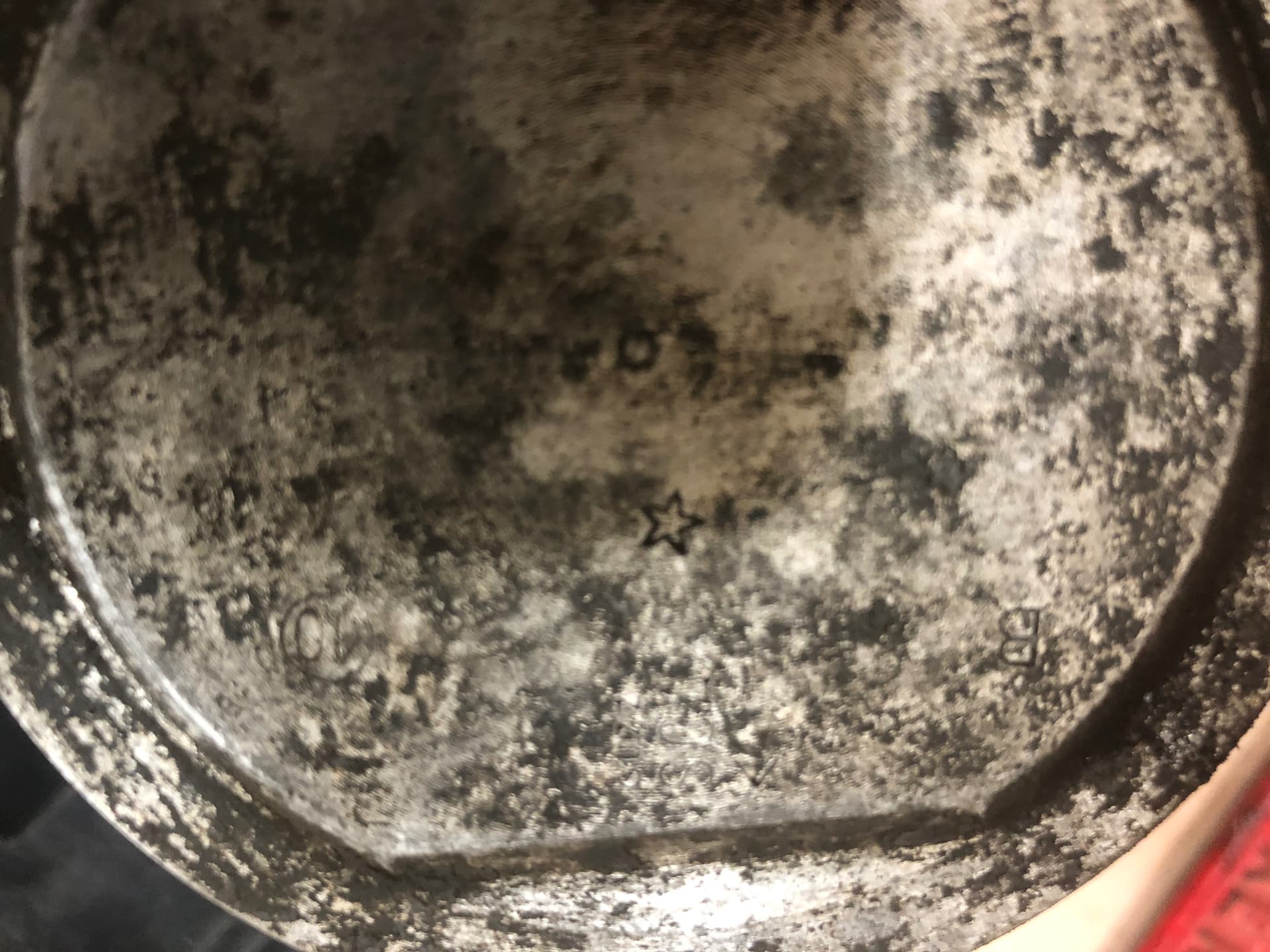

The only markings on the barrel is this FUGAT or FUGATI. It is reading as you say, more like 88mm than 90mm.

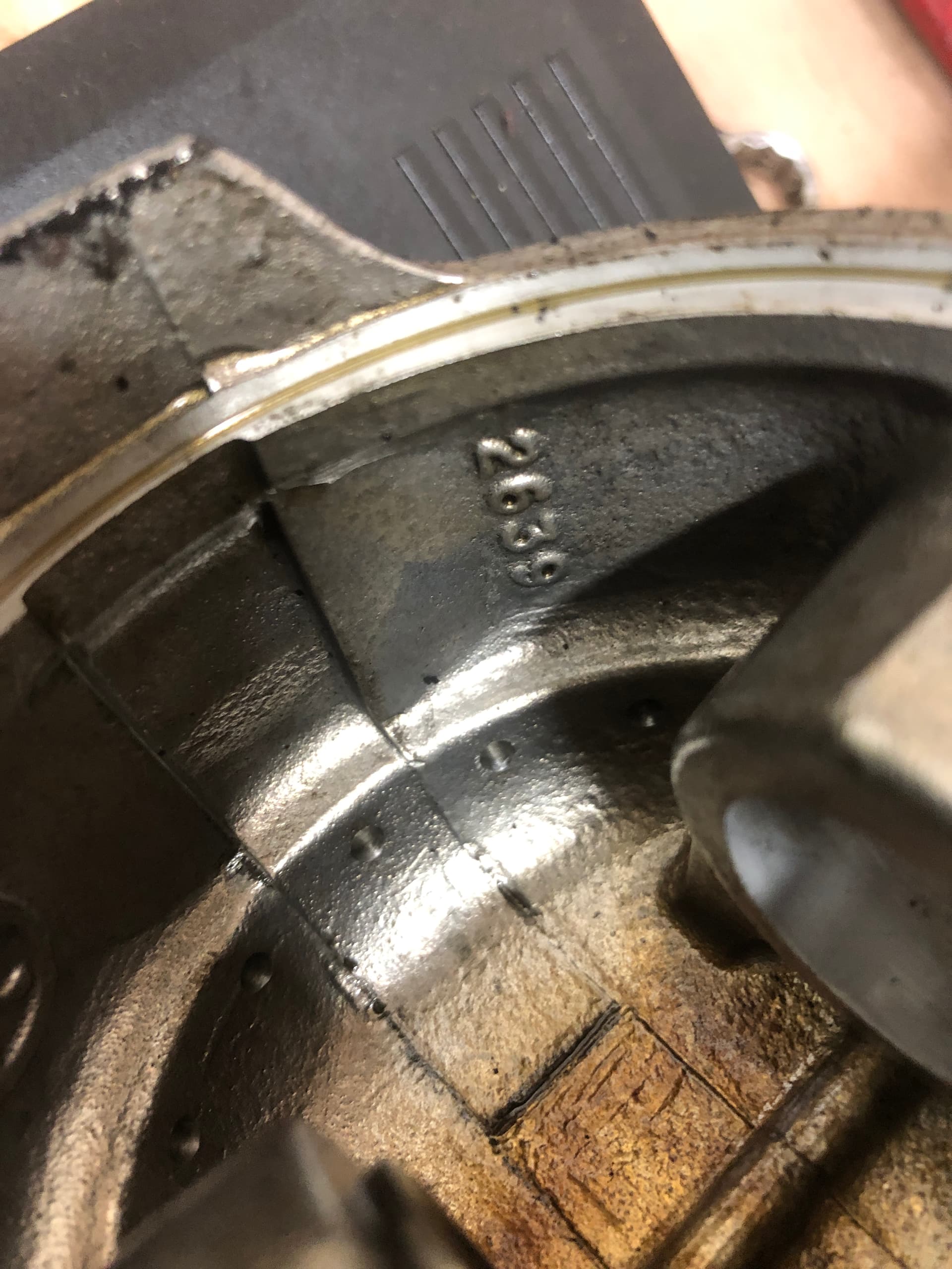

The piston is Mondial 2639 and has a star, a B and 10.

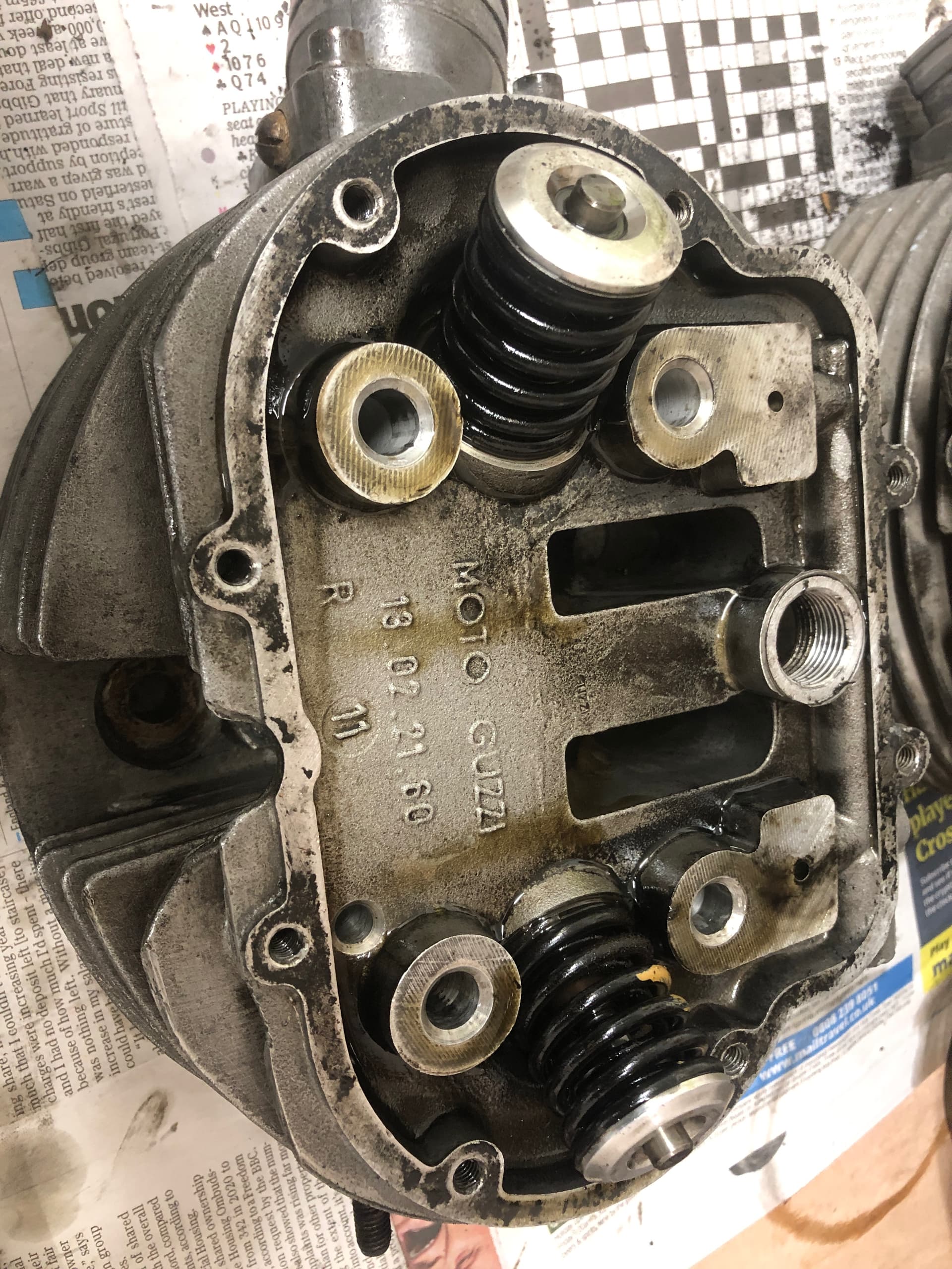

The valves are Le Mans spec at 44mm and 37mm.

I still can’t see how the piston would hit as there is virtually zero piston slap and no vertical movement in the connecting rod…..very strange.
Is there any chance that your spark plugs are the projected nose/tip type? I know that some older Brit bikes have problems in this area.

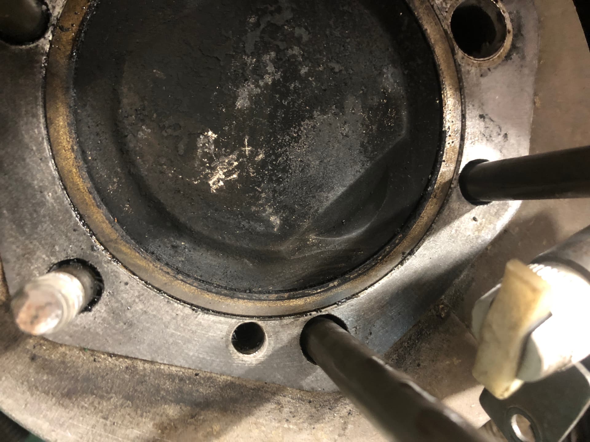

With the heads off, it’s really hard to see how the pistons can be touch the plugs as there appears to be quite a large gap between the two. I’m scratching my head now as I was not making it up, and there was a definite scratching on the top of the piston in the correct location and the electrode was bent over.
The plugs are standard long reach and do not protrude much into the combustion chamber. Going to take the heads over to the local engineering shop (T&L Engineering in Bedford are great for older engines) and get them to clean them up and discuss what could be causing it.

Could it be where a previous owner has inserted a screwdriver through the sparkplug hole to gauge TDC?
Best wishes Chris
Thanks Chris and you’re right it may be that, but still troubled by the bending of the electrode on the plug.
I’ll keep looking of answers and report back :+1:
Jamie
If you look at the scratches on the piston crown they are all similar and too thin to be the plug electrode, also they are at random rotation to each other. If they were from the electrode they would be all in the same place, not be randomly rotated and would be wider. I think you have screwdriver marks on the piston, and the bent electrode is a red herring, possibly bent by the same careless previous owner! I would be very surprised if the two were linked from the evidence of the photographs.
Best wishes Chris
Definitely looks like screwdriver marks, too random to be contact with the electrode - I’ve inserted one to check the flywheel TDC mark is correct in the past. The plug may have been knocked/dropped and inserted without havingthe gap checked.
