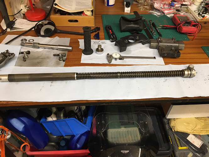

Hi,
Just taken my 1994 Strada fork legs off to replace the weeping oil seals and to check on the dampers and the springs. I think that they are probably the same as the Spada 1000 forks as mentioned by Lemon and Guest some years ago but I am not sure and would appreciate confirmation or otherwise, can anyone help - please see photo?
I want to remove the springs to check their length to see if they need renewing so obviously I need to remove the dampers or the adjustment end sub assy, somehow.
Thanks,
Charles
Yes, they look exactly the same as the 40mm LeMans 5 bitubo fork.
Simply pull the springs down away from the fork top nut and you will find the lock nut and flats on the damper rod described above, then unscrew the top nut, easy really :slightly_smiling_face:
Thanks Keef, much appreciated.
Charles
